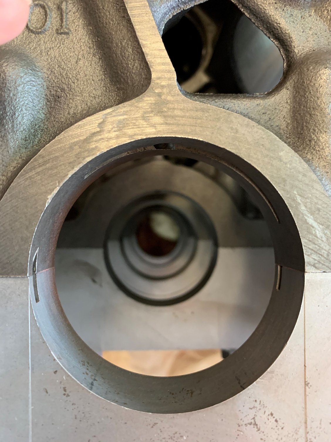

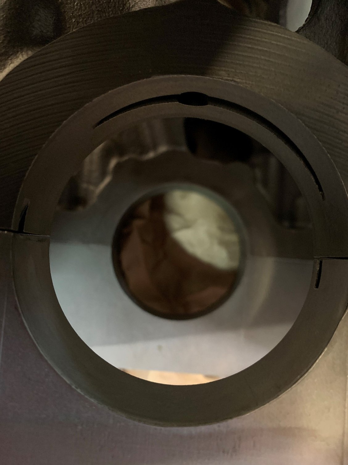

Bought the block from a reputable mechanic, had it cleaned, bored etc. I do not believe I paid to have the mains spec'd, but I think my caps got swapped or the core shifted. What have you guys seen in the gen III iron blocks? The caps are on right, 2-4 seem to be tighter on the cap, then the block side. Also, my thrust cap is off. Anyone seen this or have a way to solve? I don't think the caps are off of it, the engine did smoke a few rods though.

Those don't even look like they cane from the same block.
You can try marking them and then swapping them around and see if they fit better some other way, but that doesn't look right at all.

Originally Posted by LS CHEVY II
I think you are right. Mixed bag of nuts, for what reason. Hope my machinist can get it right.
Wrong caps for that block. Basically useless.
It will cost more to make them fit than starting with another block. Take it back and see if he has the correct caps. If not demand a refund.
It will be $400 - $500 to line bore those caps to that block with out any other machine work.

Are the bolts torqued in the photos? Are you sure the caps are facing the right direction?

So here is what I think has happened. I bought it from a local repair shop, who apparently got it from a friend. I think he suspected something wasn't right, but did not know what exactly.
I took my block for clean and machine, not thinking the mains were an issue. The machine shop did exactly what I asked for, but didn't catch this. The shop did not mix up my mains, I am confident of that.
Not sure if mains were from another donor, but it actually appears these were cooked and warped. The engine was said to of smoked rod bearings, they likely ran the **** out of it knowing it was done. We think these are original, with a 75% likely hood. My machinist thinks he can swedge, peen, cut then hone it back to glory. I suspect that two of the caps will have dings, as mentioned prior.
I told them to get me arp studs, since we went this deep. Now I gotta find a gen 4 crank, to match everything else.
I am still under what it would of cost to buy a crate engine. Likely $1000 in block work alone.

Anyone ever see the caps warp like this? Wonder if they had to beat the crank out, and it amazing that the mains didn't seize and spin..The number 2 cap is the worst, its the one that wont fit flush.
I relearned a lesson. Always check and then have the block checked out prior to spending money on machine work.

I doubt that caps are warped, Most likely not the caps that came on the block as other have pointed out. I don't see any signs of heat and you'de probably break one before it wapred.

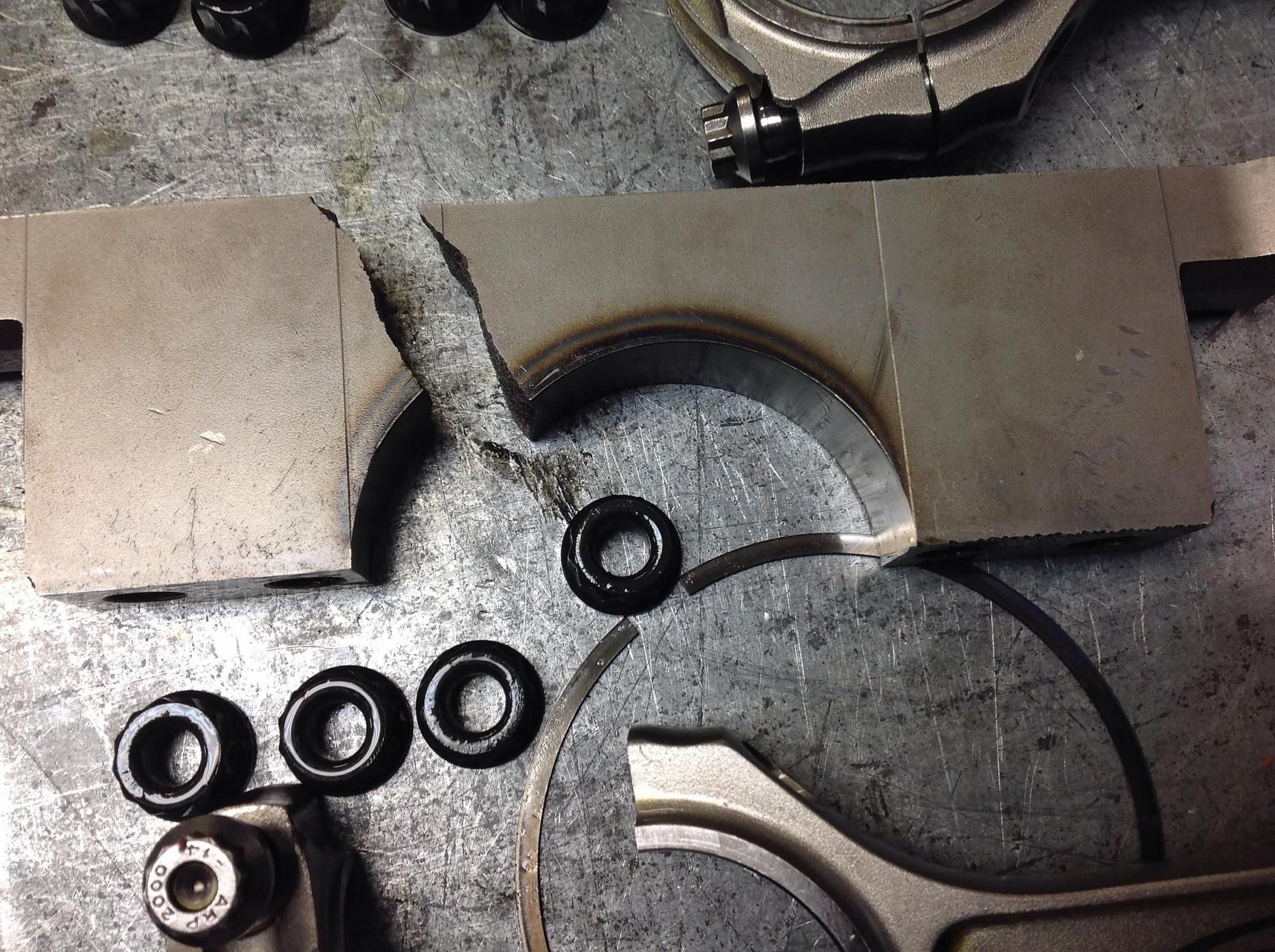

Here is the main cap from a motor I bought, It's getting repaired with billet mains.

Crazy pics on the thrust and broken cap. WOW
