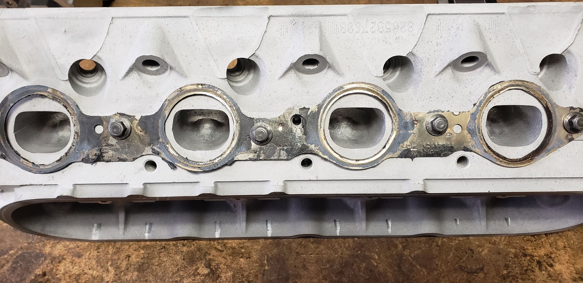

I am porting a set of 243 heads. Using a GM exhaust gasket to mark the area to "raise the roof." Why does it look like I need to open it up so much? What am I doing wrong?

The stock exhaust gasket is actually much larger than the stock exhaust manifold so double check that you don't raise the roof too much.
So what gasket is this guy using? Basically trying to do what's at 3:50. My gasket seems giant compared to his? Thanks

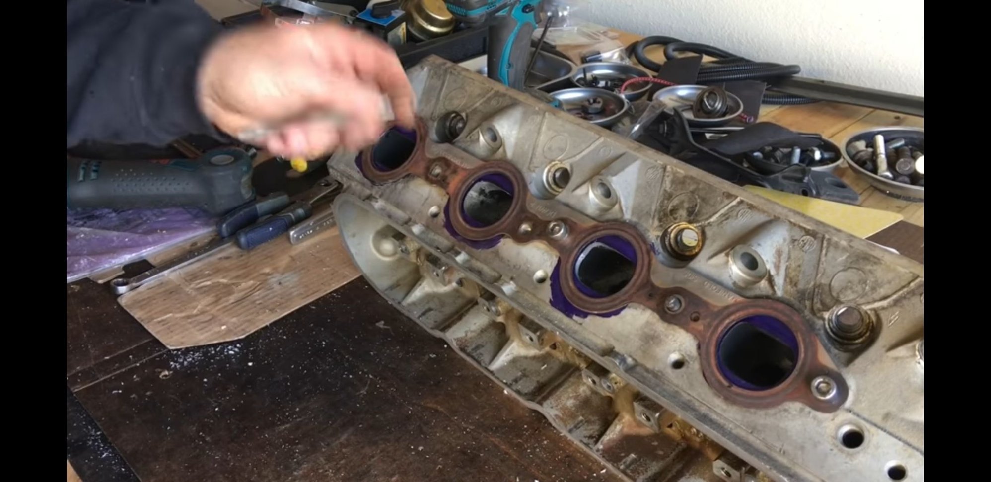

243 cylinder head that I raised the roof. This set of 243 heads will go on a C5 and should wake it up nicely. The pictures is not the best still it should show that I raised the roof and still left plenty of material.
https://youtu.be/JAeSqBU6OJI
I'm not sure, but I'm using the exhaust gaskets that came off my '01 Camaro.

Ok, I get the idiot award for the day. 4:20 answered it lol Like you said also...
