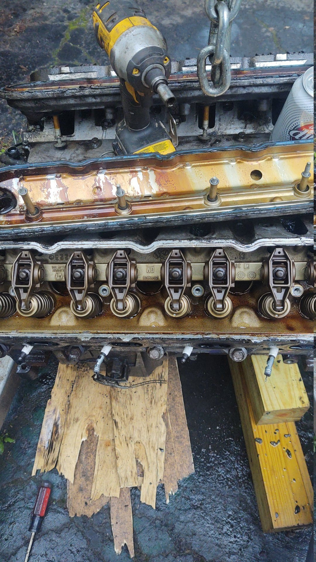

You found a LQ9 for a $100 that in itself is impressive. I dropped $1,100 for mine lol
Look for a camshaft that closes the intake valve early to build a higher dynamic compression. This will help with low end torque in a heaver vehicle. There are a lot of online camshaft calculators making it easy to calculate dynamic compression and overlap between different grinds.
