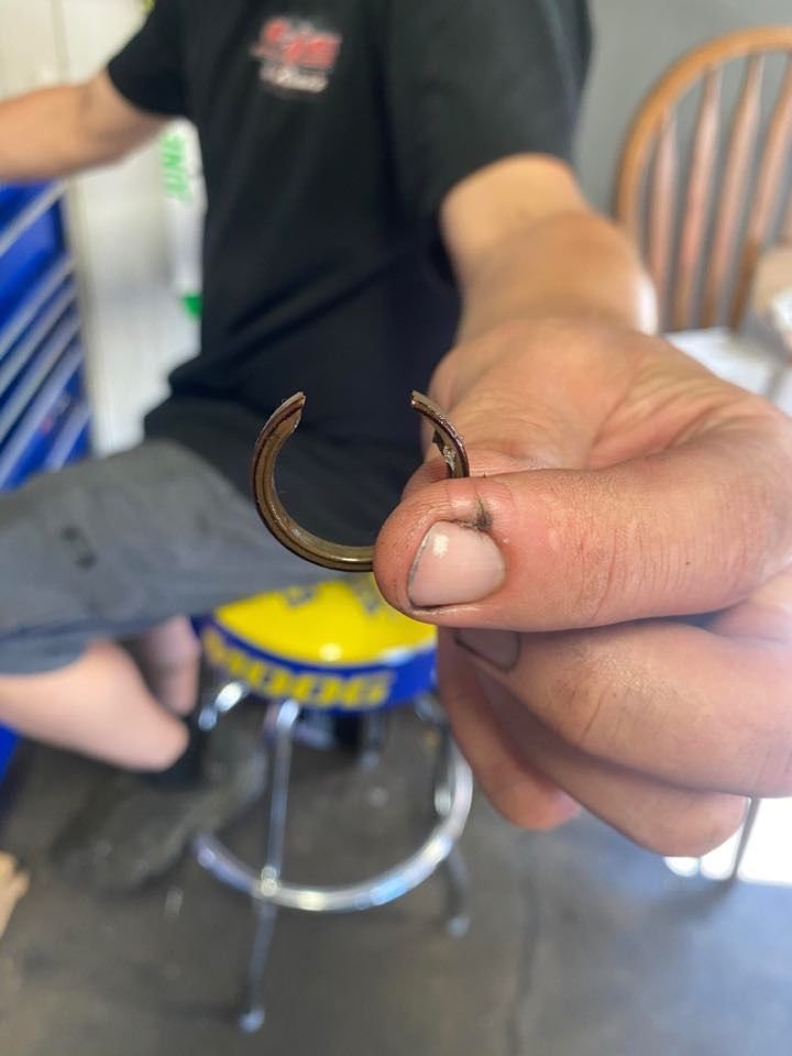

IDK.. You had the heads and chain replaced which means the oil pump was removed so probably nothing to do with sludge and everything to do with the installation of the pump..
I didn’t mean to say thick, I meant to say it appeared regular, without foreign fluids.

oil pump pick up tube o ring and/or cam shaft retainer plate seal.

x2 cam retainer plate.

I also feel that it has something to do with the cam/heads swap. O-ring on pickup tube,cam retainer plate, pump installation, etc.

Sorry
for the long respond, ended up being pick up tube O-ring
