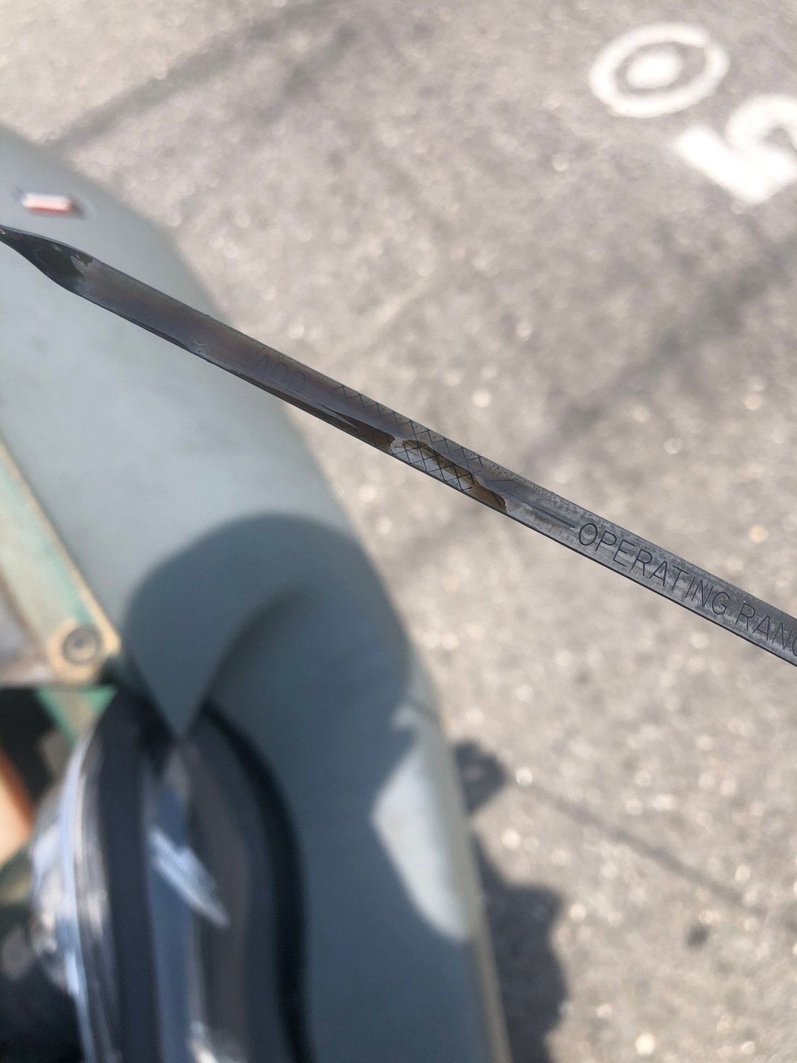

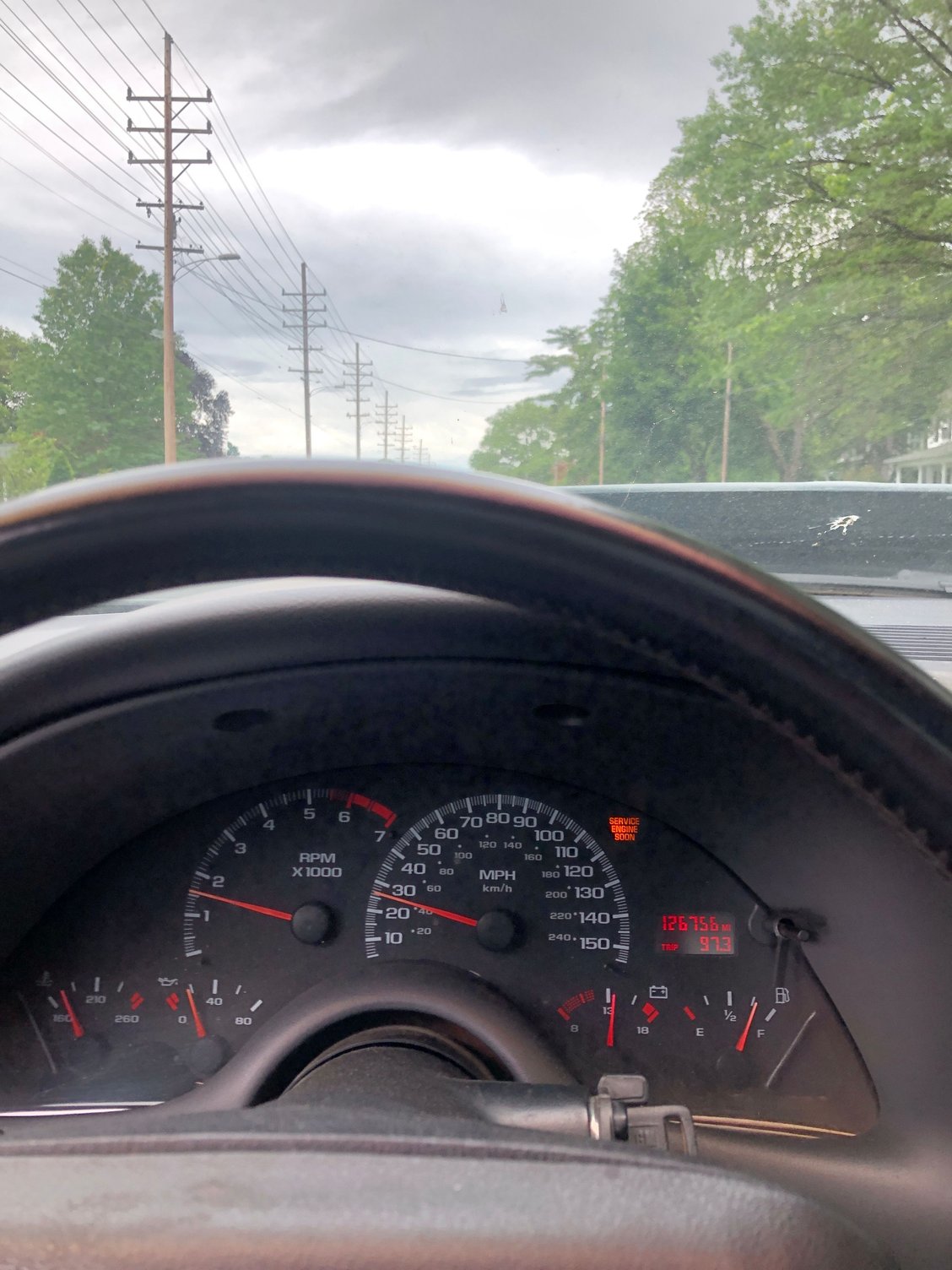

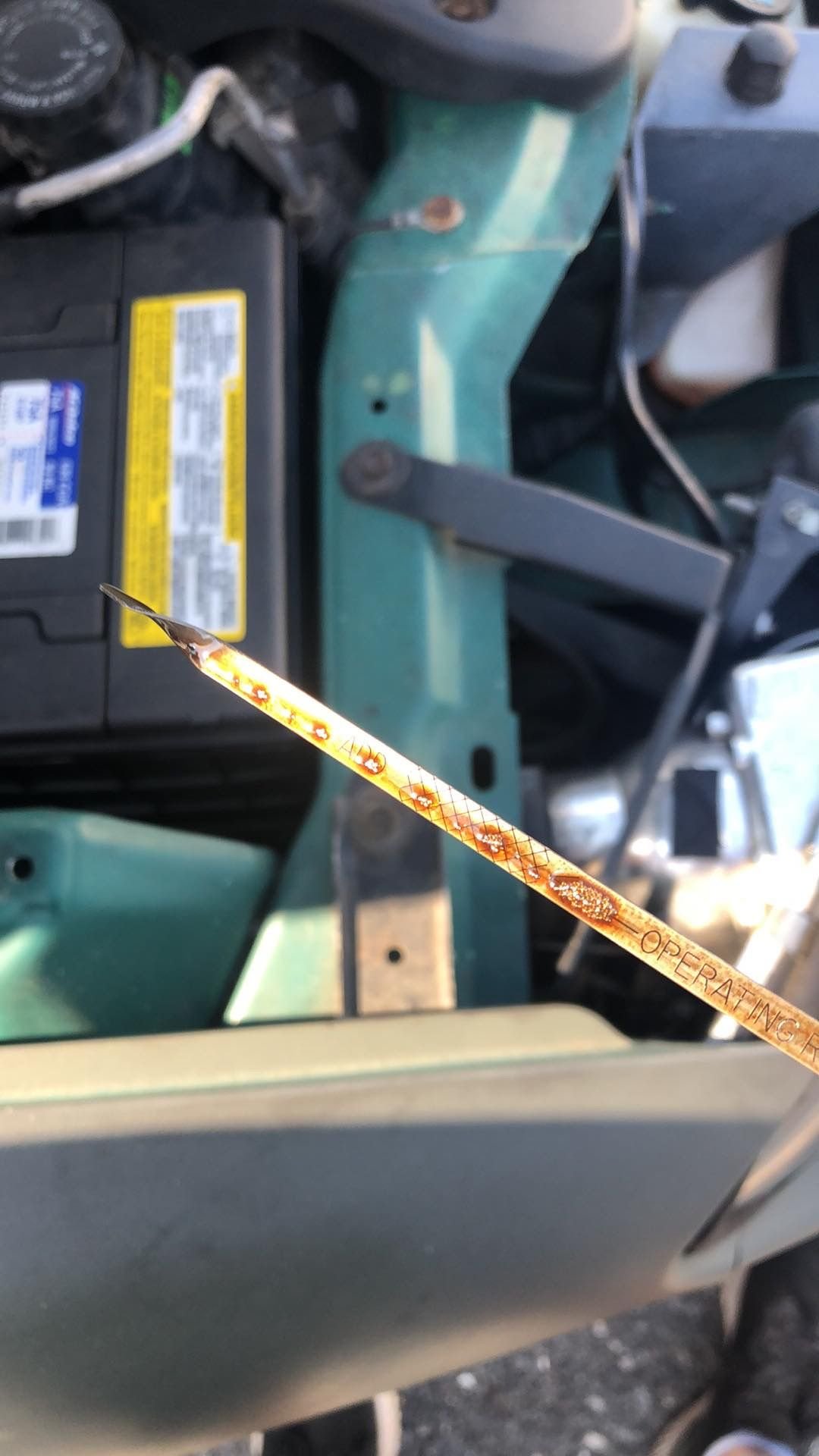

So I just did a 243 heads and ls2 timing chain swap back in March. I had the shop change the oil with castrol edge full synthetic 10-w30 at the same time and now my oil pressure seems really low. After 1000 miles it barely gets over 20 psi when the car is warmed up at any rpm. I was driving and everything was fine until the last 10 miles of my trip I heard lifter tick. I pulled off at my exit and it immediately went away. I dropped the car off at my work and checked the oil and it was foamy. I included a photo of it after the drive. I thought it was the crank slapping against the oil and the oil was somehow getting in the windage tray. I tried to drain a little bit and started it up and the oil
Oil pressure will stay like this at any rpm. While at operating temp.
After a long drive
After sitting for 10 hours
pressure was amazing. After 5 min it wouldn’t go past 30 psi and when I checked the oil on the dip stick it was foamy again. I don’t know whether it’s the oil being too high or not. It doesn’t smell like fuel and doesn’t look milky at all. I have the picture of the dipstick after sitting for 10 hour and after a long drive, with a video of the car “cold” showing the oil pressure.

You shouldn't check the oil on the dipstick with the engine running only after its sat for awhile. Your oil pressure is too low in my opinion to be driving the car and I would start with the cheapest part being the oil pressure sensor first. I'd be more worried about a leak, incorrect or worn parts or excessive clearance on the internals of the engine.

I was gonna try to use a mechanical gauge at my work soon, I haven't noticed the oil pressure being too low until yesterday. I checked the oil while it was running on to see the foaming building up and also 3-5 min after it ran and still saw foam. i dont knoow if itll be the sensor because the gauge works perfectly when the car first starts. https://www.youtube.com/watch?v=yb3N...ature=youtu.be

That oil isn't foamy, It's thin from heat and possibly fuel mixed in. Change the oil and see what happens.

Pressure comes up on the throttle so that's good but never a good idea to get onto a cold engine so wait for it to heat up first. Once things are heated up though it might as well be water running through it with 5w30 but it still shouldn't have that low of an oil pressure. Use a quality oil and filter when you go back in and hopefully your good to go!

I would think 30 psi or better on a hot idle is normal.

when I tried to drain a little bit out, it came thick. The oil doesn’t smell like fuel. I’m gonna drop the pan next week (because I don’t drive the car) and replace the pick up tube o-ring (which may be loose or not seated when I swapped the chain). Hopefully once I swap out the o-ring I’ll clean the pick up tube and change my seeping oil pan gasket.
