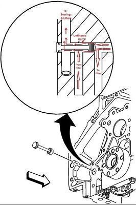

Can u actually cram the barbell in backwards? Didn’t think it was plausible but now I’m wondering.

Technically, I believe you can, never tried it but that I'm aware of the passage way is the same diameter all the way in and the barbell is the same diameter, so it could technically go in backwards.
Here's a couple of diagrams with the barbell and can give you a better idea of what's going on in that area. I'm not sure if it being in backwards would affect anything or not, or what it would do. Never ran across that one.
thanks for the diagrams, and the help. I didn’t think it was in backwards. But had to ask. This is frustrating no kiddin
