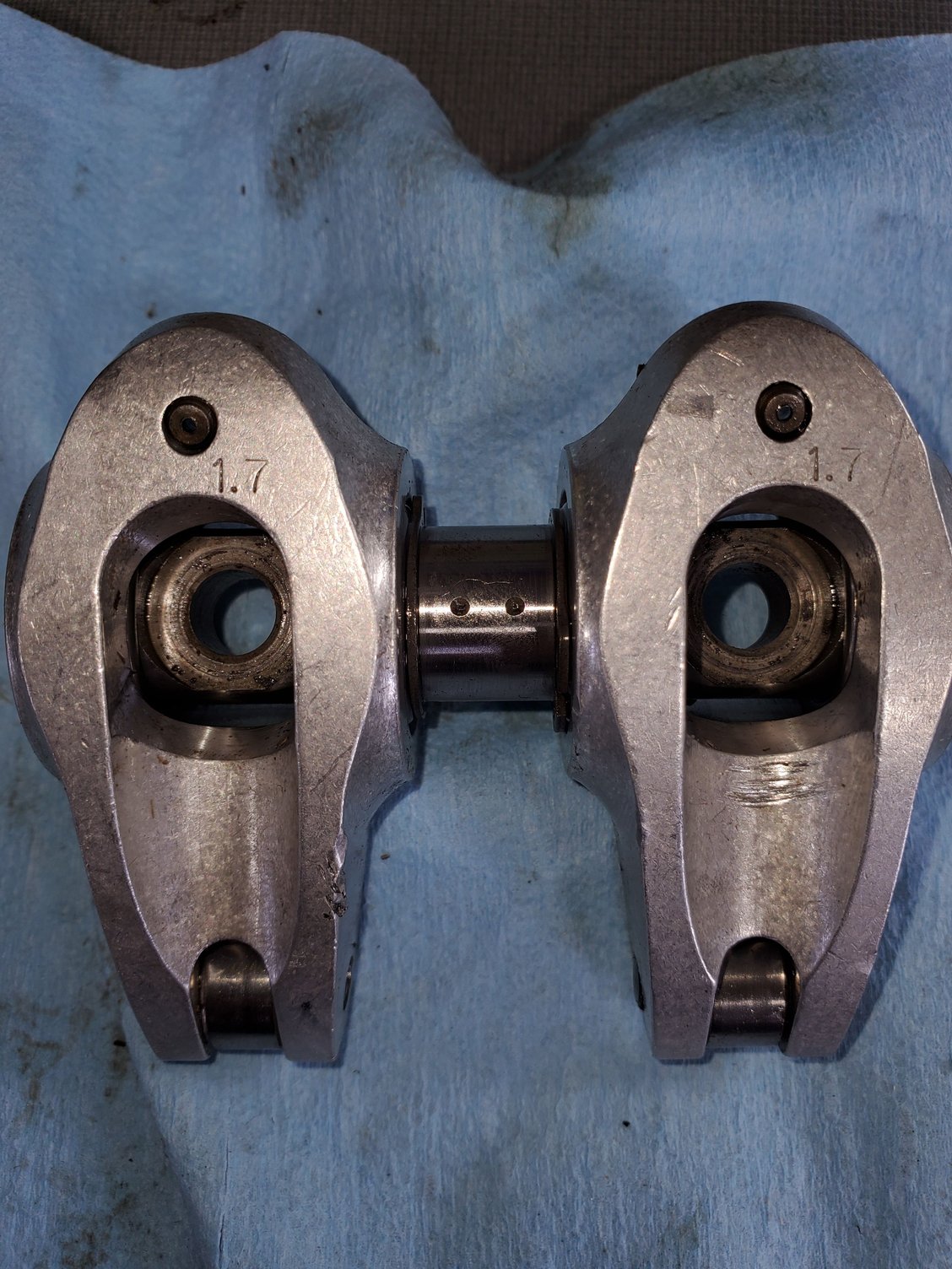

I bought a set of Yella Terra roller rockers from the used parts market place on here and the parts showed up with damage to one of the cups that the pushrod rides in. Is this repairable or could it be run the way it is? I don't feel comfortable running it the way it is so I stayed with my stockers for now with the trunnion upgrade. Pic below. Let me know what you think.

Both look damaged to me. Don't know if anyone can repair that, you'd have to add metal then reshape it, likely more expensive than just getting replacements.

Looks pretty destroyed to me. Don't think I'd run it.
First thing I'd do, before even worrying about that, is FIGURE OUT WHY it did that in the first place. On account of, if I didn't, the next thing I put there, whether stock YT or whatever, I'd be afraid the EXACT SAME THING would happen AGAIN.
That said, what caused it?

Those would need to go back to YT for rebuild or replacement. What version are they? Post up a pic of the top of the rockers please.

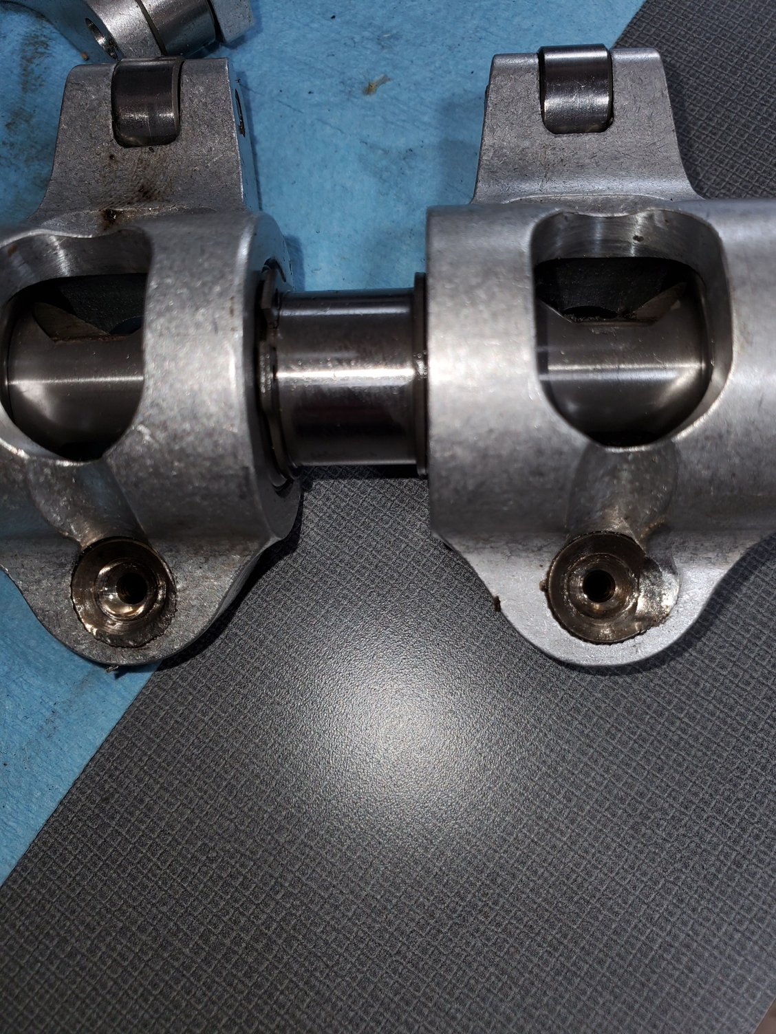

Here is a pic of the top of the rockers

Those look like they've had a hard life. I'd just move on to another set of rockers
So far from 2 pics I see worn/damaged ball cups for the push rods, dents scratches and general damage, pitted roller tips... It doesn't look like there's much there worth saving unless the others are in far better condition.

The others are better, but not by much. Chalk this one up to a lesson learned. I need to ask for more pics when buying used parts. Out of all of the parts bought on this site this is the only purchase that didn't pan out.

YT has an amazing customer service dept, and even though your not the original owner of them, they would likely still get you into a new set for a huge discount if they can’t rebuild the set you have. Worth a phone call.
