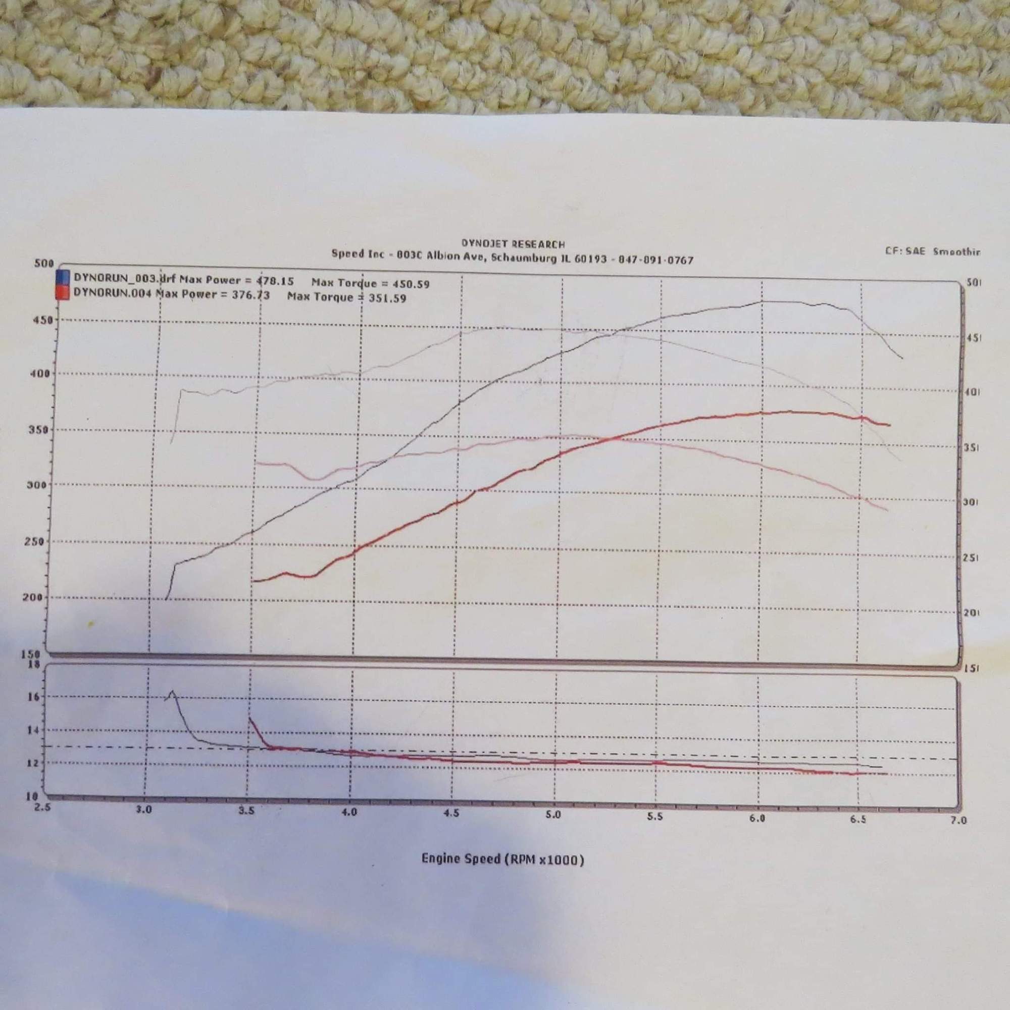

Joking aside here is my 224/224 cammed ls1 and budget 408 dyno from around 05/2006 time frame. If someone could overlay a dyno from an aggressive 346 or 6.0 making around the 478 my 408 made it would be interesting to compare the curves. This was a 3600 stalled converter stock gear.
