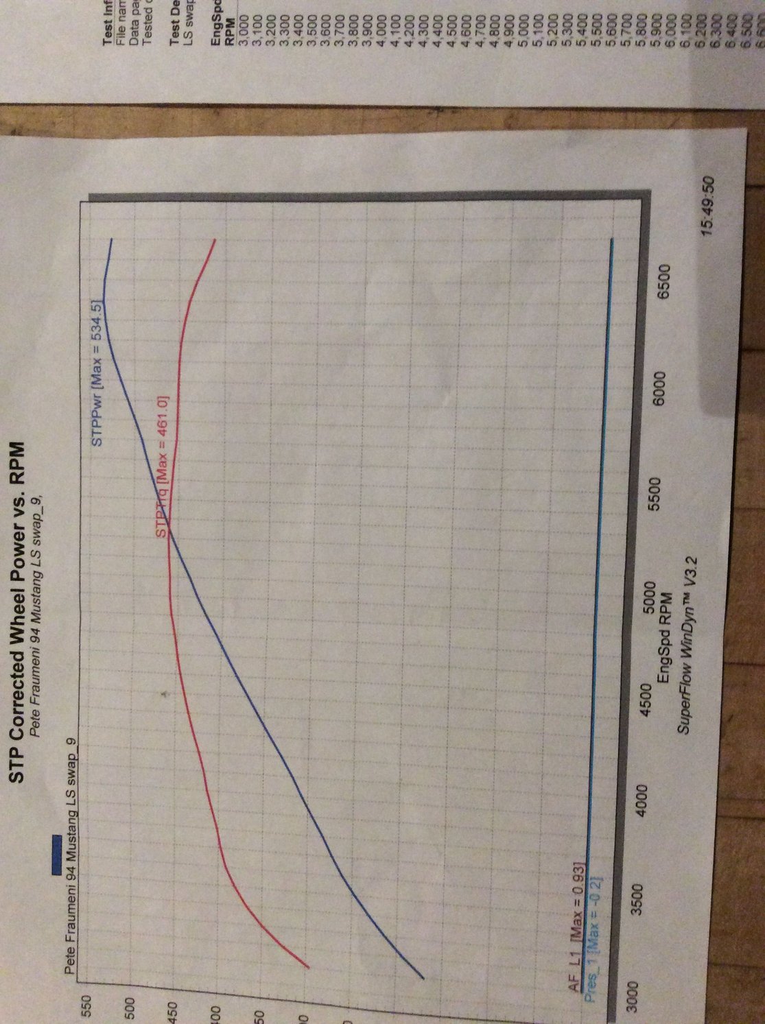

that’s bull s#@t, 383s built and tuned right make excellent power. I built One 4 years ago using hand ported Dart 225s, a 243-251 .624 cam with a Edelbrock ProFlo that made 534rwhp through a 3” X’ed exhaust system dumped on 91 octane, not too many 5.7 making that number NA, Tusky......

Any track numbers? Mph don't lie even if the e.t sucks ***.
I'm not a fan of dynos as they all read differently from one another. Remember Pat G also cracked 500 rwhp years ago out of a ls1 stock cube motor.

Through a T56 and 8.8 in a roughly 3050 lb car with 3.73s went 127mph

383 has an extra 37 ci, a 6.3L with everything being the same the 383 will make more power than a 5.7, it’s not a 346. So I don’t buy what you’re saying, Tusky

127 mph is fast no doubt. Not go tussle with facts which I never do. Facts are facts. However, I know California has that good/better quality air than where I live. If you never been in here in the south you have no idea what it feels like breathing hot air. Its a local T56 sbe ls1 car here that traps 124 mph on motor alone and is 3400 pounds race weight in hot humid *** Mississippi weather.
Im thinking in my mind with a 400 pound weight reduction the h/c/I ls1 car will trap 127 mph ..
