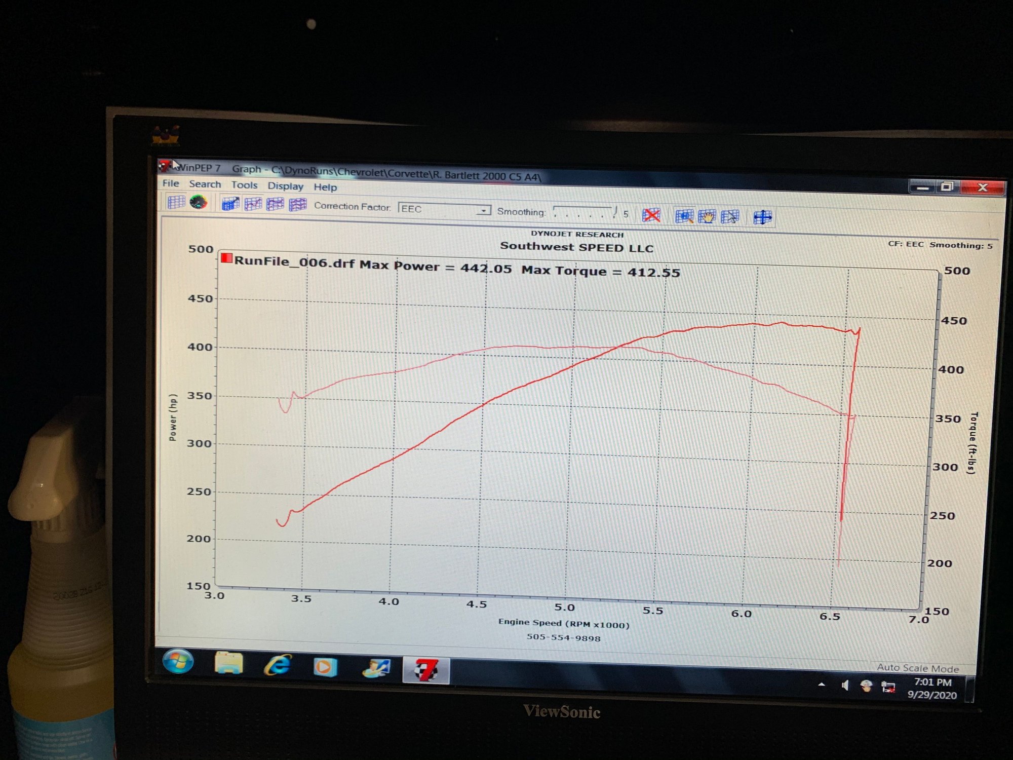

Finally got my C5 done. Mods include TPS longtubes, catless X-pipe, Borla Axle back, LQ9 shortblock, Stock LS3 heads, Gwatney ported LS3 intake, ported LS2 TB, Pat G 227/236 cam on TSP lobes, and Yank SS3600.
Made 442/412 through the auto on a Dynojet with EEC correction. I’m pretty happy. Thanks to Pat G for the cam spec. I love the torque curve.

That'll put a smile on your face, and require occasional extra shampooing of the pass seat once in awhile.

Solid numbers, i'd recommend a bigger converter for sure if you want the best 1/4 mile out of that set up then when you get the extra cash you got about 20hp sitting on the table ditching the ls3 intake and going to a fast 102

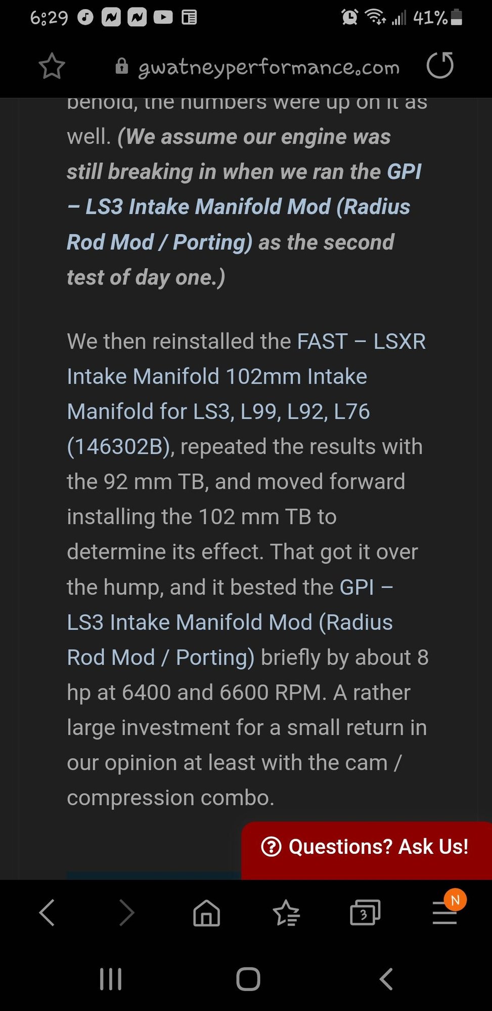

Richy~ good power you have there.
However, the LS3 intake is pretty solid. The LS3 FAST intake is not worth the money in my opinion. I've seen a GPI ported stock/rod mod intake 7 horsepower of a LS3 Fast intake in back to back testing on same exact motor.

I seen dyno results the showed a fast 102 male 19 more HP and 5 more TQ over a ported ls3 so port the fast 102 and the gains will be even better

https://gwatneyperformance.com/the-u...dyno-shootout/

Np, best way to pick the converter is you want it right where its coming into torque so on your setup if you're going to stay N/A then go with the yank PT converter 4,200 or 4,400

I've seen both Richard Holdener and GPI videos showing dyno results of a ported LS3 intake being within a couple horsepower of the FAST all the way up to 7000 rpm. Then the FAST walked away a little bit. I went the route I did because I'm not revving it past 6800. It is worth more research, but I'm not about to spend $1200 for less than a few HP.
