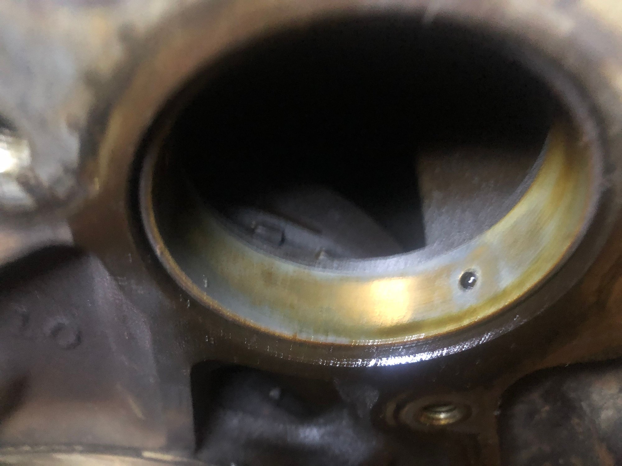

I know you’re not supposed to look but here’s the ones from my LQ4.

Why aren't you supposed to look?
They look pretty normal to me. Take a dial bore gauge and measure your clearance if you're concerned.

Those look ready for some 7k pulls

Just touch them up with some silver spray paint.
It's sort of a joke. Cam bearings, even slightly worn, show copper coloring, leading many to believe they are worn OUT.
So now it is "advised" to just not look at them if replacement wasn't part of the original plan.
Head in the sand kind of deal. I get it.
They’re just too easy not to replace if you don’t have a way to measure them.
Everyone probably already knows this, but new oem bearings come out of the box with copper showing
The thing is, LS cam bearings really last a long time, so it's a case of "ignorance is bliss".
what’s your verdict?
Old Oct 19, 2020 | 09:45 PM
Posts: 22,308
Likes: 3,625
Just to be safe, measure the inside of the bearing in 3 or 4 places to get a bore figure, then subtract the cam journal diameter to get your clearance

How much is to much clearance???
I did not know that.

Worst part is the split design of them. The coating wasn't just wore off my ls6....it was flaking off. That's what lead me to rebuild it....well that and it wasn't gonna get run any easier 😁
