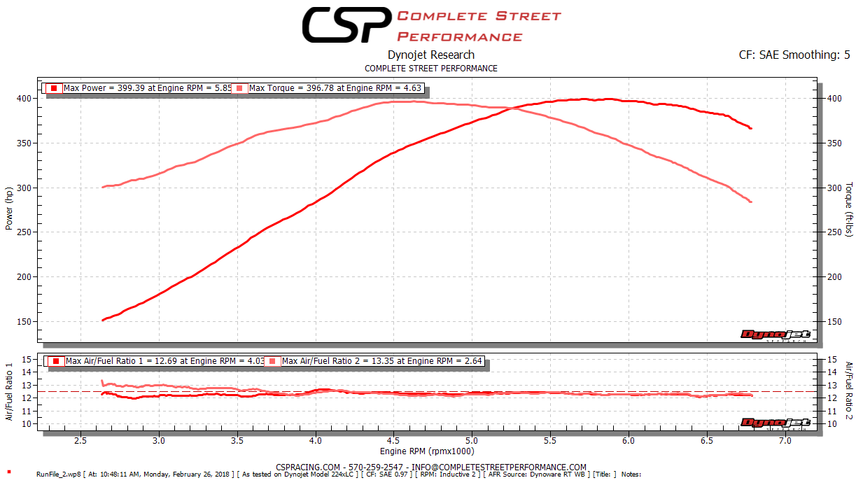

Here's what mine did with a 222/230 emissions friendly cam. Heads milled only .005" for flatness. Same LS9 hg.
399hp 396 tq?
was that an LQ4 Shortblock?
engine dyno or?

Originally Posted by Vette-byrd
399hp 396 tq?
engine dyno or?
The chart says "Dynojet" so it's a chassis dyno.
399hp 396 tq?
engine dyno or?
Yes, everything stock except the cam/springs.
02 sbe LQ4
L92 heads milled .005
LS3 intake with Fast 92mm TB.
Chassis dyno and worth noting it's a 4l60e with small stall thru a 9"

Those are small cam only 5.7 ls1 numbers.
