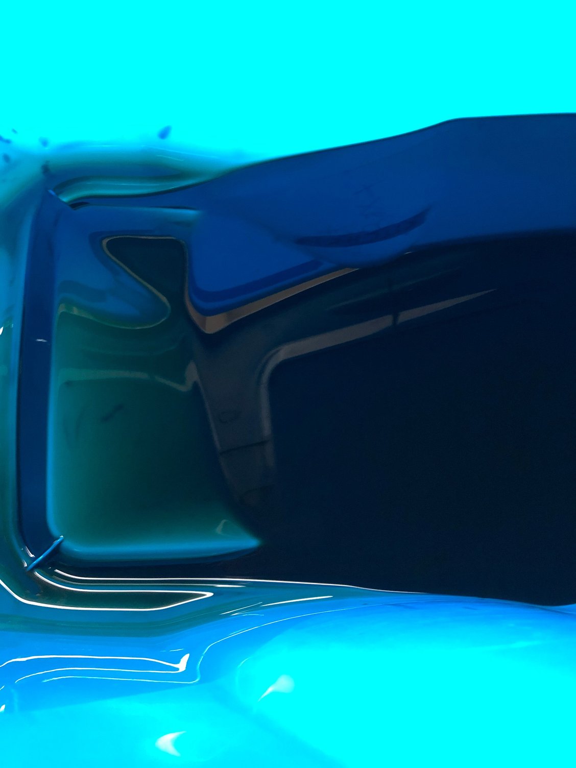

I drained the oil, I ain’t a mechanic but it looks clean if u ask me?? What y’all think? I’ll remove heads by the weekend hopefully, both sides of valve covers looked fine. I saw sum bubbles or sum on top but nothing attached to a magnet

Oil looks fine from what I can see (not much tho lol), mine looked like I could pan for gold also there were chunks of the roller tip in there. Pull the heads and look at the lifters. That sound isn't normal. Might as well order a set of replacement ones. That is still my bet. Lifters are known to do this in LS1s, that is why GM now recommends the LS7 lifters as replacement. I've never heard of a stock spring breaking from a cold rev.

Originally Posted by Bakir Bakir
What is that metal needle bearing looking thing in the bottom left of this picture thats inside the pan?
A bad rocker arm could defiantly make the sound your hearing
