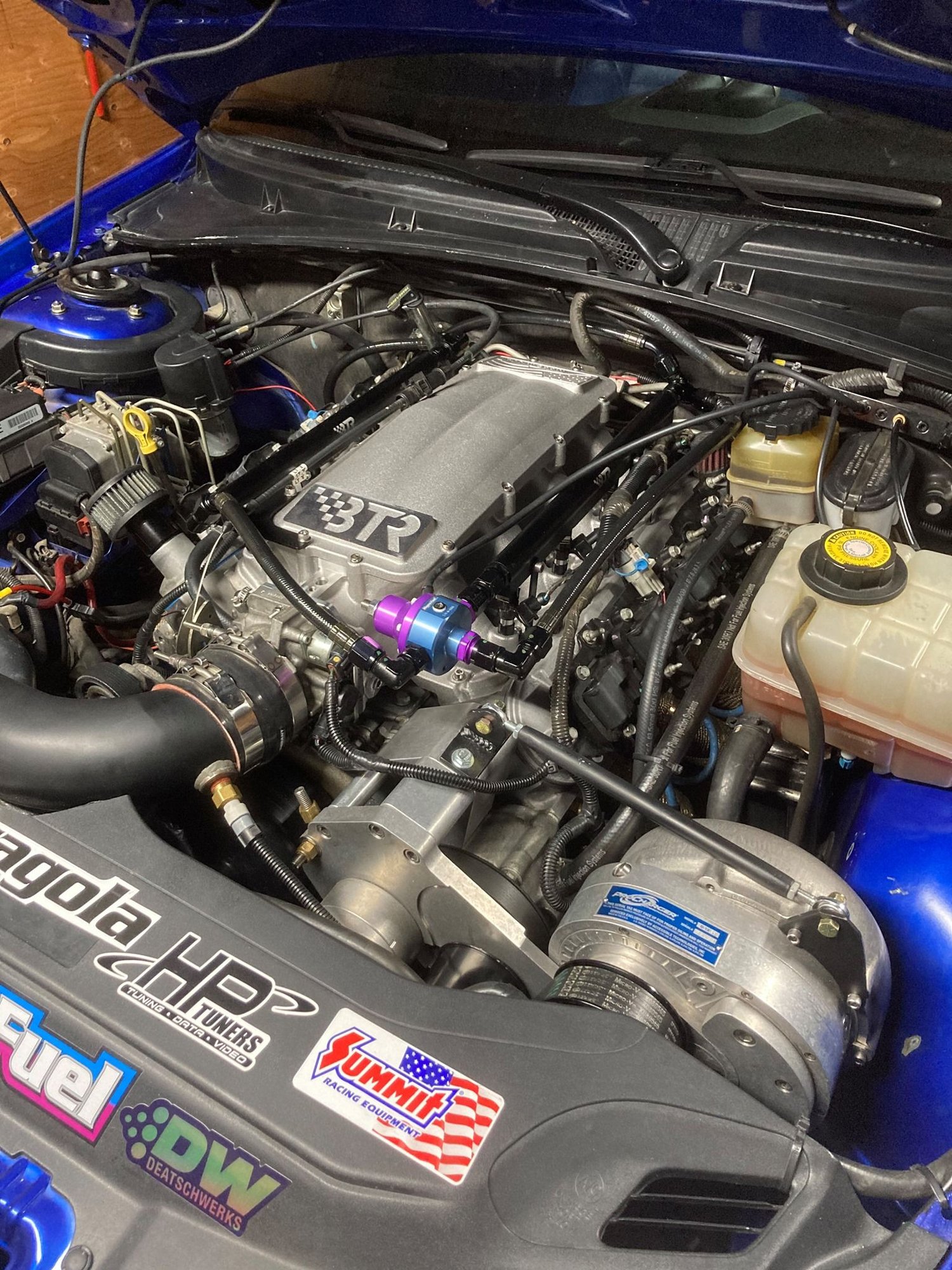

I don't think he's near 900whp yet, but I've seen 900+whp through a 2.5" Corsa exhaust. Look at the CTSV guys making 750+whp and running 9's with a completely stock exhaust, doesn't seem to be a huge restriction. They argue all day if headers are even worth it, they just turn up the boost or spray it. If its that big of a concern get a boost actuated cutout for way less than a full exhaust.
I think he said based on his ET/MPH and fuel consumption he was near 900fwhp. Would be really easy to test though. Dropping the exhaust and running open headers is free. I don't even know if they make a 1 7/8 header for the GTO. Just interesting to see whats to gain there.

I'm running 1 3/4 headers with a 2.5" magnaflow catback

114 mph at 3900 lbs in the 1/8th with a 2500ish DA on 15 psi currently at 20 psi, but haven't ran the car at this boost level. If I cared about dyno numbers I'd put the car on the dyno. I don't feel the need to travel and pay for the time though. One thing is for certain no matter what I post on this forum you will find me and say something negative about what I'm doing.
Just one guy in a tiny garage with limited tools doing all his own work and having fun...Just to trigger you some more my bro charger combo...I'm the slowest guy of the local group of friends I hang out with so that keeps me humble.

I'd put down a Benjamin it picks up a couple tenths and 1.5 mph in the 1/4 running 1 7/8 to cutouts. Whether or not that's worth the cost is up to OP. Considering the other items being talked about replaced, it would be cheap lol.
From what I’ve seen it seems that header primary size does more than cat back exhaust diameter. Saw a friend pick up a ton with 2” primary, but when they dropped the exhaust on low boost he only picked up 19 rwhp if I remember correctly. On high boost dropping the exhaust gained a ton though. This was over 1700 rwhp with a gear driven Procharged 427 dart block combo though. Most events he does requires full exhaust and mufflers except for turbo cars aren’t required to run an exhaust or muffler.

Something else to consider is with less backpressure and better flow, you can rev higher as well as add more timing up top, which is part of your overall goal. This is besides NA gains which are multiplied when in boost (~2.5x NA at 20 psi).

Something else to consider is with less backpressure and better flow, you can rev higher as well as add more timing up top, which is part of your overall goal. This is besides NA gains which are multiplied when in boost (~2.5x NA).
You aren’t wrong. I’m happy with the sound and how quiet it is right now though. My cam was custom with all things considered except for my recent intake change. With 248 exhaust duration I wonder if my improvement from an exhaust change would be less than normal.
I do have long term goals of 6 bolt heads/block and a much bigger blower which would make the exhaust more effective long term as well.
I respect your advice/input you haven’t steered me wrong in the past. You also do it without the huge ego and always rambling that anyone who does it different than you is dumb because you are better at this than anyone else lol

I definitely appreciate a quiet street car. Cutouts really are good stuff. I haven't tried a boost activated one yet, only electric. Interesting point about your exhaust duration. Hanging it open longer would help. Thanks for the kind words to boot. Curious to see where your car lands, especially after you add the WMI kit and up the rpm.

Yeah if it's already 1-3/4 and dual 2.5" there may not be a lot of room to grow with the exhaust at this point.
Could always try open headers with extensions on them to see if you pick up anything.. as a starting point to see if the exh is worth fooling with.
