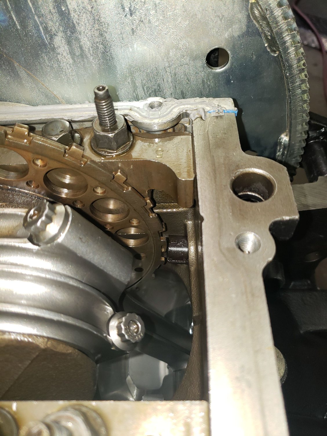

Folks, I have a fresh 370 build that has about 15mins of run time, mostly all idling in the garage with 3500 being the highest RPMs it has seen. Car has not been driven yet.
Engine was idling nicely when it suddenly stumbled and died. Fired it back up and ran like it was only firing on a couple cylinders then started to clatter lightly. Sound seemed to be coming from the bottom/rear of the engine. Pulled the plugs and all 8 were sooty or wet. So, with all 8 cylinders misfiring and a noise from the rear of the engine, I assumed crank sensor/reluctor. Engine is out and gone through and I feel confident the rotating assembly is good. I am chasing other things to determine source of the noise. Crank reluctor feels solid and fixed but would like to verify its alignment.
These pics are with #1 at TDC on the compression stroke and I am hoping someone could tell if the reluctor is properly aligned relative to the sensor. The project build is in the Conversion / Hybrids forum and a little more detail on the issue can be seen HERE.
Thanks.
