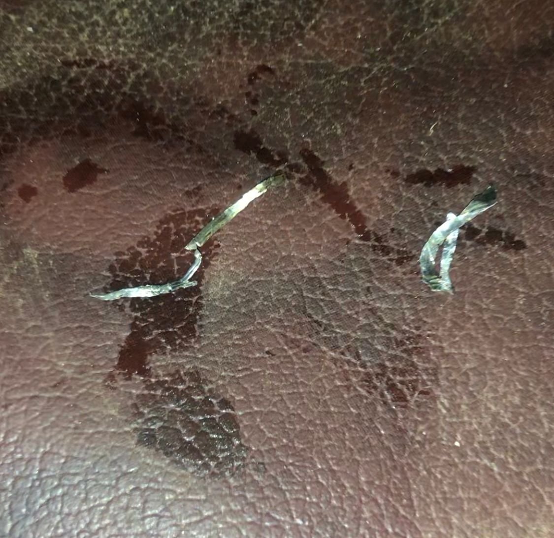

Lifter can certainly be bad internally, so can one of your rocker arms.....
This was lodged into the pick up tube screen. its softer metal but not like brital but what do you think? should i be worried about bearings? One of my buddies said this is normal wear for bearings for a 93k mile ls1. The metal is about the size of fingernails

You've already posted this in another thread, AND gotten answers

ya bru, unfortunately it was spun rod bearing... I originally forgot to cut the oil filter open but basically at the bottom of the oil pan there was oil with tiny metal flakes in it and I knew it was time for a rebuild :/
I just got the shortblock back so hopefully I'll have it running within a month but damn its been a journey. I hope its just your lifters for your sake...
