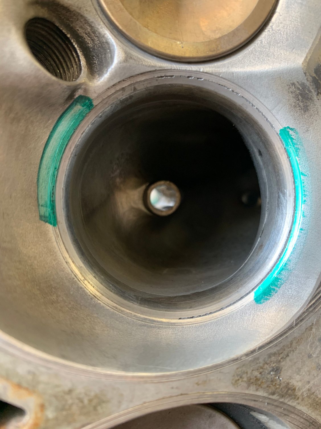

manley ported heads with big valves. Got them from a buddy who had them on a 1200hp turbo car. The valve seat was damaged then fixed by local machine shop. Giving them to me for $1500 but idk size of valves.

Heads:
I would take another look at those heads. Last I checked, Manley supplied valvetrain components, not porting services. The valve job looks botched to me. Maybe its the pic, but it looks like the edge of the seat insert in the head has chipped away. Whomever did the porting and blending, it looks decent.
The runner length of the FAST intake is going to pretty much force peak power in the 6200 to 6500 RPM range. You will need anywhere between 404ft-lbs (@6500) and 438ft-lbs (@6000) to reach your goal of 500whp. This is a very reasonable goal with either stock stroke or a 4 stroke crank, but the more cubic inches will definitely make it easier, even if the heads and cam are not ideal.
