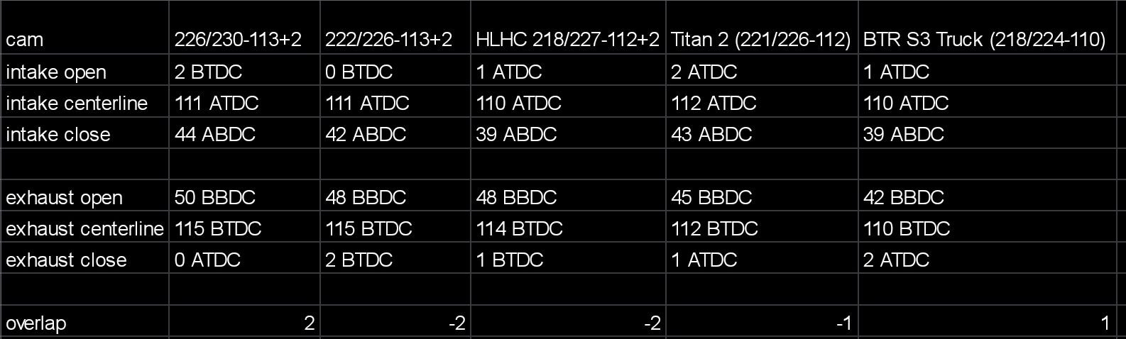

Yes pretty close, they are all somewhat close. I put this together based on an online calculator. I checked it against the cam card for my 226/230 and it was within 0.5° or so.
cam226/230-113+2222/226-113+2HLHC 218/227-112+2Titan 2 (221/226-112)BTR S3 Truck (218/224-110)intake open2 BTDC0 BTDC1 ATDC2 ATDC1 ATDCintake centerline111 ATDC111 ATDC110 ATDC112 ATDC110 ATDCintake close44 ABDC42 ABDC39 ABDC43 ABDC39 ABDC exhaust open50 BBDC48 BBDC48 BBDC45 BBDC42 BBDCexhaust centerline115 BTDC115 BTDC114 BTDC112 BTDC110 BTDCexhaust close0 ATDC2 BTDC1 BTDC1 ATDC2 ATDC overlap2-2-2-11
