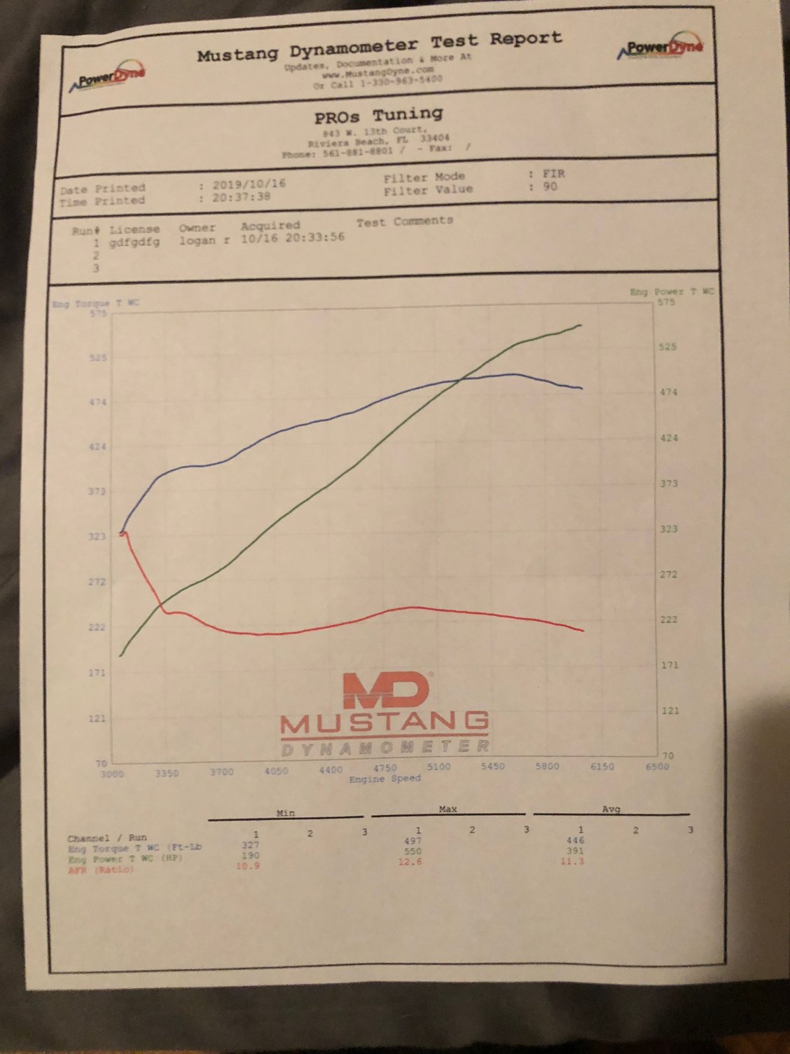

This is a 5.3 with forged pistons, rods, 4” forged crank, tick blower cam, procharger F1-a, cnc’d afr 205’s on 11lbs and pump gas. This is through a T56 magnum and ford 8.8 irs. Tuner could only run it to 6,000 because the boost was gonna go to 13-15lbs and that was too much for pump.
