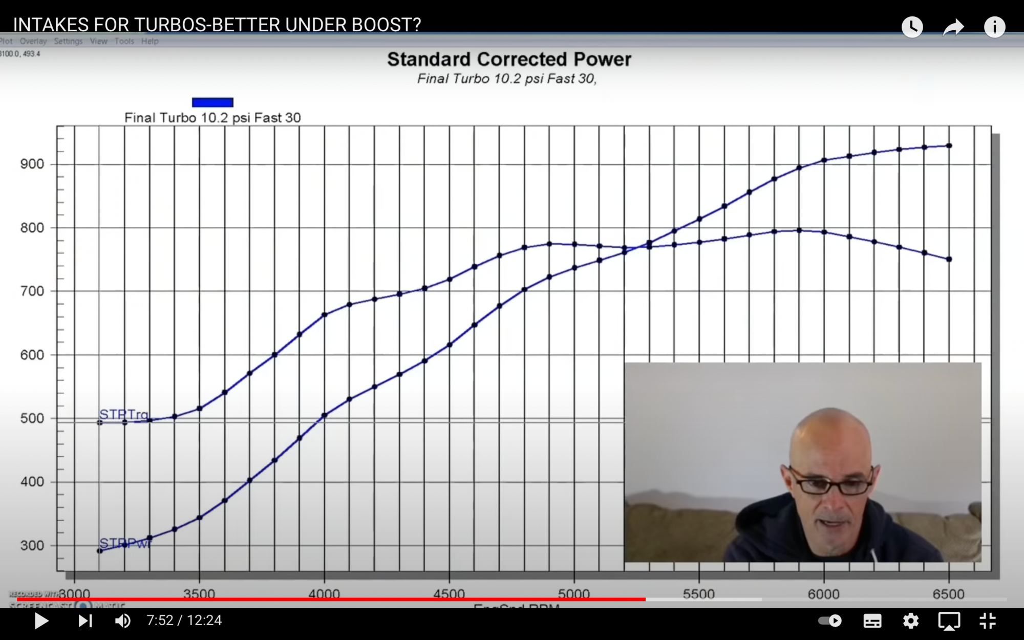

How well do the FAST composites intakes hold up to boost? I would think that they wouldn't hold much boost with them being a two-piece manifold.

​​​​​​​Everything I've read and seen says and shows they can take whatever is thrown at them. Now that said, let's assume these are street legal cars seeing relatively sane levels of boost here. The FAST Manifold @ 10 PSI on a twin S475 6.0 makes north of 930HP.
Cool, they just look like they would blow apart where the hafts came together. Thanks.
