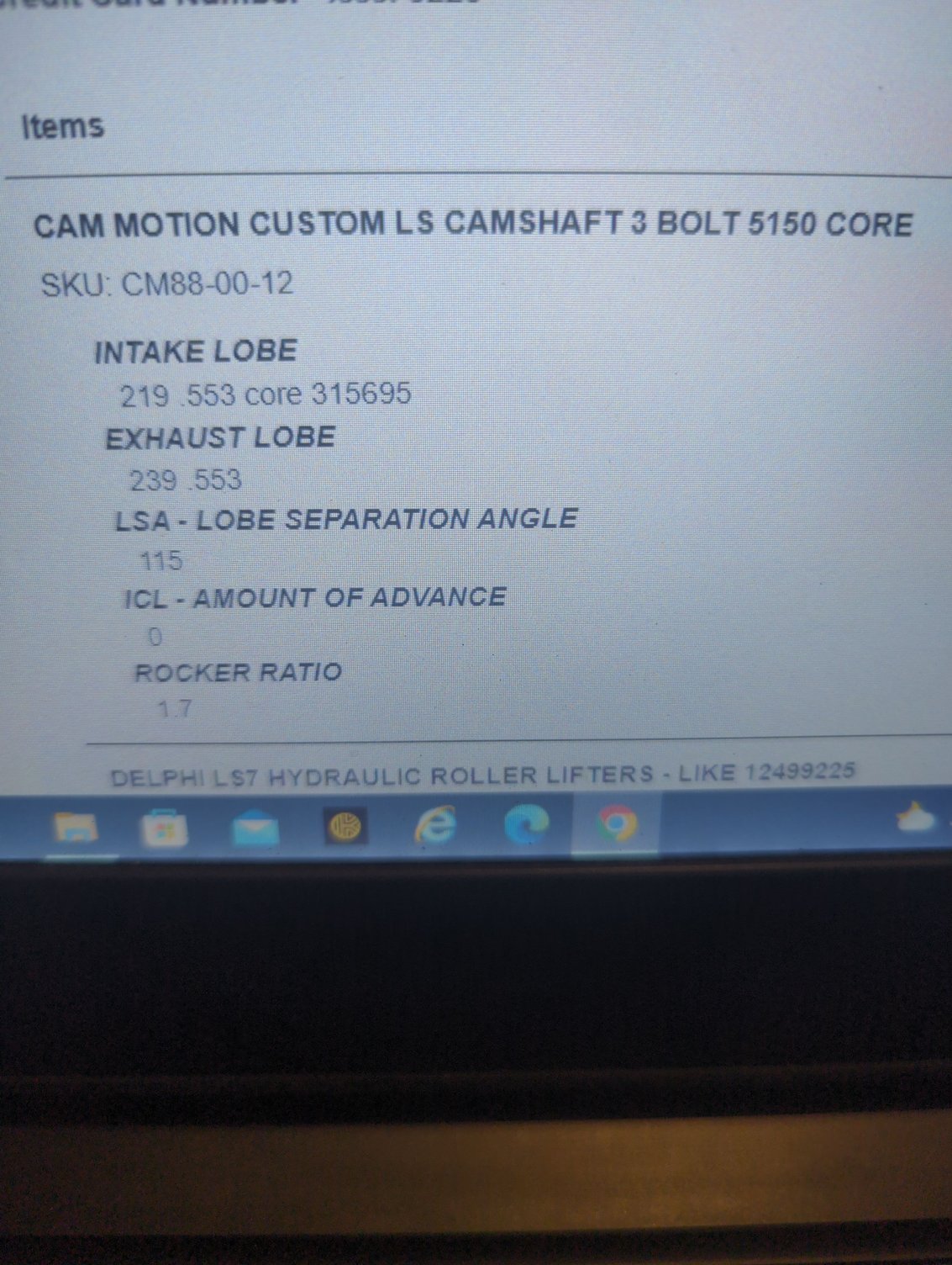

Well I just purchased my cam. Cam motion custom ls cam 219/239 115 cam and ls7 lifters

That is a HUGE duration split!
that's an ls3 type split

That's what the guy at btr emailed me.
I just sent him a email to make sure

BTR SKU CM88-00-12
Brand Cam Motion
Part Type Custom Camshaft
Engine Type Gen III/Gen IV LS
Engine Combination CUSTOM
Camshaft Style HYDRAULIC ROLLER
Cam Bolt Style THREE BOLT
I haven't seen too many rectangular port specific cams with that much split.
You normally see that in cams like the OEM LS7 and LS9 cams which are 211/230 with a 120 (LS7) or 122.5 (LS9) LSA.
It is more typical of a supercharger cam that needs lots of exhaust duration.
