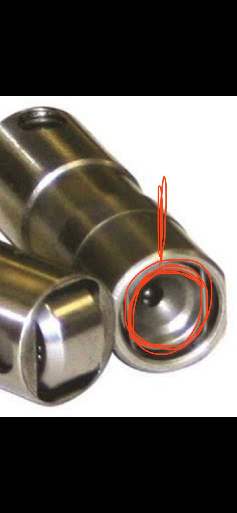

So Im not getting any oil pressure after my new lifters. I tore the heads back off and tested the lifters with air. My brand new lifters are leaking around the plunger when I blow air into the feed hole, does this make sense??? Heres a video

Originally Posted by FleXJ
Engine tech
Never heard of them. Probably made for them by Eaton, or?? Anyway, see if you can borrow a known good used lifter from someone. Barring that, I once read where traditional SBC lifters were the same as LS1 lifters, so if you have a set in the garage, see if they oil. I also once ran a set because I'd read that info in Hot Rod, and damned if they didn't work just fine!! With the lifters removed, can you see oil coming into the lifter bores?
Old Jul 14, 2022 | 05:05 PM
FleXJ's Avatar
Joined: Jan 2016
Posts: 34
Did you see the video I posted?
oil leaks around this area
