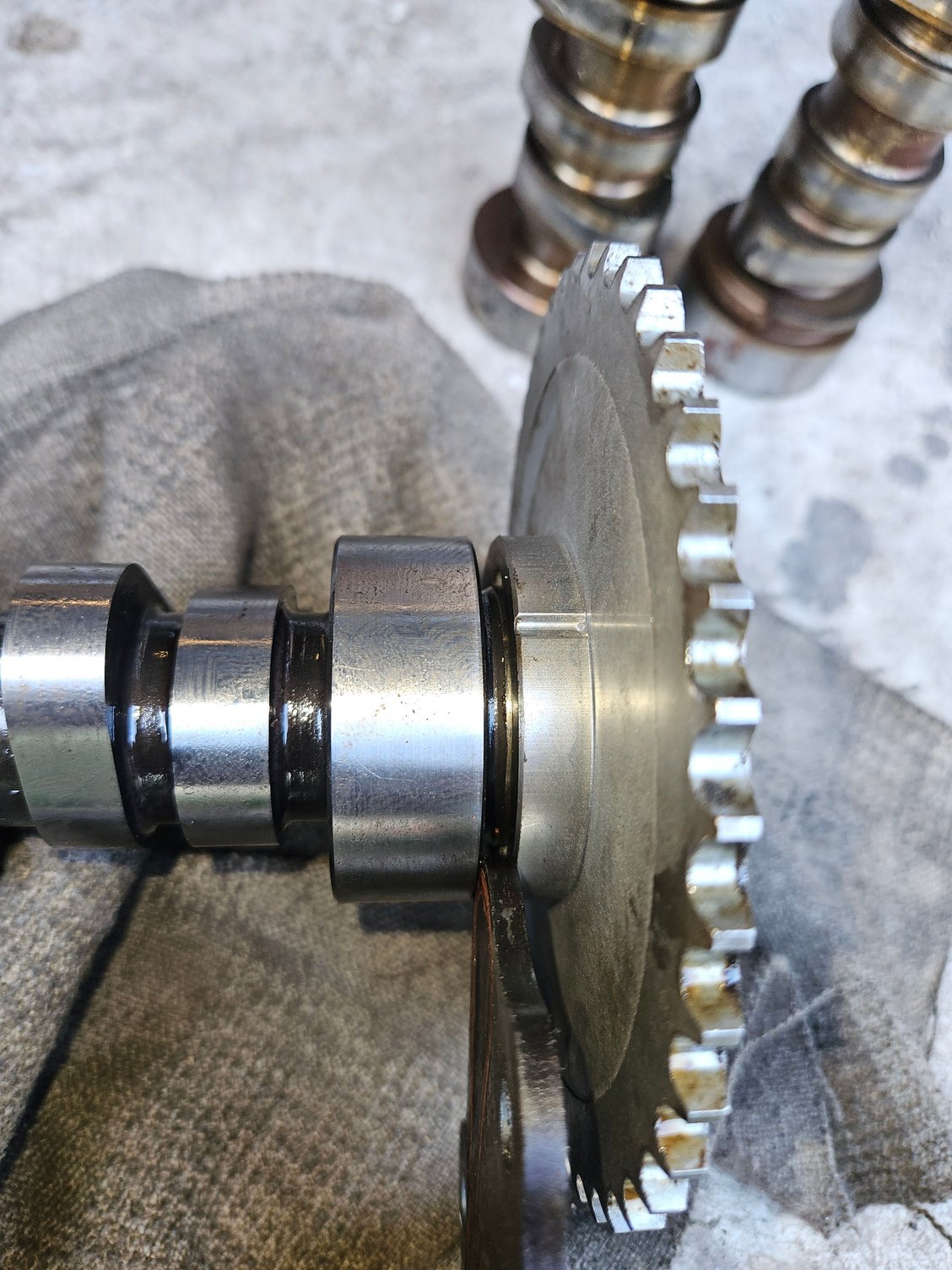

This is bolted up with retainer out of assembly and there's the gap thats left. I CAN push retainer in that gap but it's too tight

I can push it in there it's tight but not gouging tight. It's perfectly tight... but think the overall friction on the whole plate when installed is too much friction. Maybe need .006 thinner plate...

One thing I did do to was dig out my old gto camshaft that I know worked fine in LS series and ground correctly. It looks the same as the new one they sent. Short nosed, not long like the one I'm replacing. Leads me to believe the long nose one i pulled is possibly more about the phaser situation. And the sum of all tolerances are adding up against me. Either a thinner retaining plate or machine shop to plane lil bit off back of timing gear, both options should fix.
