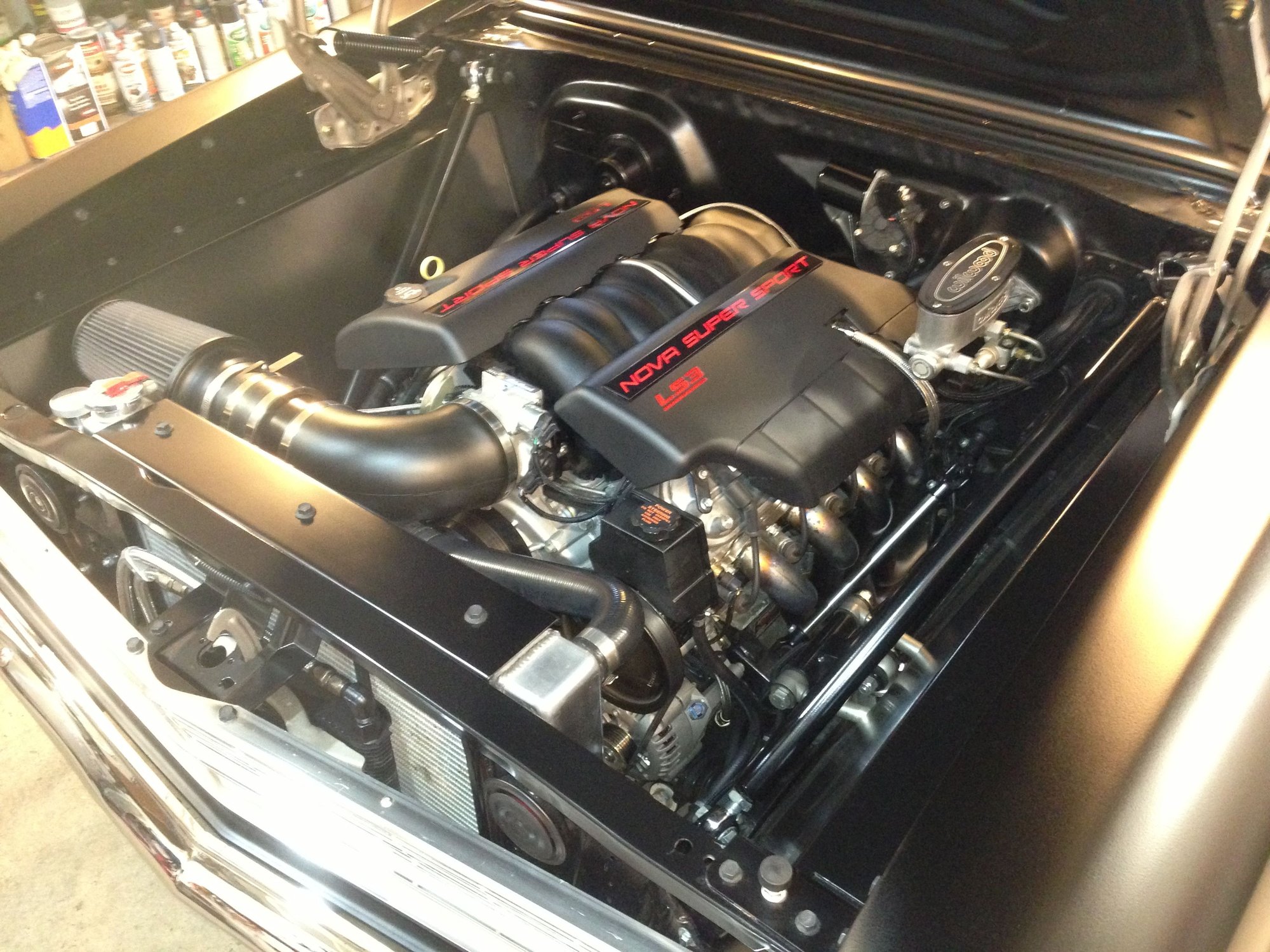

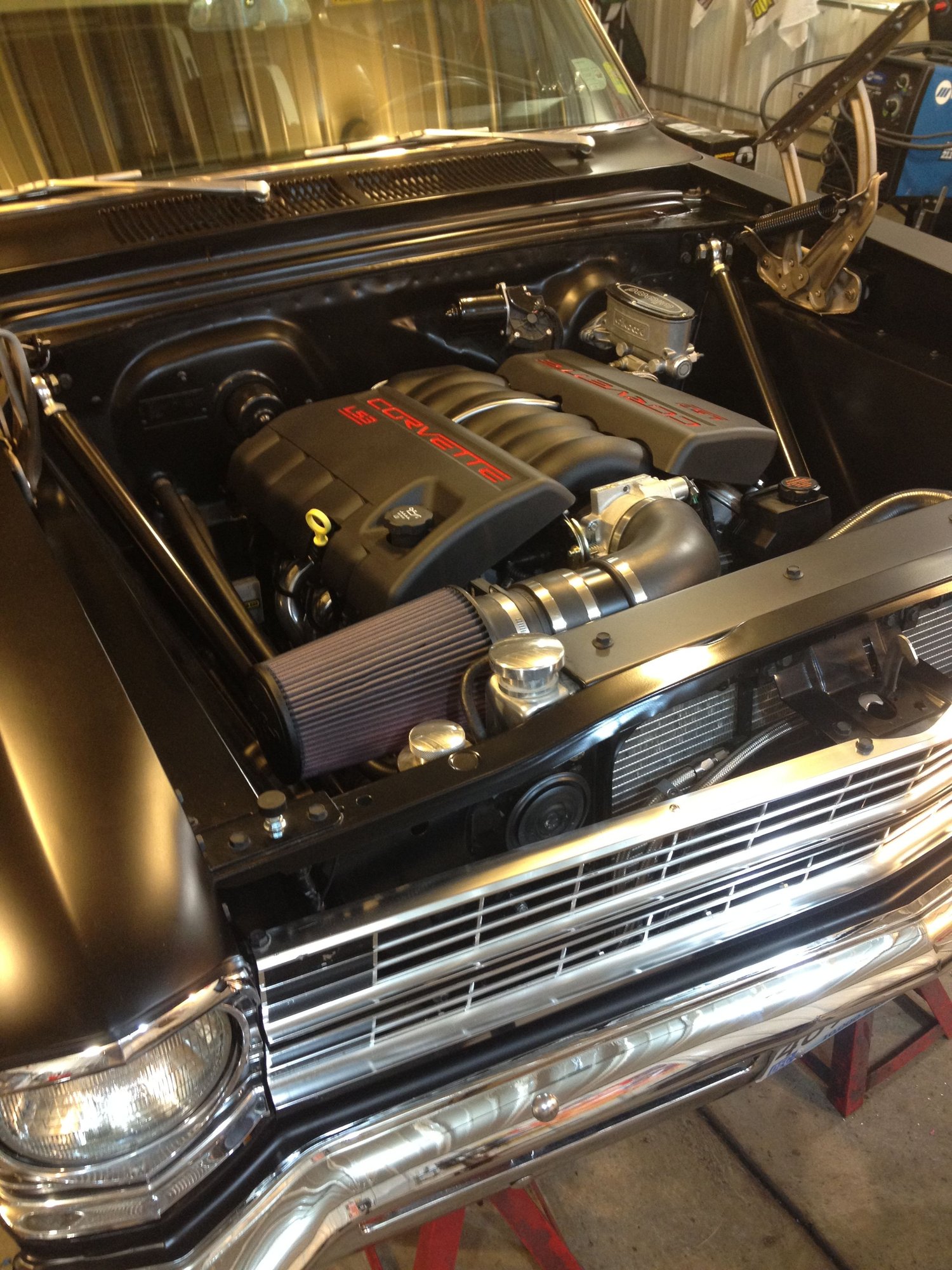

I did a LS2 block sleeved by Steve at RED with a LS3 heads. Stroked to 427 cubes. Manley forged rotating 24 tooth rotating assembly.
225I/230E cam. Tuned for 91 octane. Super easy to tune. Used a 4L60E. Did 480 rwhp on the dyno. Not huge numbers but in a 67 Nova it was quite fun to drive.
Plus it's so much fun to say I have a 427 cube engine. LOL.

That engine in a Gen I Nova has tobe a blast! From off-idle all the way up! Able to shred copious amounts of rubber at will......

The Nova was a bit scary if you weren't going a straight line. I did do a Heidt front and rear suspension swap so the handling was OK. Big brakes front and rear.
3000 stall Yank converter. Drove like a stocker until you nailed it. Cruising at maybe 40-45 mph and flooring it, it would down shift from 4th to 2nd and light up the rear tires. I could of went bigger on the cam but talking to of couple engine builders I would of had to upgrade the heads to gain much.
Couple of pics.
Old Oct 9, 2022 | 12:26 AM
Posts: 22,308
Likes: 3,624
Man, that is one kleeeen install!
