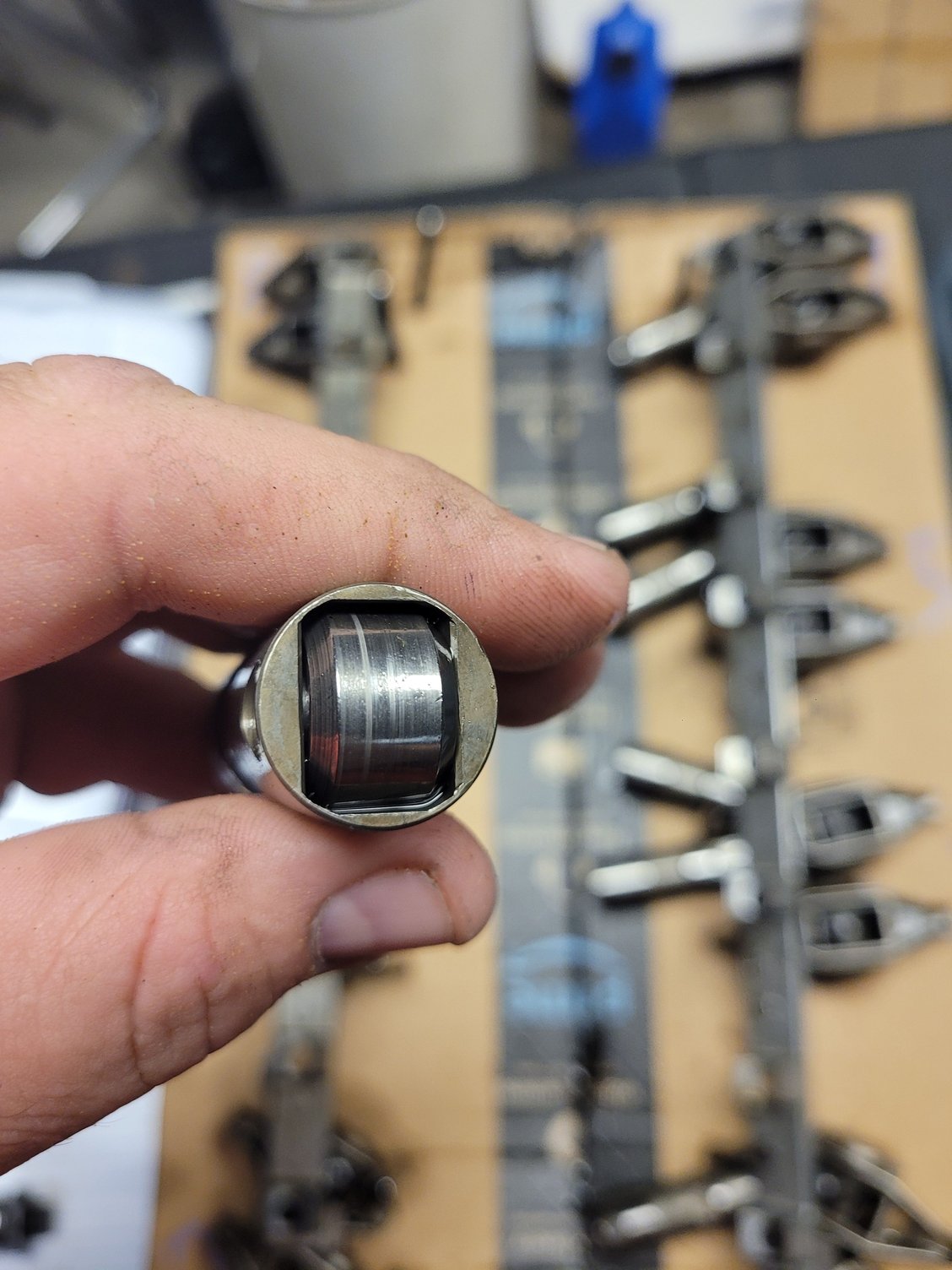

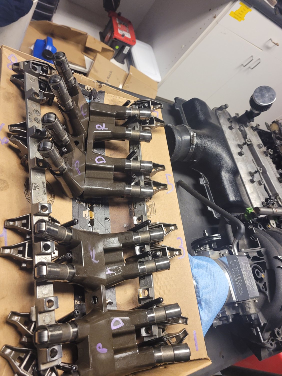

Well.... it looks like I owe you a dollar. Send me your address and I'll send it right over 😆. I pulled the heads and didn't find anything in the top end that would be making the knocking noise. There was some scarring on the lifter rollers but nothing major. I did find out that the engine is ls2 392 stroker Instead of a LSX block. Ill be pulling the engine in the next few weeks to take over to TKM and will update with what I find in the bottom end.

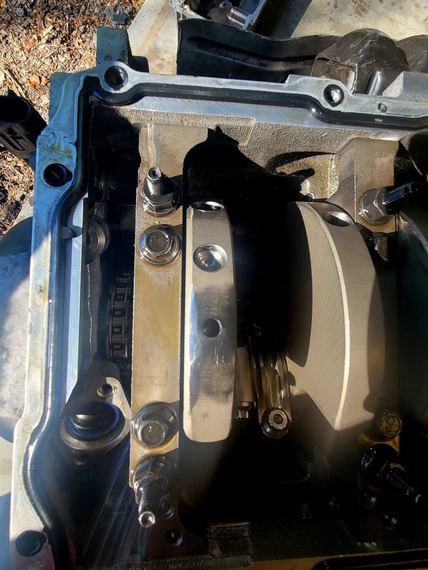

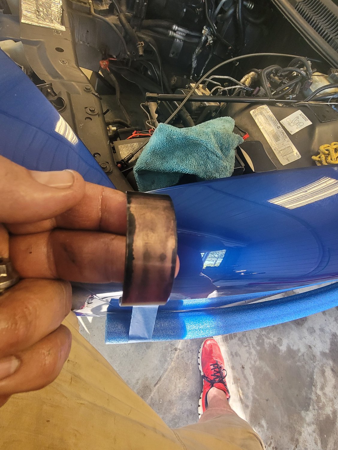

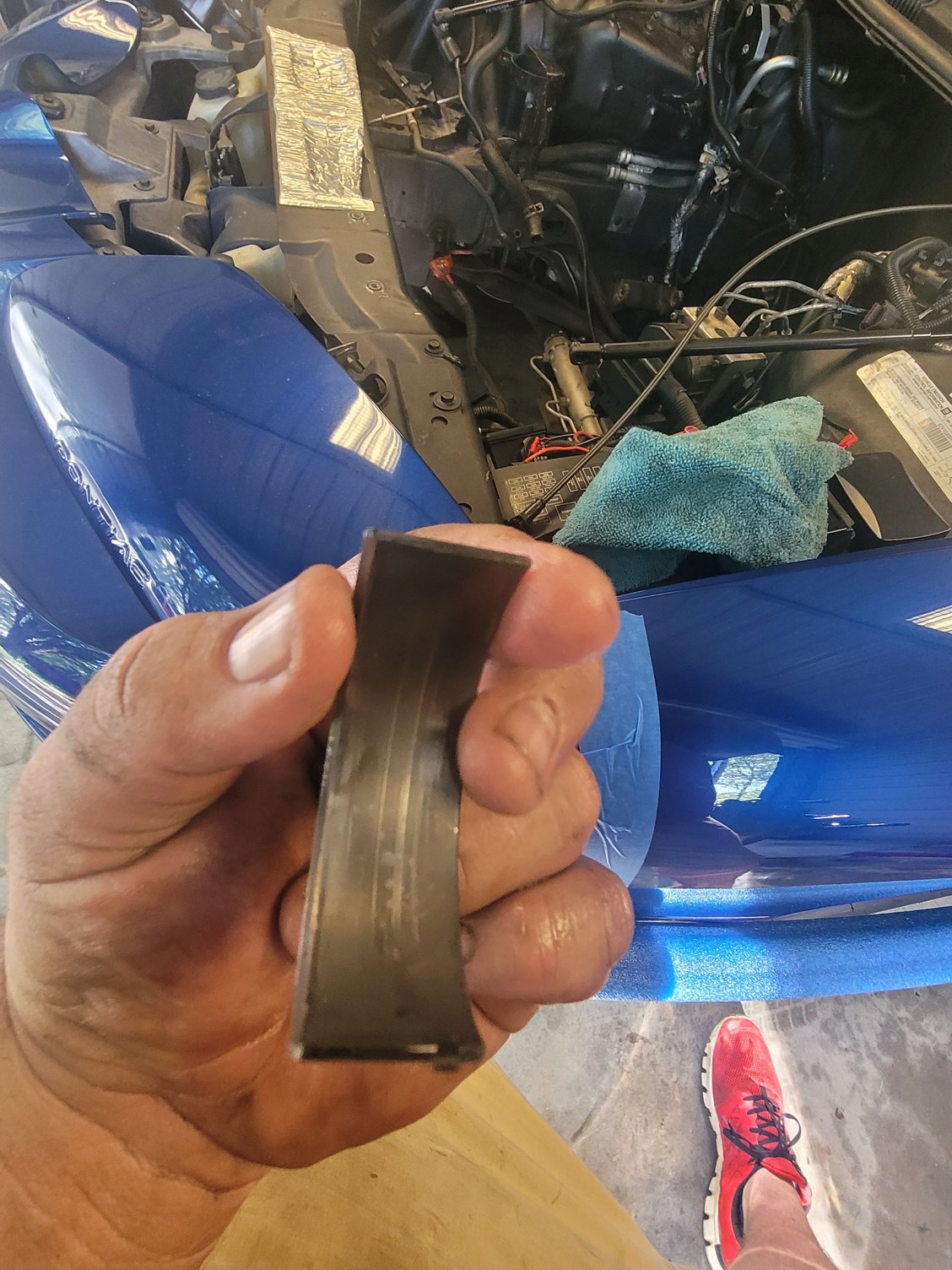

Just now got around to pulling the engine. Sadly I didn't find a spun bearing. There was some wear but nothing that would catch my nail. No metal in oil pan. No witness marks on anything hitting. Block is clearanced for stroker crank. There is a shiny area on the crank. Also the bearings are copper on the rod side is this normal? I haven't pulled the main caps yet. Has anyone ever experienced a knock from the main bearings?
