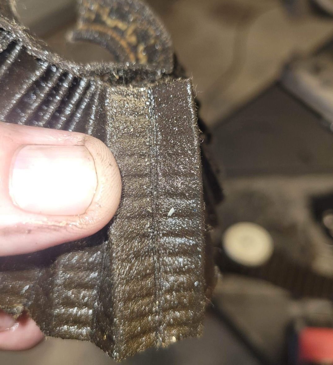

Did you cut the filter open? If you did I missed it

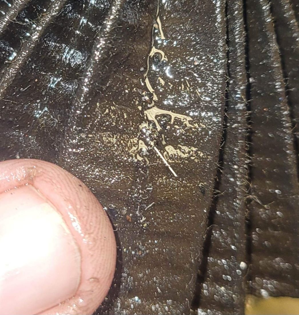

Yeah found some metal. Not a ton but enough to be suspicious.

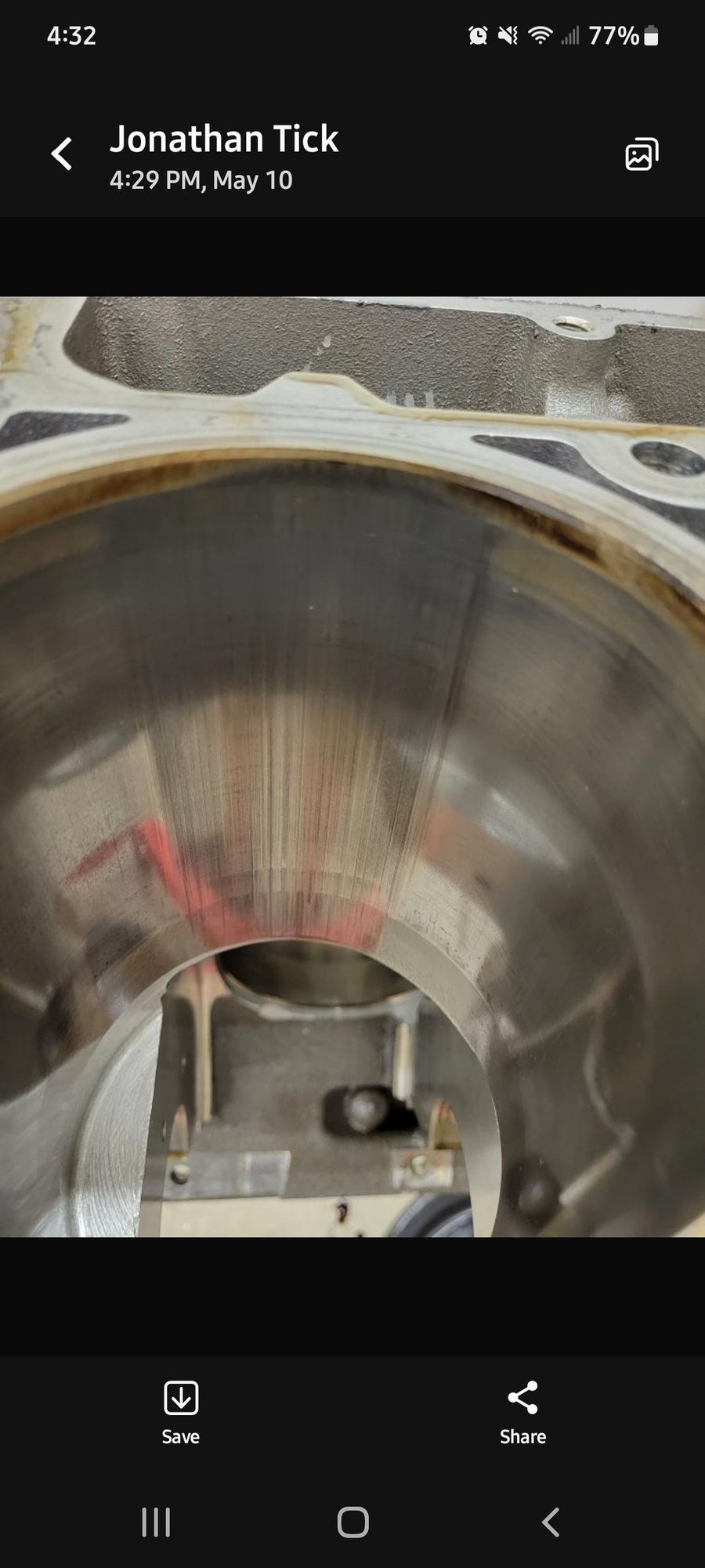

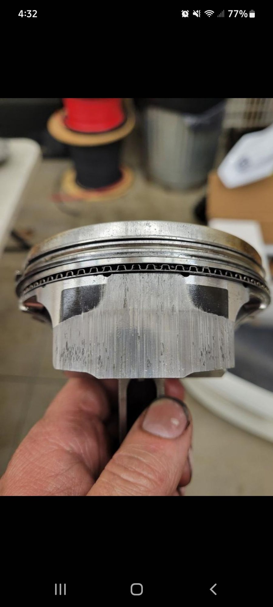

Just in case anyone was curious what the knocking noise was. Going .020 on ls2 block now.

Are the top and 2nd ring stuck in the piston groove? Or does it just look like it in this pic?
I'm not sure, these pics where sent to me by my engine builder.
