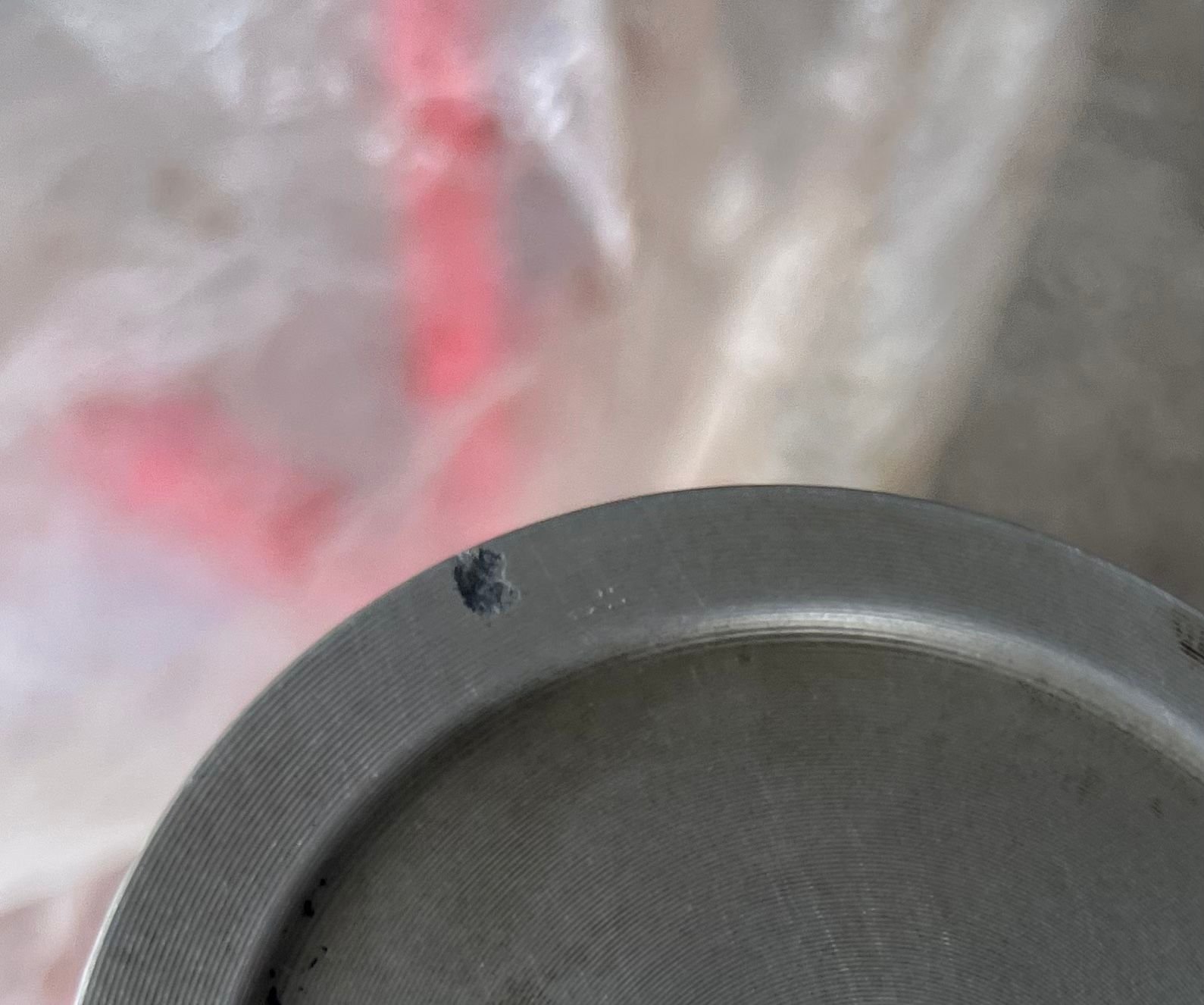

Im rebuilding my first LS engine (2001 LQ4) and as I was cleaning the carbon off of a piston I noticed a small pit on the surface. Do I need to worry about it? Can I still use it? If not what are my options?

That depends, What are you doing with the engine?
You can also source another used piston.

I'm not positive it's a problem. Possibly smooth any rough edges with small file or emery cloth.

I’m using engine to go into a project car.
if I get another used piston, do I need to worry about being compatible with cylinder wear. I am honing cylinders.

I'd be more concerned about running a used set of pistons if it were me but if P-W clearance is within spec's I suppose it would be okay.

I agree. I definitely would have to check clearance with a used piston.

I would take a dremel with a small carbide burr on it. The one with straight sides and rounded tip (not the one with a small ball on the end) and just smooth and blend it out a little.
Looks like a casting flaw from the factory???
