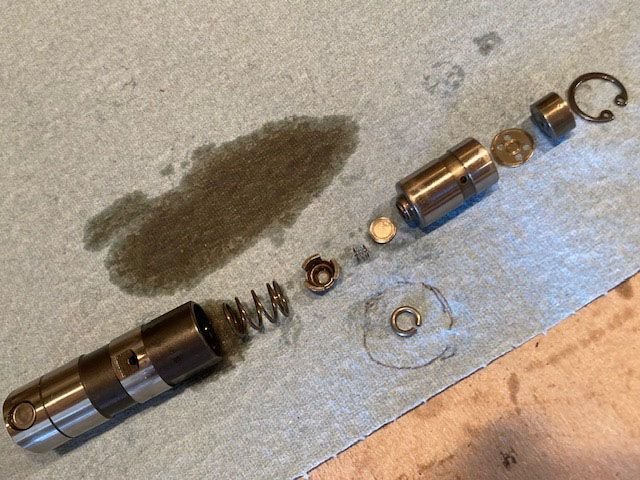

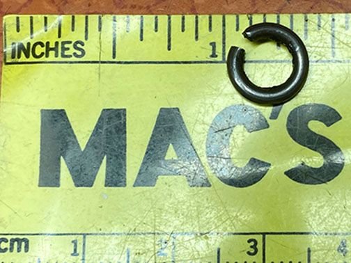

Next I dumped the oil, second time in a week and found this ring in the drain pan. The noise has not changed over the weeks, I just hope the cam is not toast.

I can not tell from online photos that there is a ring on the lifter roller pin, it looks staked.

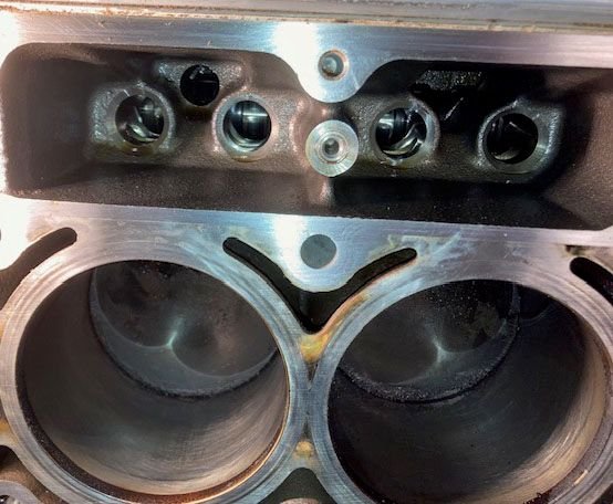

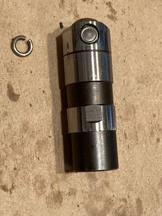

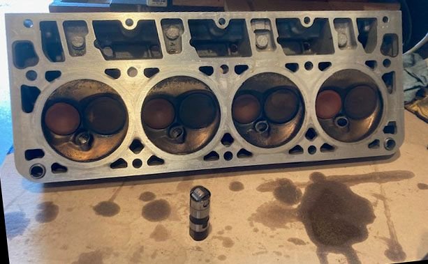

Well, I pulled the head off the noisy side. Lifter looks good, no missing parts on the lifters. That 3/8" ring does not belong to the lifters! The cam looks good. Stock rockers look and feel good.

Everything looks good! Mystery part circled.
mystery ring, not broken, made that way?
Part does not belong to the lifters
cam ok, cross hatching is there, just did not show up in the pic. The funny pattern on the pistons are from the light .
Red exhaust valves

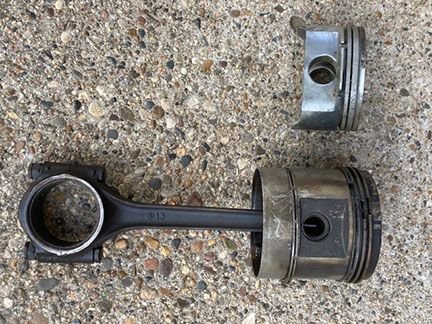

2002 5.3 piston and a Hudson Hornet, count the rings!

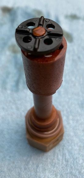

So back to the mystery steel ring, I removed the oil level sensor and that looks good. I was hoping that I had a previous style that used a ring!

Don't know what the part is that you've found. What I do know is that Hudson piston has a LOT of skirt area compared to the LS piston. My $$$ would be on the LS having piston slap LONG before the Hudson will.....
Yes, tall piston. I read somewhere that Hudson piston speed, exceeds the material used, but the large diameter of the crank throw slows-speeds up the piston so gentle that the piston does not come apart! My surviving bother and I inherited our father's Hudson from our youngest brother. Going to take much work.
