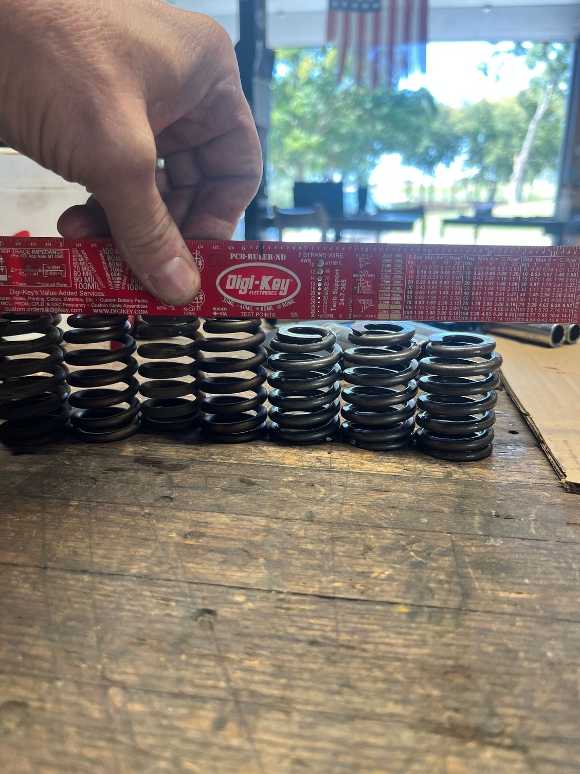

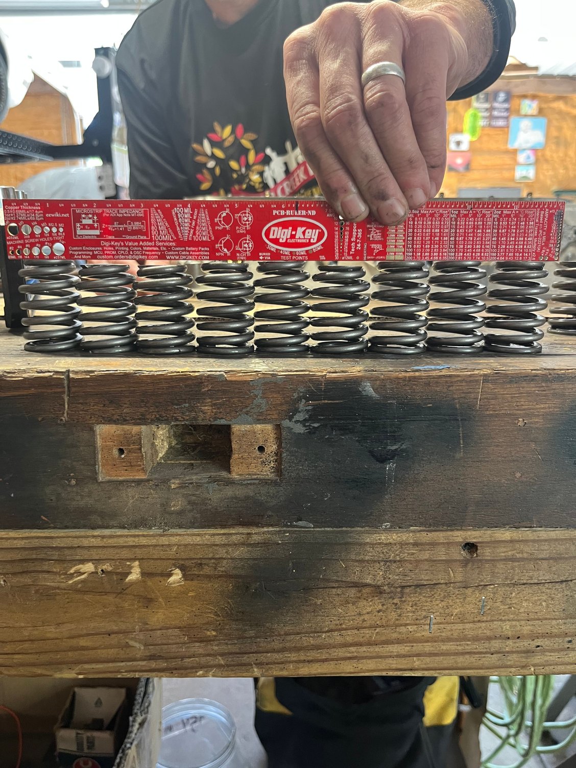

I did a lot of fone conversations with him and finally had him pull the springs. When he told me he could compress the springs with his thumb, it became clear there was an issue with 4 valve springs.
He put a straight edge across a set from 1 head. 4 were WAY short!
He found a set locally and put them on .
WALA! runs well!
My thinking is those 4 springs were never heat treated and were collapsed when the engine was first started.
WALA! runs well!
