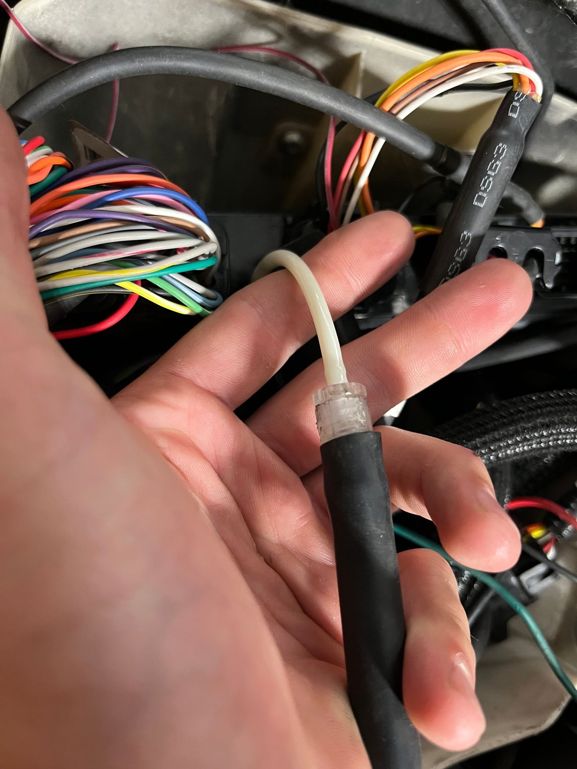

Where do you have the MAP line plumbed to?
Old Sep 1, 2023 | 11:42 AM
inhuhman's Avatar
Joined: Apr 2023
Posts: 19
From: Missouri
I have it going straight to the Holley term x max internal 1 bar sensor from my air intake.
Old Sep 1, 2023 | 12:03 PM
inhuhman's Avatar
Joined: Apr 2023
Posts: 19
From: Missouri
Line comes from bottom port on intake.
Goes into internal map sensor

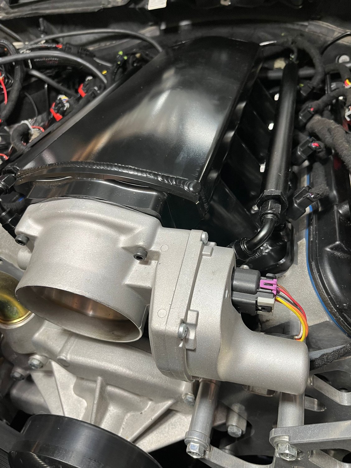

pulled valve covers and cranked the engine. All rockers and valves are moving but that does not mean they are sealing. I think a leak down will be a telltale if I have an internal problem like bad rings or valves. Pulled the plugs and saw spark on all plugs. Can't really test injectors but since they were brand new id have to assume they are good.
This is my intake and throttle body (mine is in black)-
LS Low Profile Metal Fabricated Intake Manifold DBW LS1 LS2 LS6 102mm Cathedral
https://jackspaniaracing.shop/produc...aa729374&_ss=r
