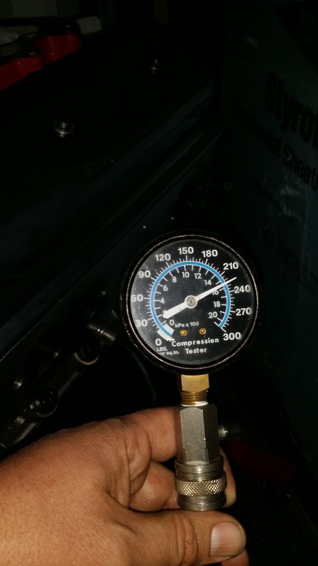

I get by with a 383 SBC that cranks 225 psi on 93 pump gas all day long. Its about 9.3:1 DCR and 11:1 static. Runs 32° total advance at WOT. I read the plugs, ended up dropping 2 heat ranges compared to a stock L31 350 it was based on. With high compression you are likely to run into problems from the plugs being too hot of a heat range and acting like a glow plug. That engine combination moves 7,000 lbs everytime it runs and frequently moves up to 15,000 lbs.

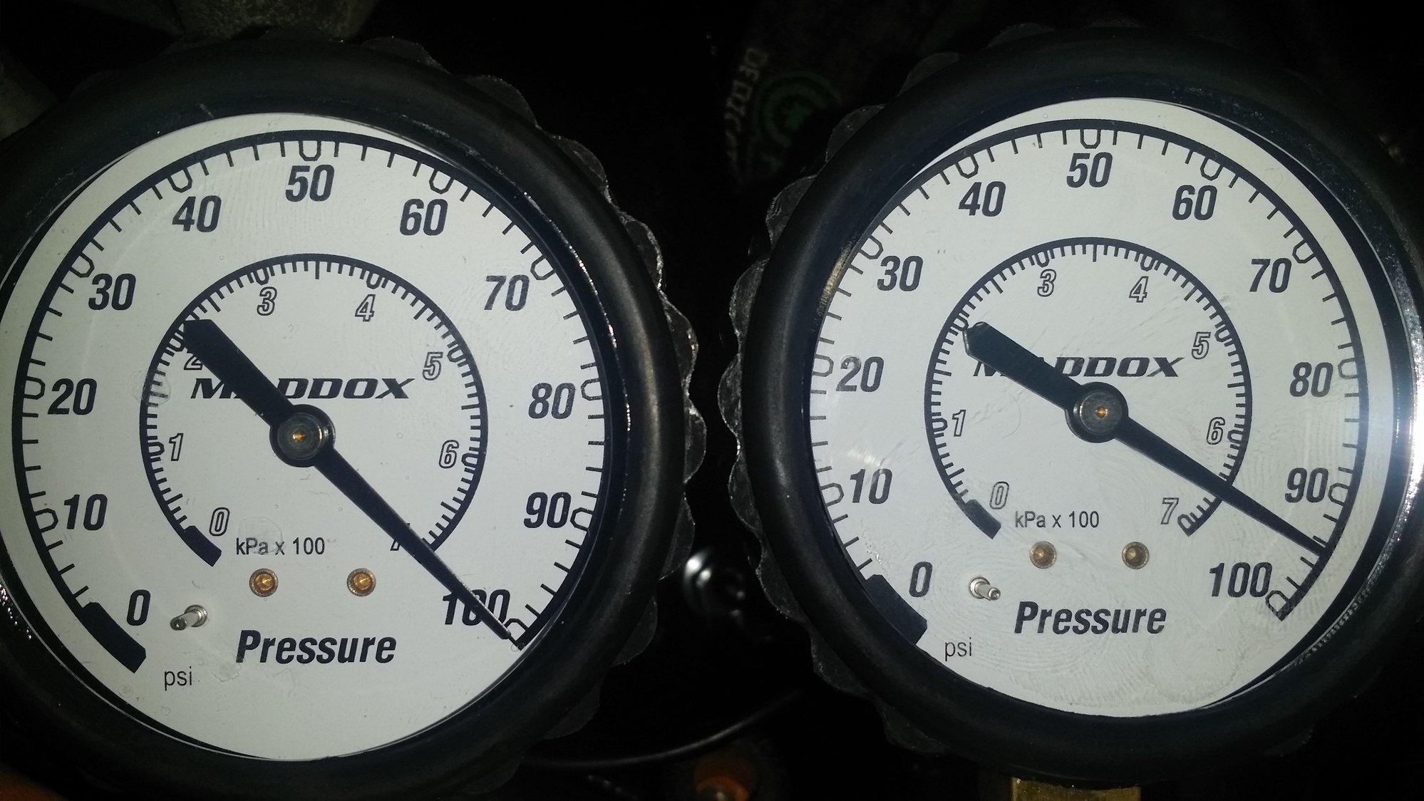

Pat Kelley calculator showed about 20 psi less than what it obtained cranking over.
Even after the engine had minimal run time, it also had very equal leakdown readings. Do I trust the actual %, not really but as a comparison between cylinders, I feel it provides a good basis to locating issues like a valve that is not sealing correctly, cracked ring, etc on an engine that has been in service for a while or a fresh build.
