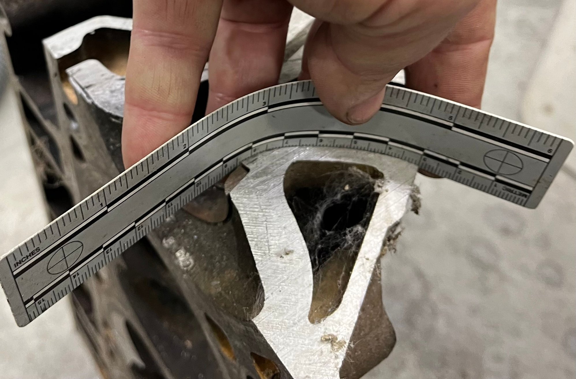

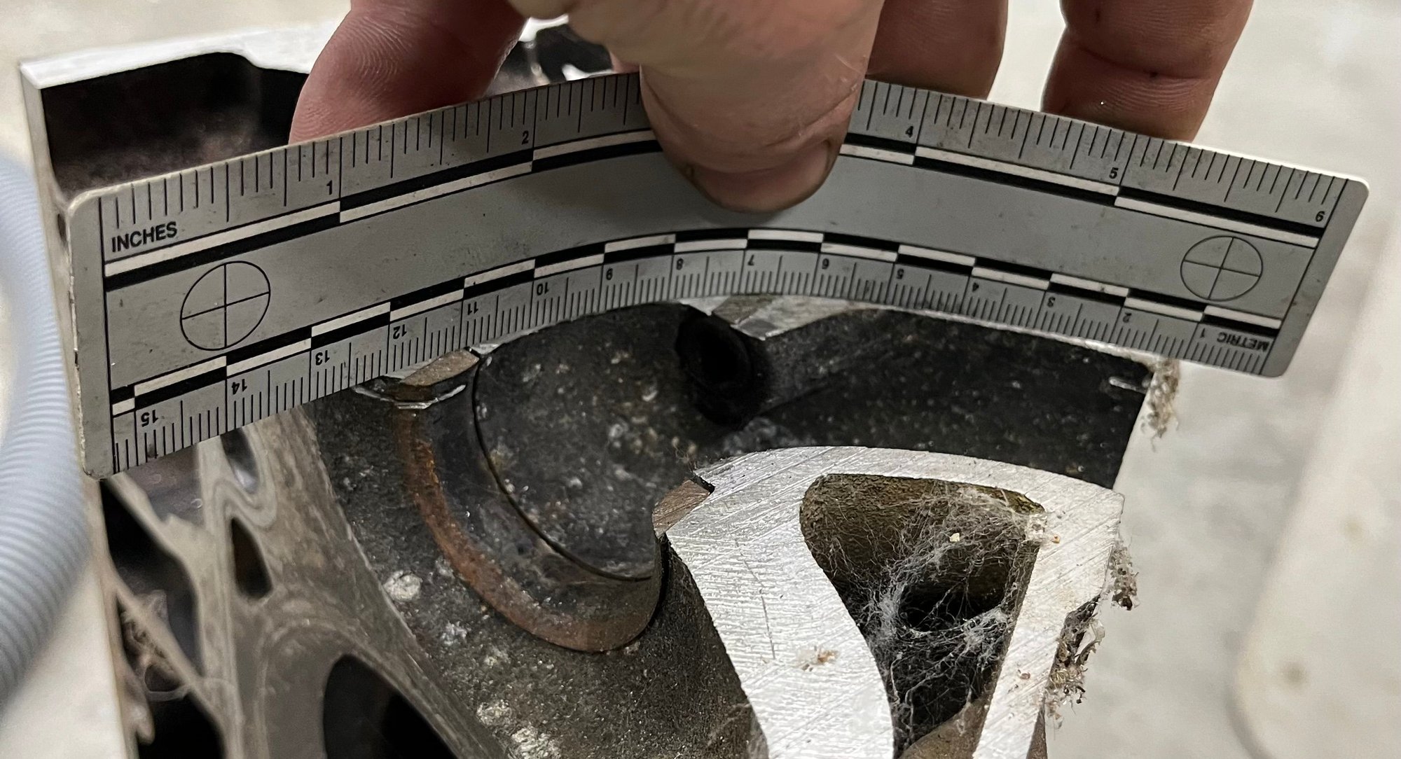

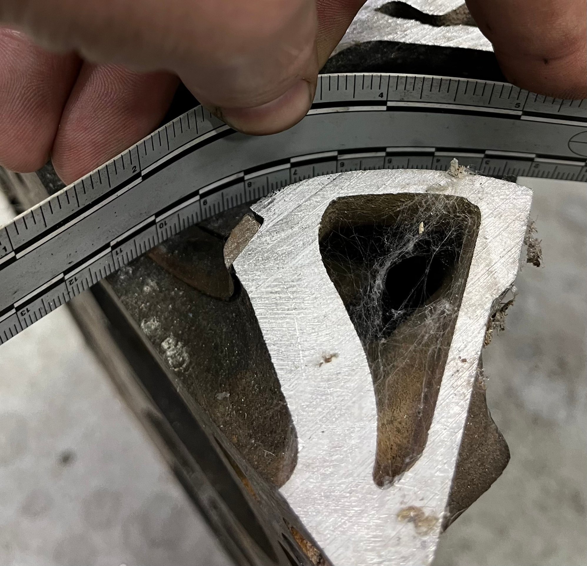

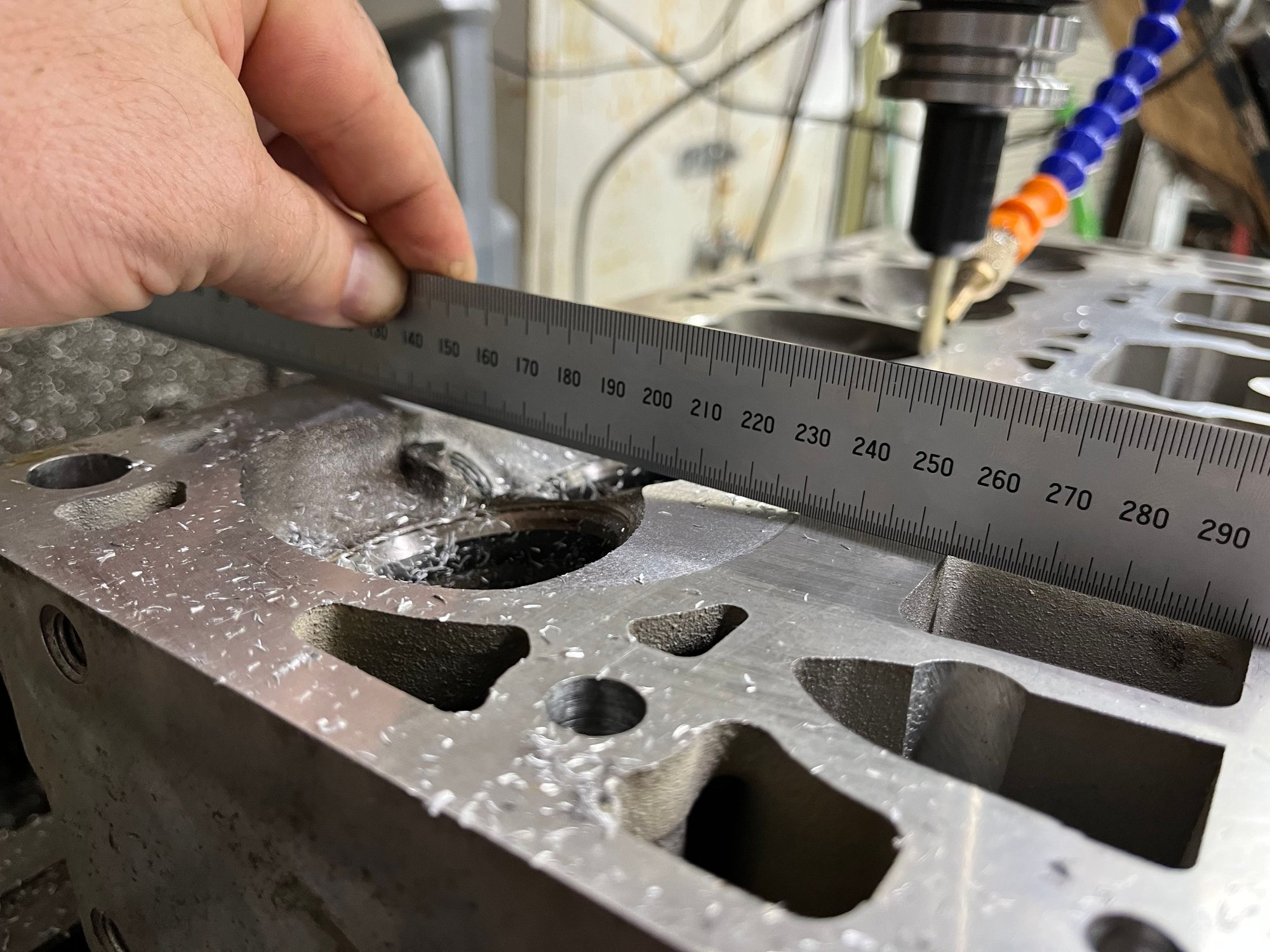

Can anyone tell me the intake port length for the 862/706 set of heads? I don't have a set I can measure offhand.

Here’s a 317 they’re basically the same

I had 5.85" saved, just wanted to double check.

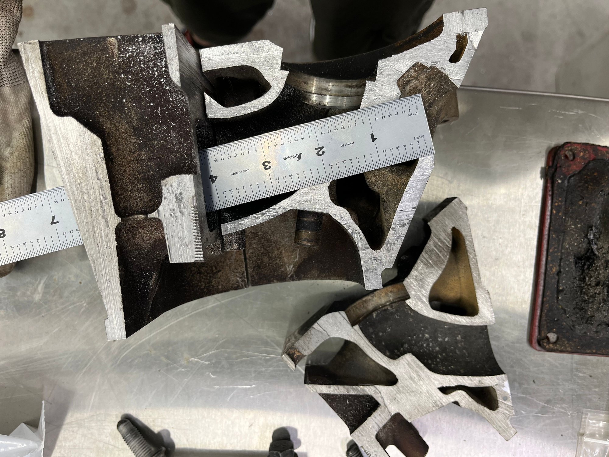

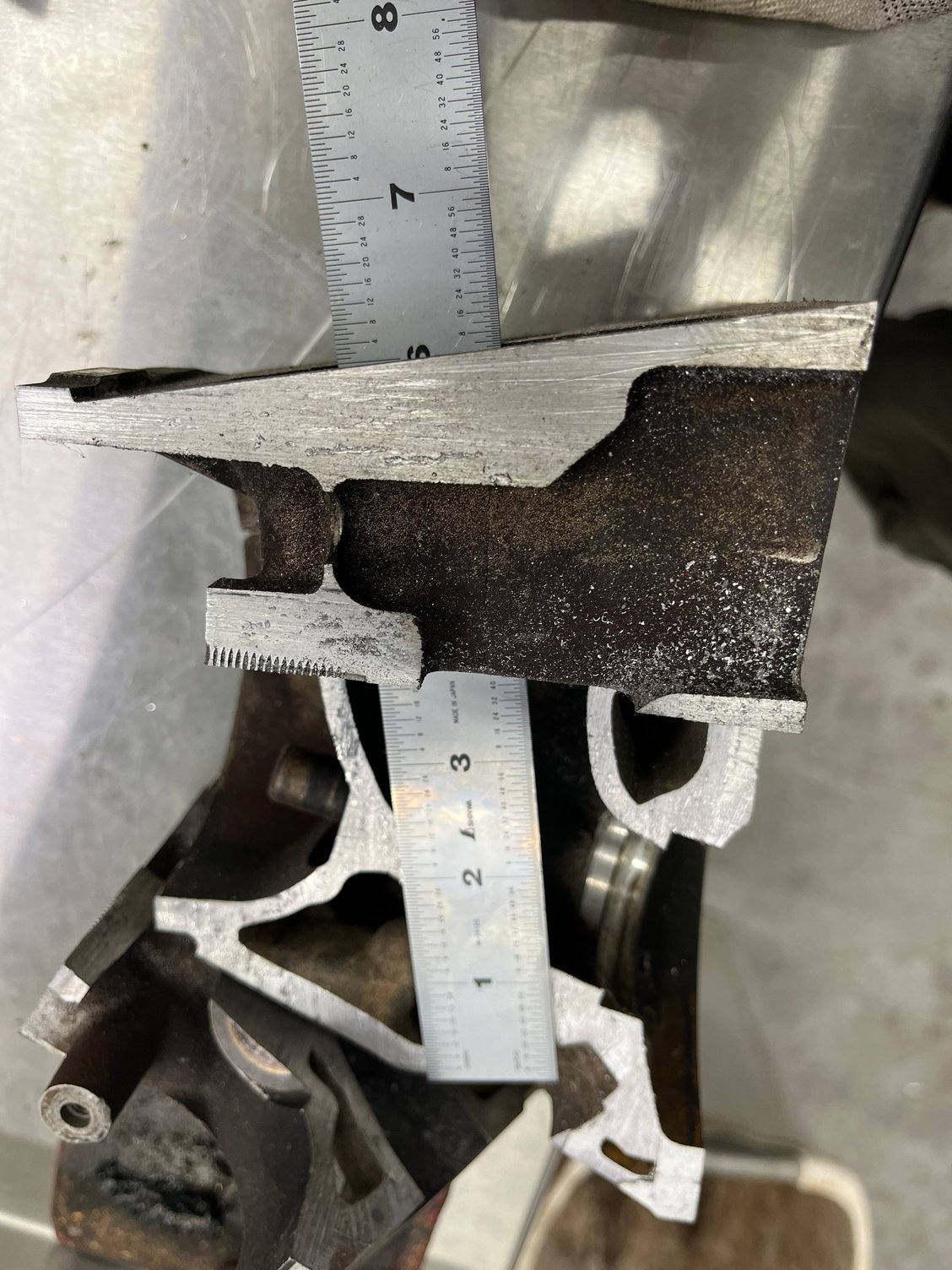

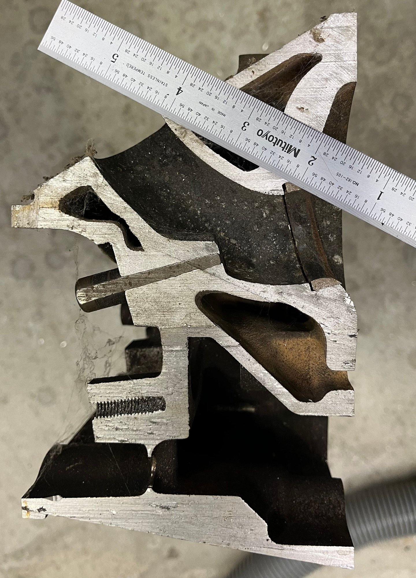

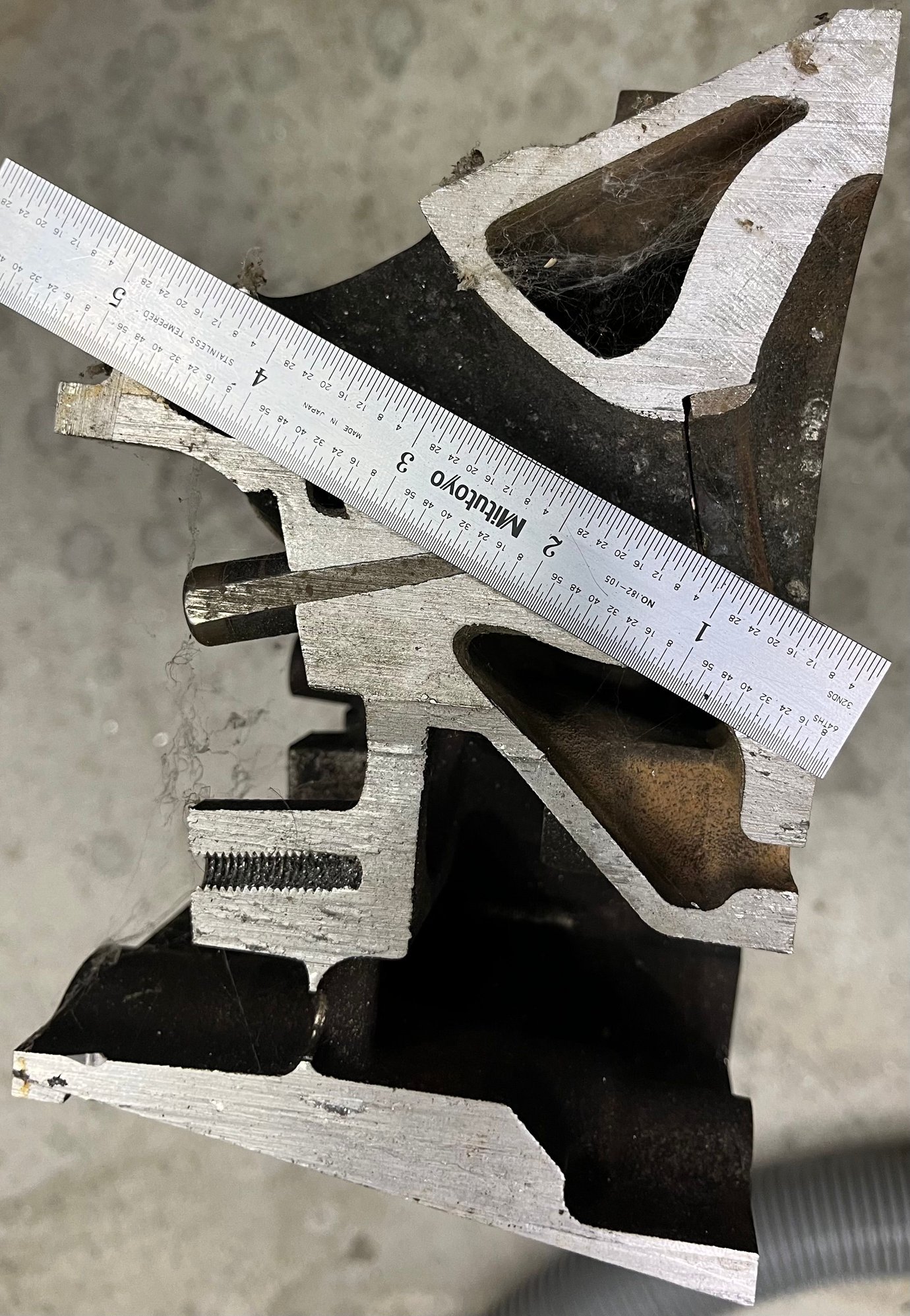

Could you take the same picture with that exhaust port?

Old Nov 5, 2023 | 09:49 PM
zenon222's Avatar
Joined: Nov 2023
Posts: 6
Awesome! Thanks!
