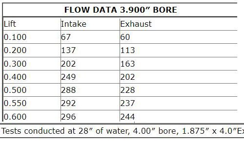

im ready to start a new build.. i built my forged 30 over 6.0 over ten years ago. i have a set of TEA CNC ported 241s on the engine now, running a original ASA cam. this time im looking to step up to a BTR stage 3 or Titan 5 cam.
im wondering how much im going to leave on the table if i stay with my current heads as opposed to the likes of TFS , AFR mongoose or even PRC 2.5s. im going to keep my LS6 intake , 36lb injectors and 78mm MAF for the time being.
the old setup made 393rwhp the way it is now with a Yank SS3600 and a Moser 12 .. some new opinions would be great. definitely staying N/A for this build.
heres the Flow #s on the TEA heads i have now

Nice setup. Honestly man, the biggest restriction I see is the ls6 intake setup. What are your ET and trap speeds? 393 could be a lot depending on the dyno. Those are really nice cylinder heads. I wouldn't bother changing them before I changed out the intake for a bigger one as it's holding the whole combo back already. Sure you could do a camshaft with more lift and more duration that would move the power up higher which is fine because you have a 3,600 stall but don't bother changing the cam without changing that intake. I think you'd be disappointed If you just change the camshaft.

It'll cost half as much to get a better flowing intake that will also take a 92mm throttle body and larger MAF, than throwing on brand new aftermarket heads that still have to breath through a 78mm throttle body.

Those heads are legit. Are they they best? Nope. Are they extremely soild? Yep.
I would update the cam because that cam is literally from 15 years ago and technology has come a long way. Then also as noted I would do a FAST90/90 style intake and TB set up. The LS6 is a good factory intake but on a nice HC set up like you will have, its definitely leaving power on the table.

If you're not going to upgrade the intake, then I don't see a lot of reason to upgrade the heads.

Combination is everything. You will never accidentally make big power numbers in this hobby. Gotta get the air in and then, you gotta help the engine get the air out. The LS6 intake is a terrific runner in stock form, matched with a 78mm tb, works great with good heads. Going with better heads gives you opportunity for more power, so why limit the opportunity with the LS6 intake?
