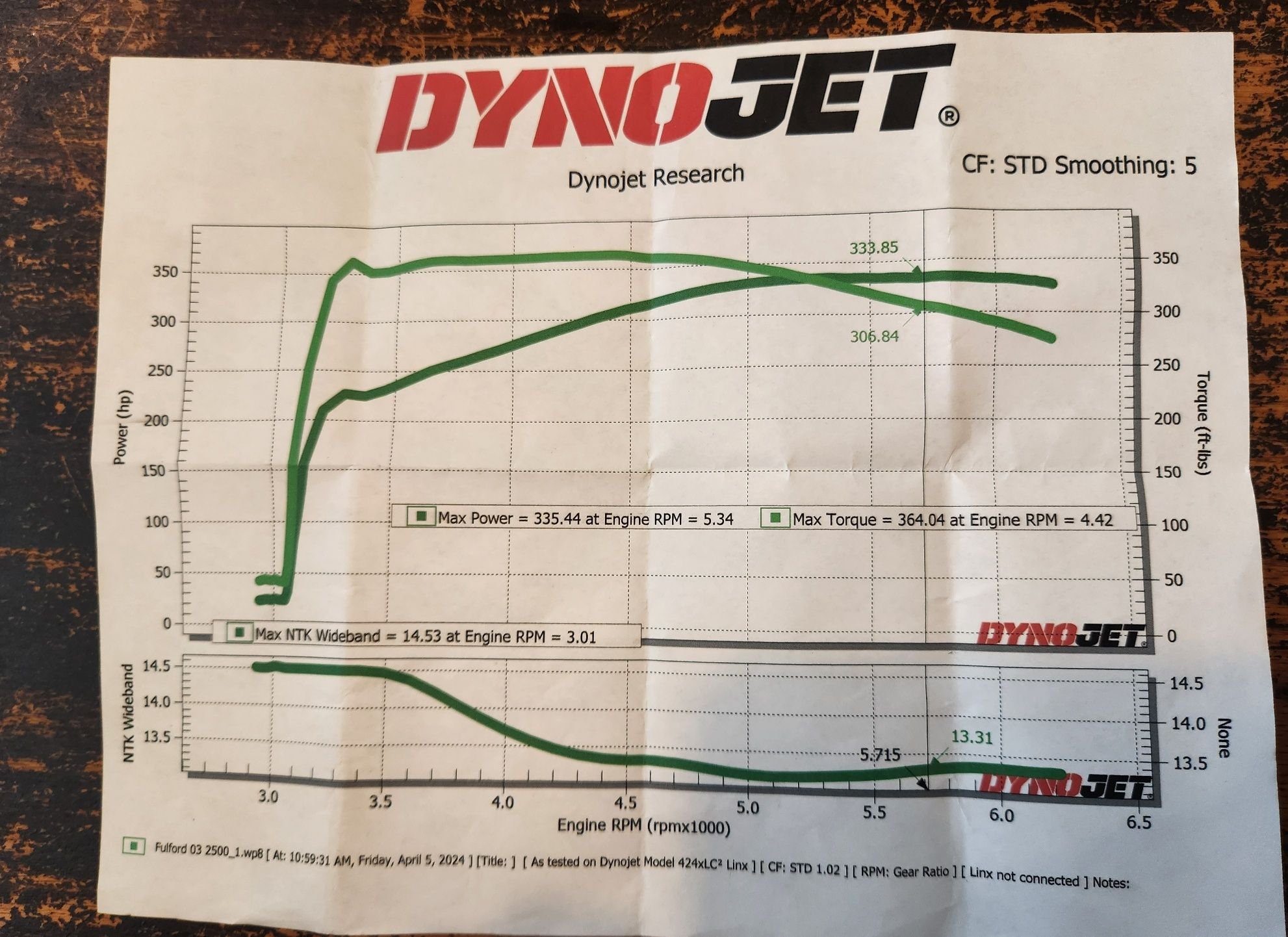

Here's my dyno run. Tuner wants me to go to 50 lb injectors.
jf

50 lb injectors installed. Tune loaded. Runs great and no more MISFIRES! Thanks for all the help here.
