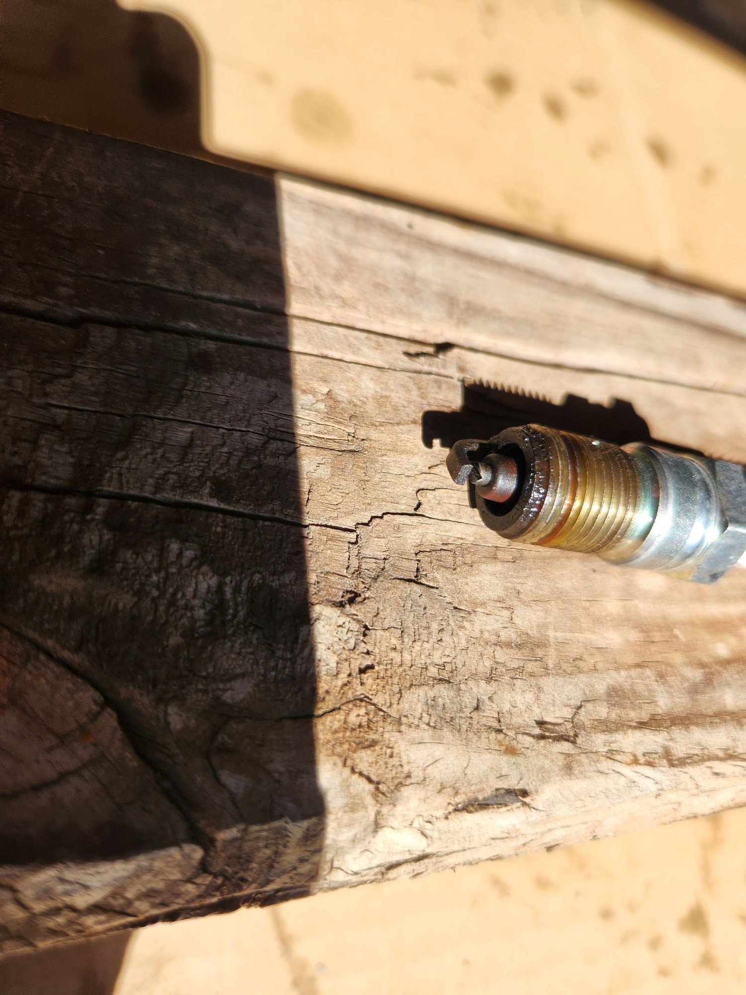

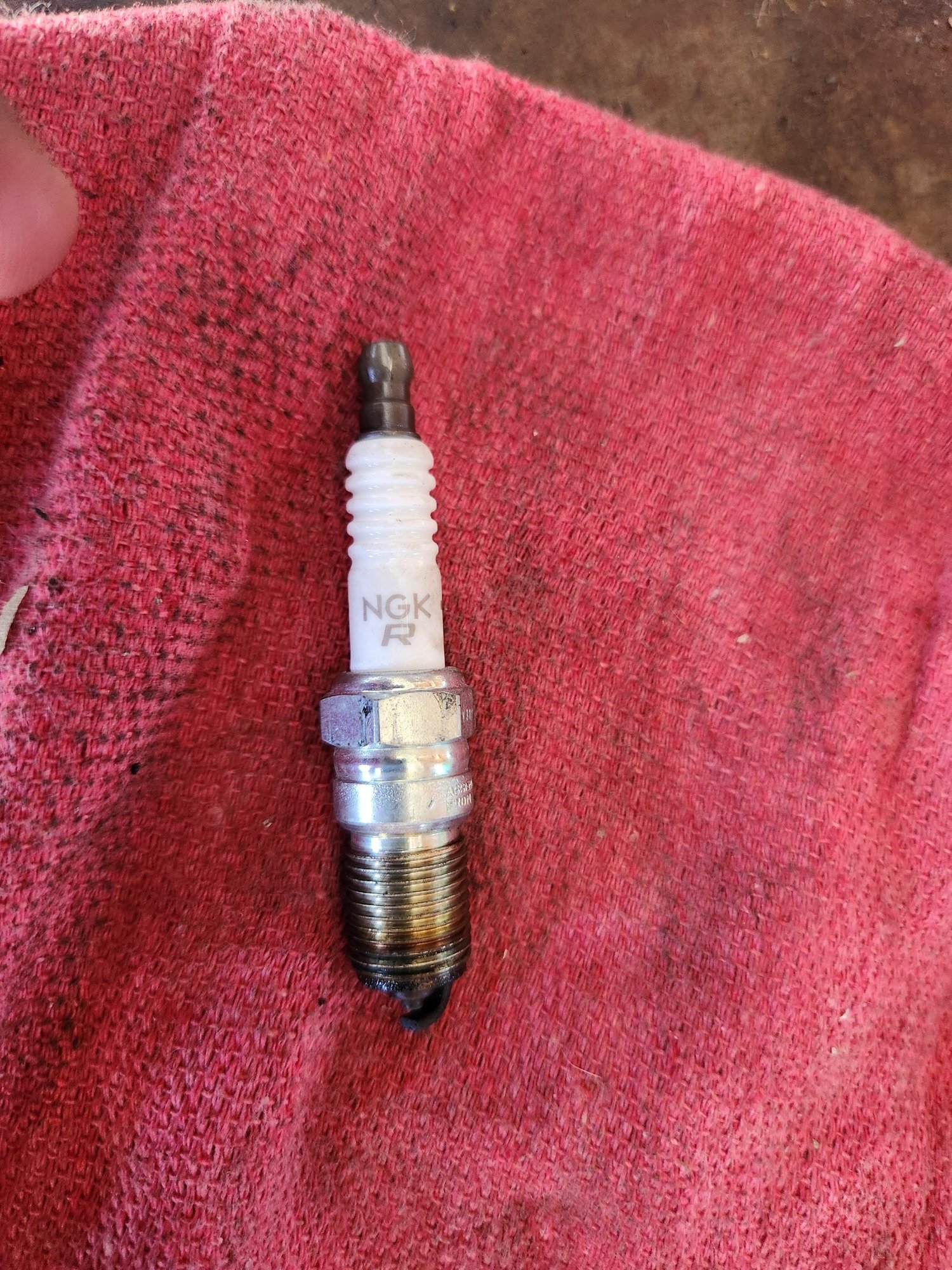

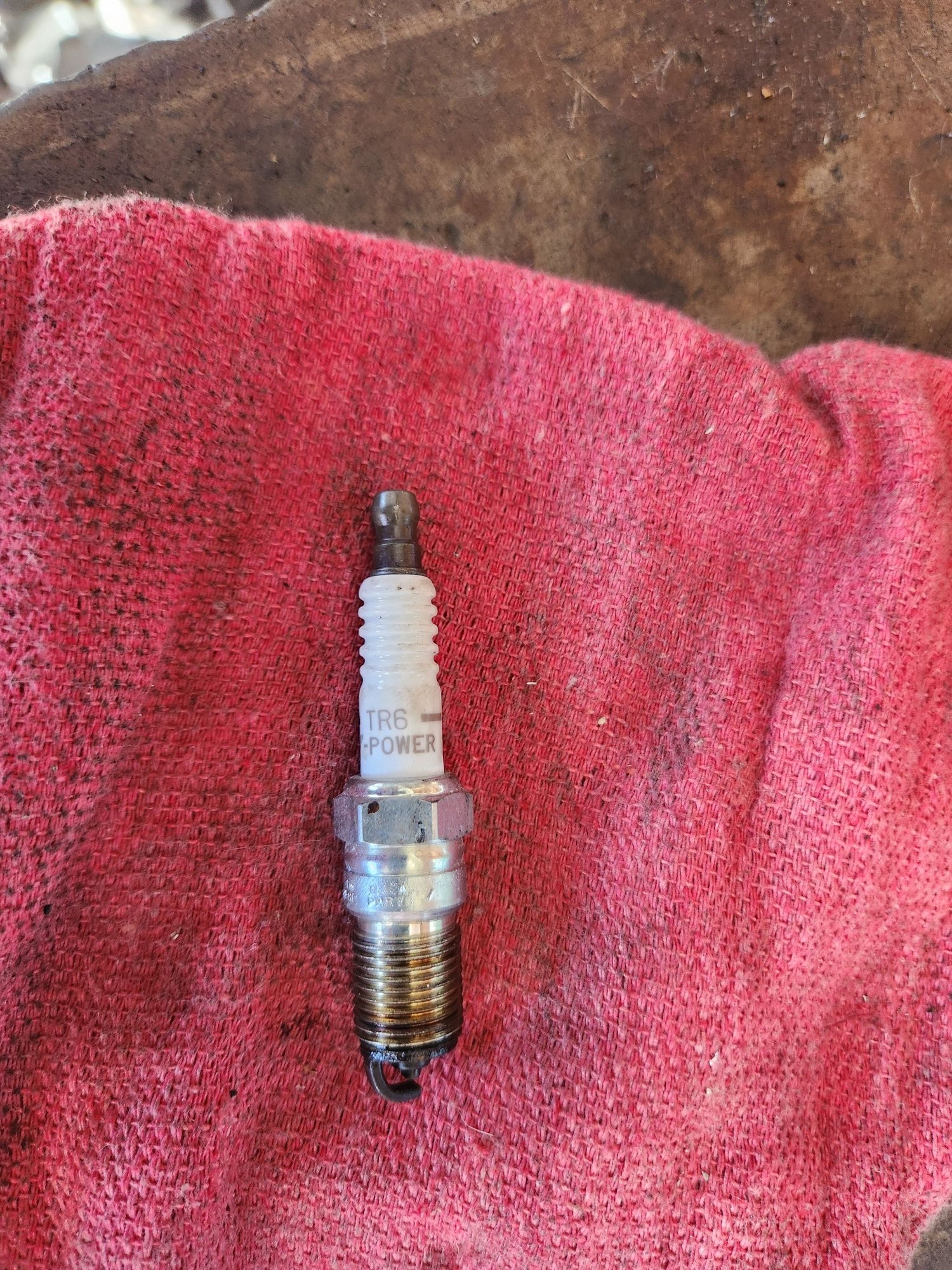

Here are the pics of a plug. Looks ok, but?
jeff

That looks like it's rich or burning oil.
Honestly that plug looks terrible.

Wouldn't hurt to go up a heat range and see if it clears up but that looks like oil there. Are you sure you're not having an issue with that cylinder?

I beileve that is #4. I don't believe so. Not sure about the oil. No hesitations, no burning, starts very fast, has plenty of power.

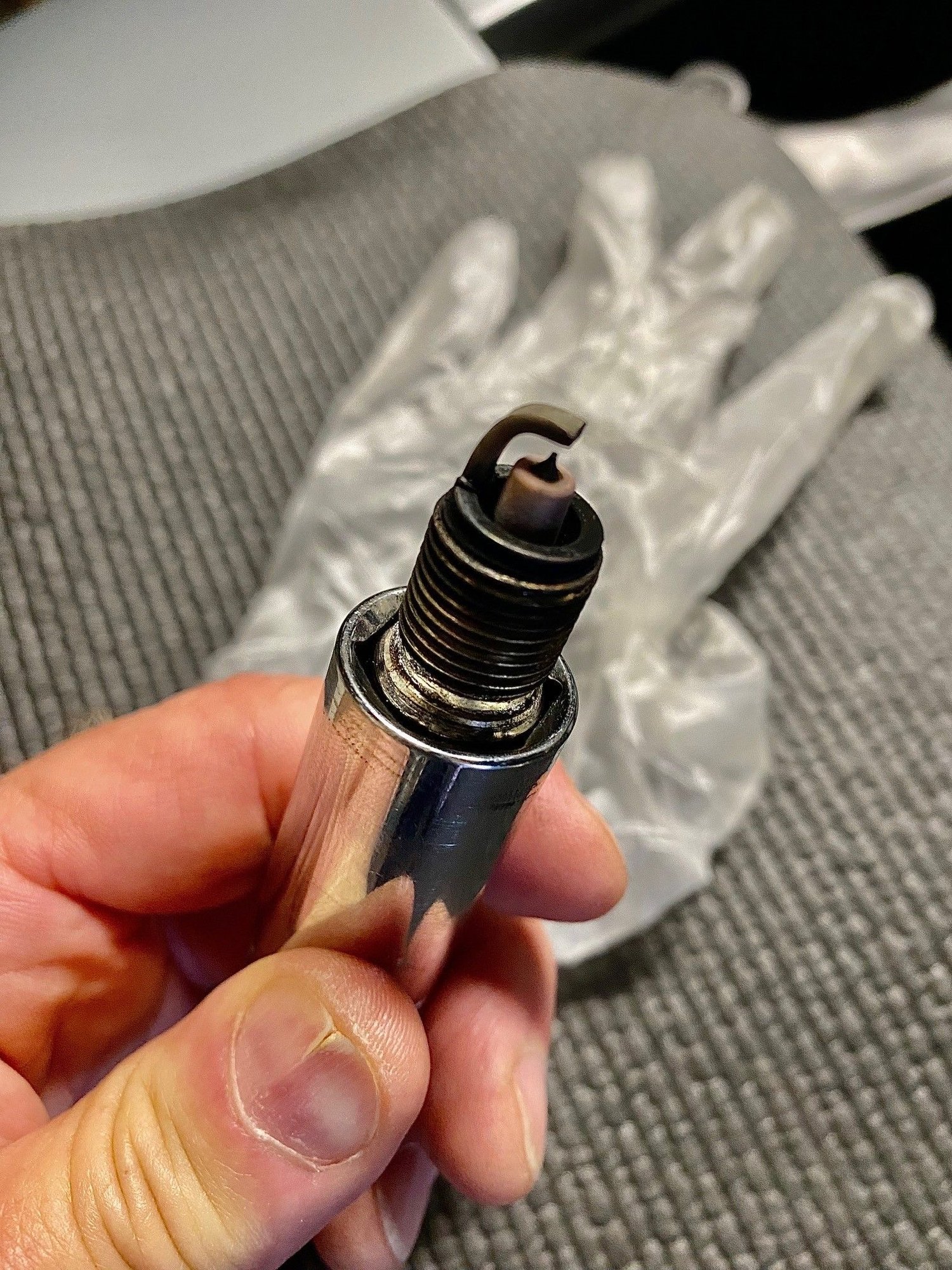

I would switch a injector from the offending side to the other side of the engine and see if fouling follows it. Another thing to check is the #4 cylinder valvetrain, pushrod, valve spring, rocker? Anything out of the ordinary.
I've attached a pic of one of my plugs so that you can compare. Greyish tan hue is what you're looking for.
