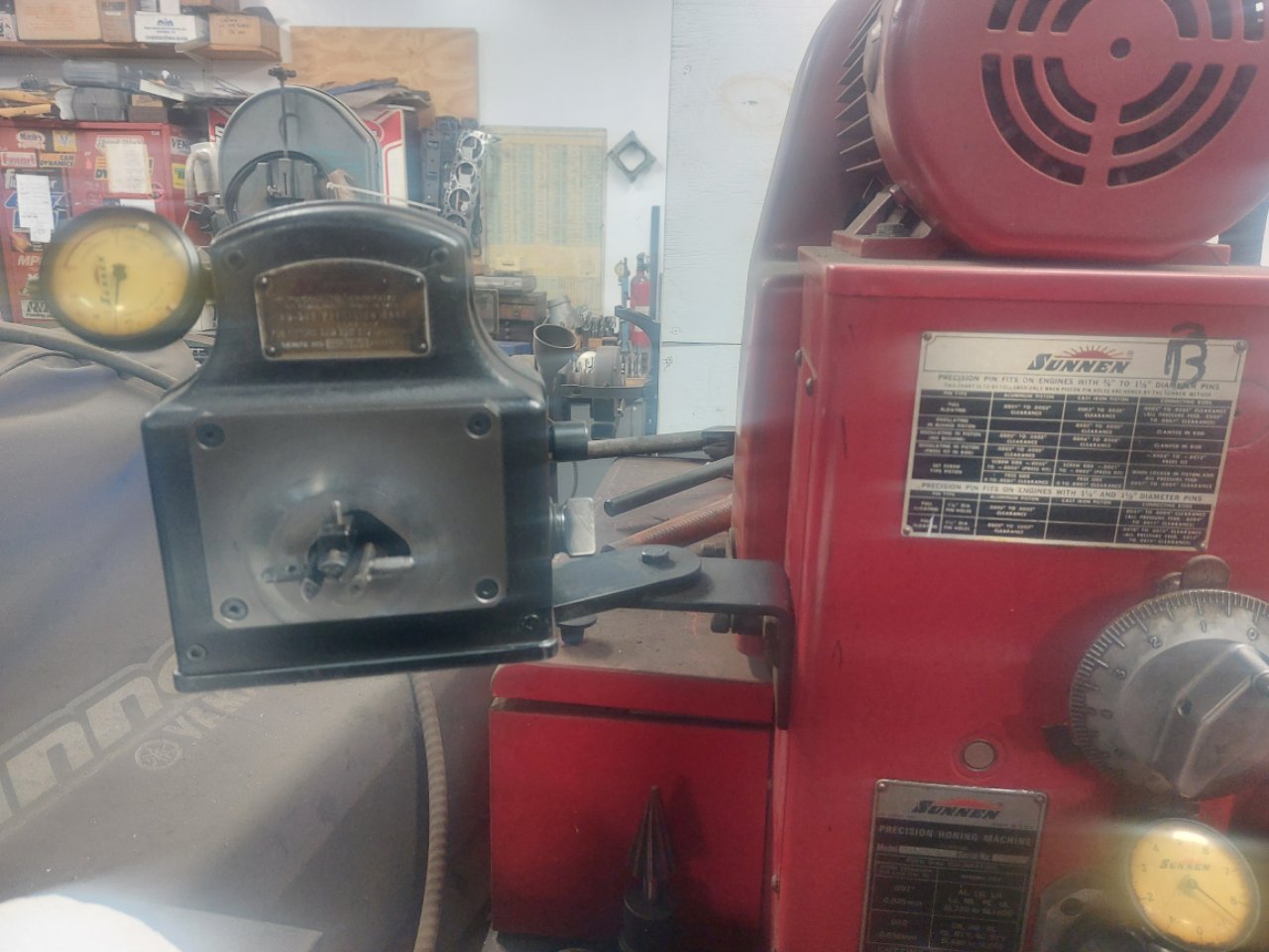

OK folks, I got to the shop to measure the rods.
The measurements were done on a Sunnen rod machine.
All rods measured about the same regardless of stock or APP bolts.
Every rod was just slightly wider at the parting line when compared to in-line with the rod.
There was no out of roundness or egging of the bore with either bolt.
As I already have the ARP bolts, I'm gonna use them. The stock GM bolts will be scrapped.

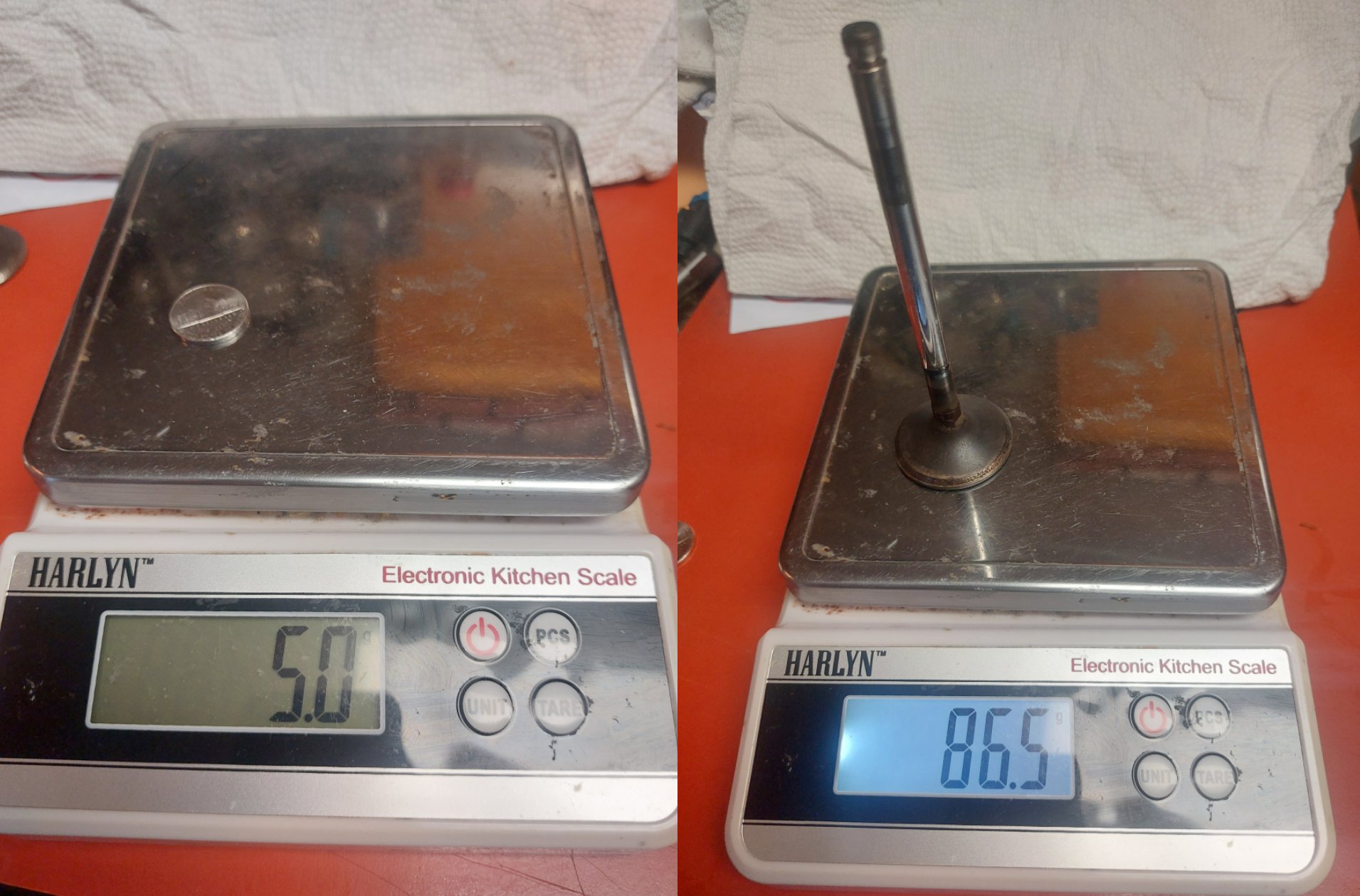

One question folks: How can I confirm the exhaust valves are the sodium filled version?
Paul, if you can accurately weigh the valves, post the weight in grams.

I used a US Nickle to confirm the accuracy of my scale. It's 5 grams.
The exhaust valve weighs 86.5 grams.

Those are not sodium filled valves. The sodium filled exhaust valves are right around 65 grams.
