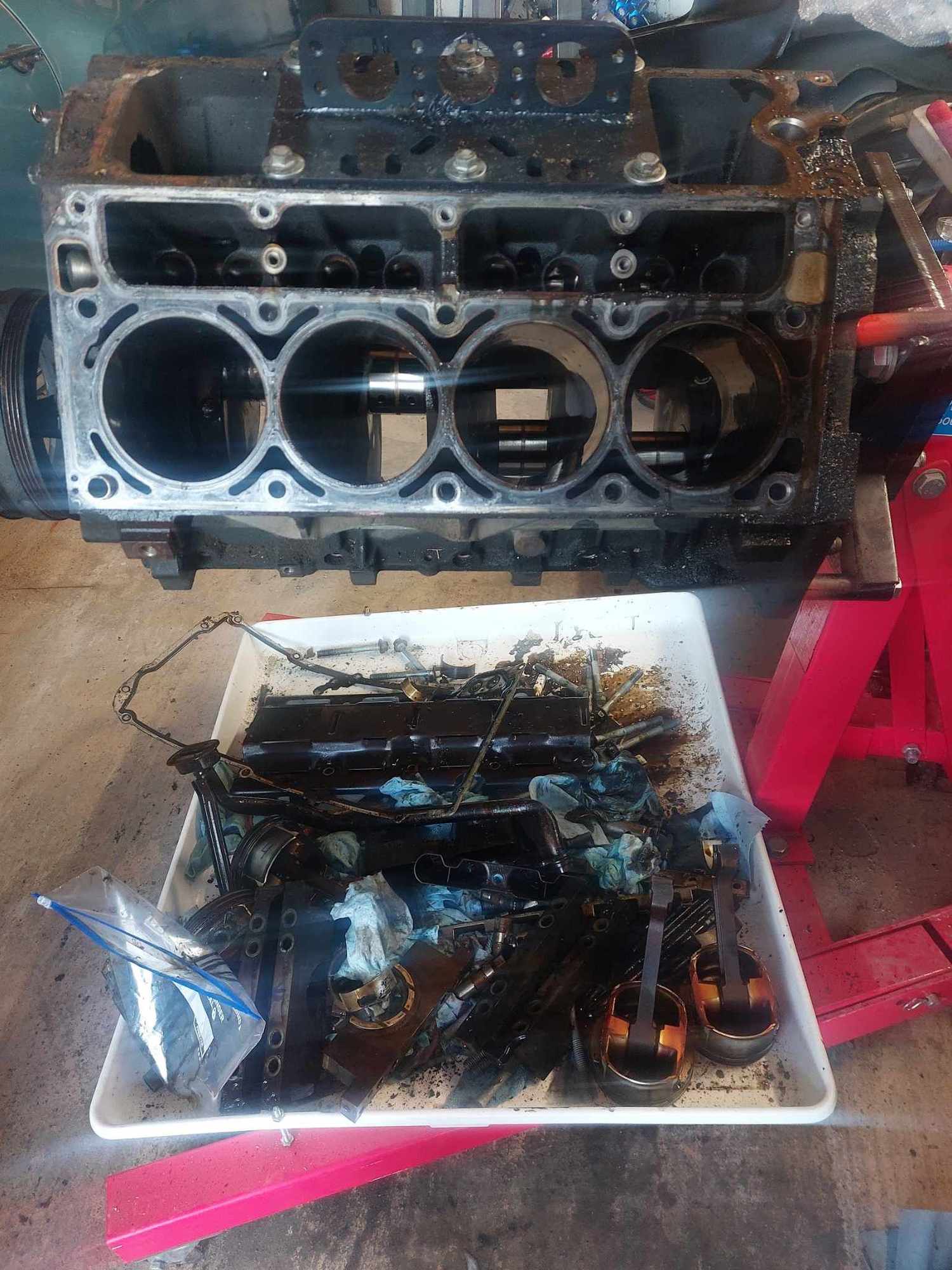

I have a 2006 3500 Express van I picked up pretty cheap. Full glass package, 6.0, 4L80E, 10-1/2" floating rear, which GM stopped using on these vans in 2011. Almost 300K on the clock, GM rebuilt transmission has 18K since installation. Exactly what I wanted.
Engine ran very poorly, wouldn’t rev up, no power at all. After exhausting every possible cause, yanked the motor for a rebuild.
Found a few collapsed lifters, one was missing it’s guts. Loosest timing chain I’ve ever seen. Two pistons had the rings locked in their grooves-collapsed rings? Looks like this engine was abused and didn’t have the oil changes it should have.
Bores look OK, crank looks OK, its getting a light polishing.
The plan:
Boring .030 over for flat top (LQ9) Sealed Power hypereutectic pistons, cleaned up rods and added ARP bolts. Fresh built 706 heads with LS6 springs. Summit Stage 1 truck cam, Morel LS7 lifters, BTR shaft rocker setup. Butler oil pump with O-ring seal to block, double O-ring barbell. Cloyes -.005 or -.010 True Roller timing chain. New front & rear covers, oil pan, tray & pickup. Hughes Performance flexplate, new stock damper.
I know I’ll need bigger than stock injectors but I’m still on the fence. Suggestions welcome.
Peripherals: Bigger 4 core radiator, Tru-Cool H7B coolers for oil & transmission, FlowKooler water pump, dual 16" Spal fans, new exhaust manifolds, head pipes/cats, new starter. New motor mounts.
