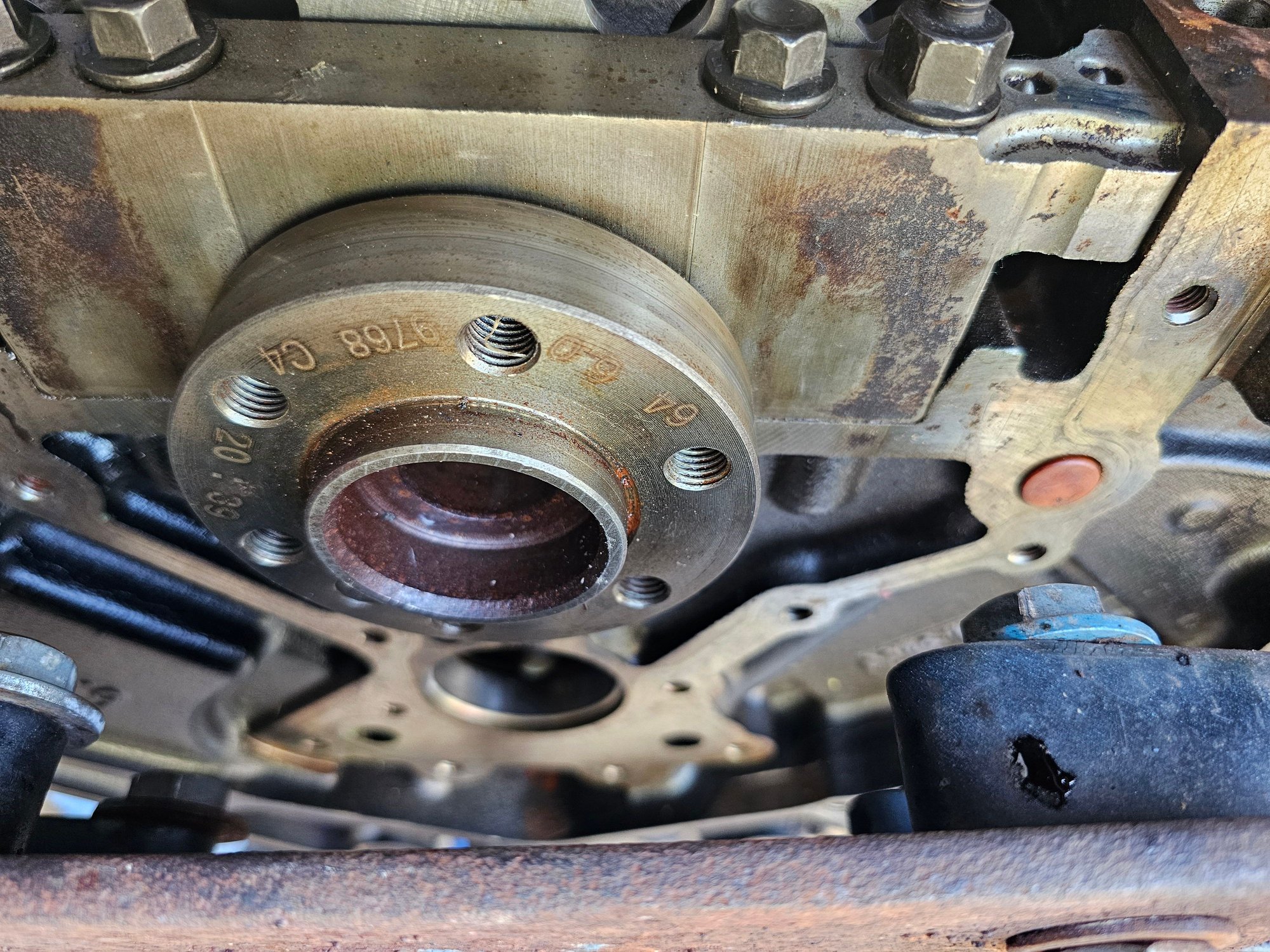

Here is my fully rebuild 6.0L. I have to remove the pistons to regap the rings for turbo. This rebuild its great work! Cant wait to get it in and running!
Hopefully this isn't the long crank that causes issues.

Putting 706 heads on a LQ4 is alot like how people used to put 396 heads on a 70s 454. Didn't flow near as well, but bumped up the compression a full point; and since the lack of flow only matters at high RPMs anyway, net-net it's a gain. With the cam you're using, the motor will never see the kind of RPMs and whatnot to where the better flow of the 317s really matters, so yeah.
Build a motor EITHER for n/a, OR for boost. Can't do both. It will only work well in AT BEST one or the other situation, and more likely, not in either. What you just did to your rings was a MISTAKE for n/a. I'd suggest taking it back apart, putting in new ones and gapping them right for n/a, use 706 heads, and FORGET about "boost" until the day comes that you're ready to do that; and then AND ONLY THEN build a motor FOR BOOST from the ground up.
