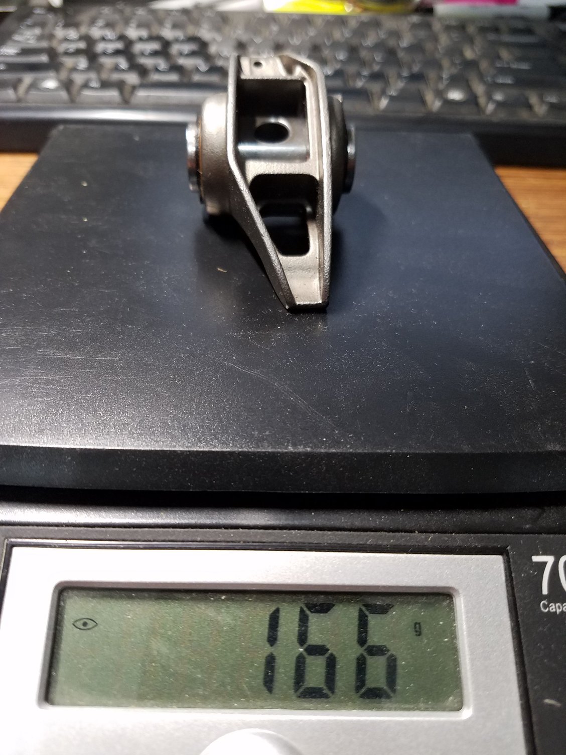

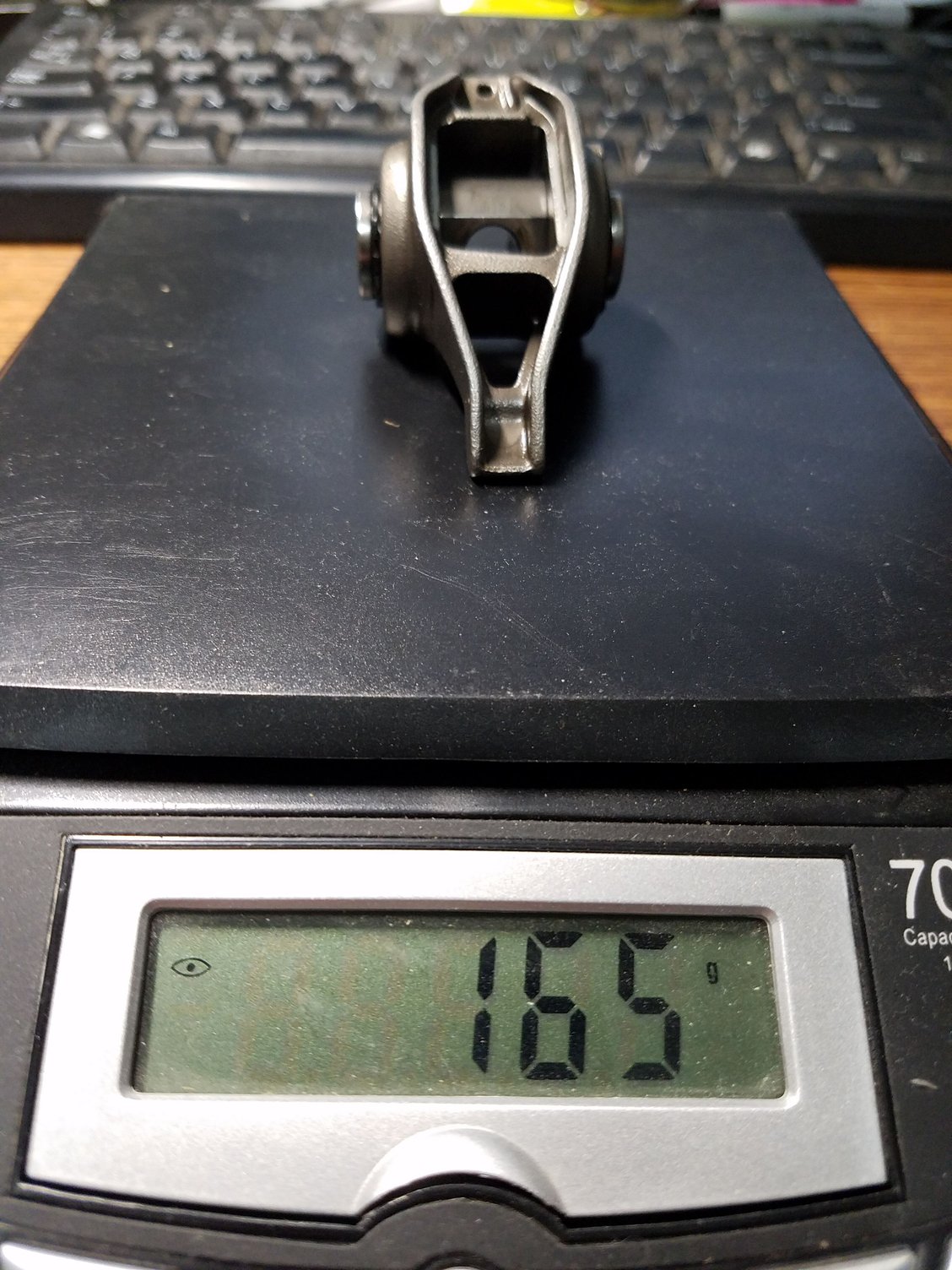

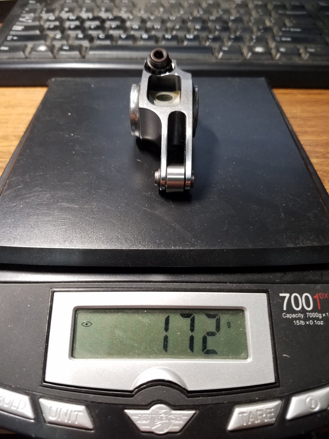

CamMotion 8620 core camshaft in my 01 SS. Brodix BR7 cylinder heads with PAC .660 lift springs. T&D billet adjustable roller rocker arms, Smith Brothers 3/8" pushrods and Johnson link bar style lifters. I installed the rocker arms and measureed for pushrod length at zero lash and ordered my PR's. I set the lifter preload at the rocker arm which is 1/2 turn from zero lash. No problems
Fast forward 6 yrs 9 mos...same springs on the heads. Car sees maybe 2K a year but after reading what Tony had to say I'm not starting it again until I get those springs swapped out. In case you're interested T&D makes a billet steel full adjustable roller rocker arm specifically desinged for the LS7 cylinder heads. I had a set but sent them back because they did not work on the Brodix heads. When I weighed them they were similar to the stock rocker arm with the bronze trunnions. Here's some pictures for comparison.
Steel is stonger than aluminum..Just sayin
