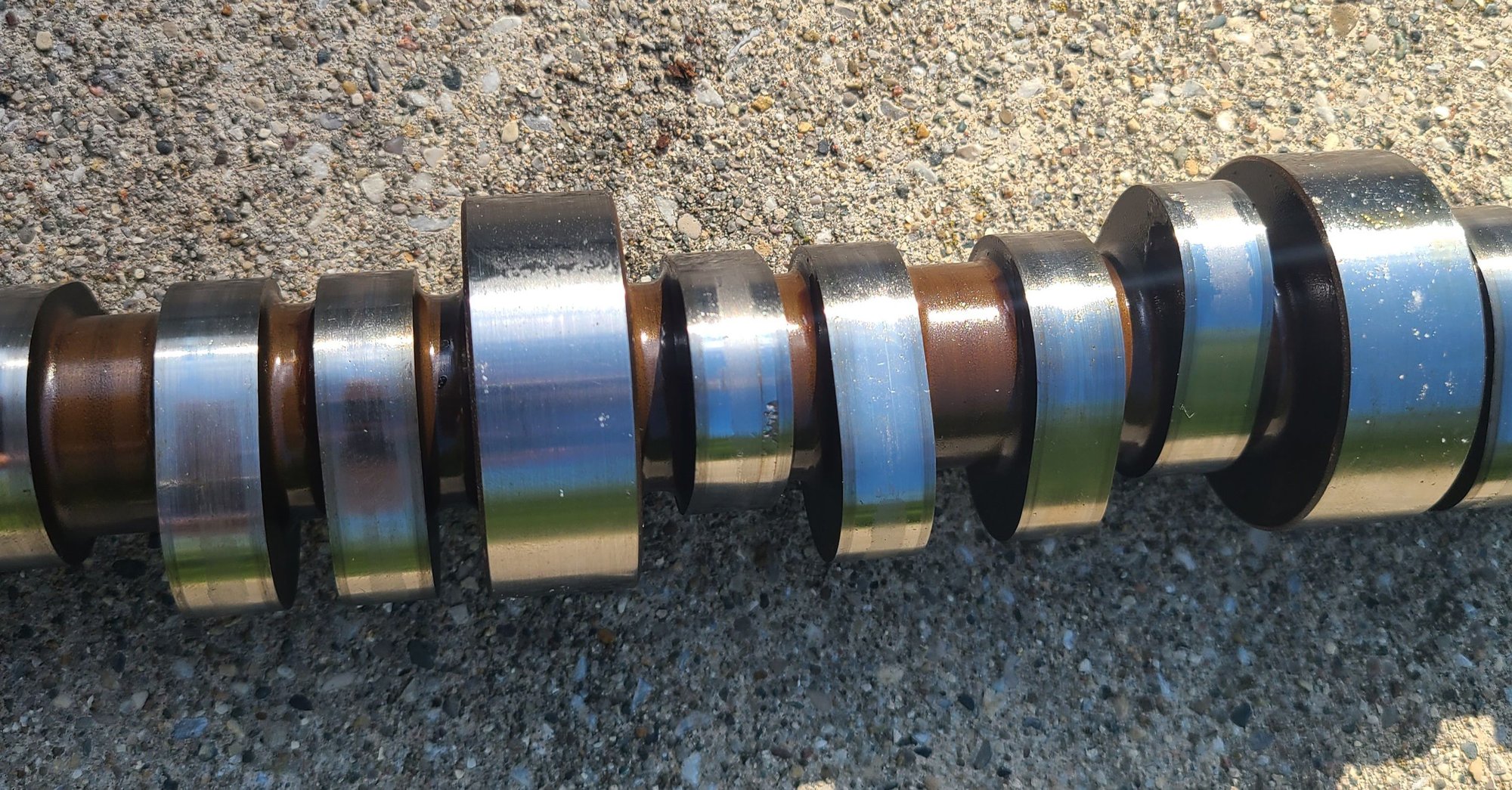

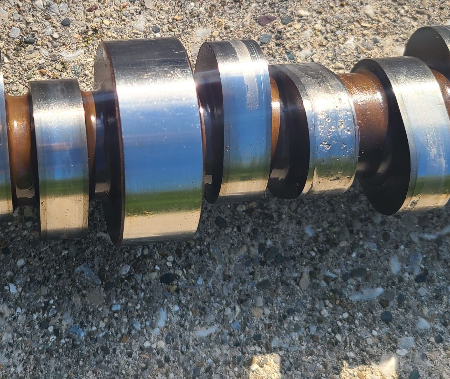

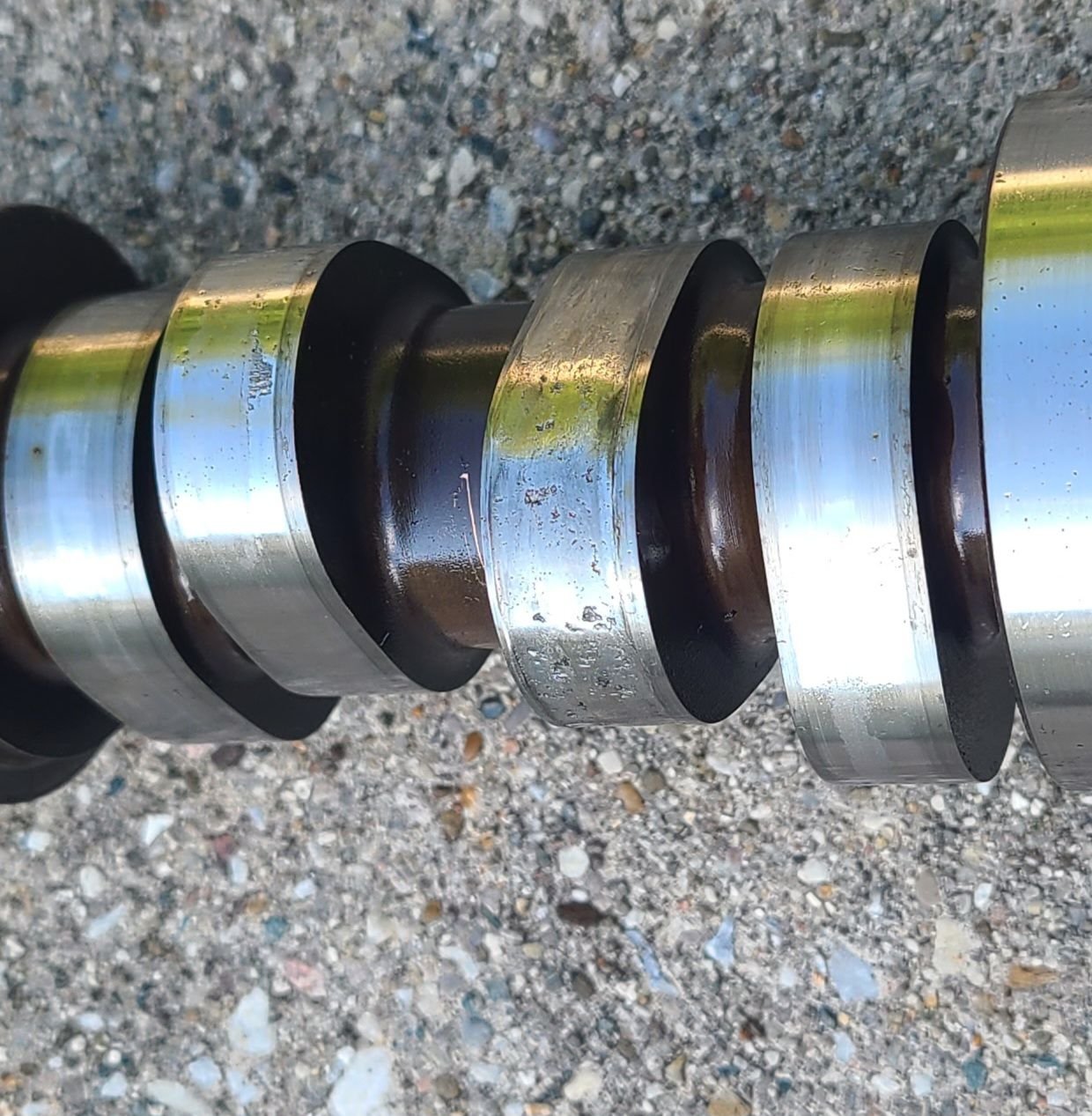

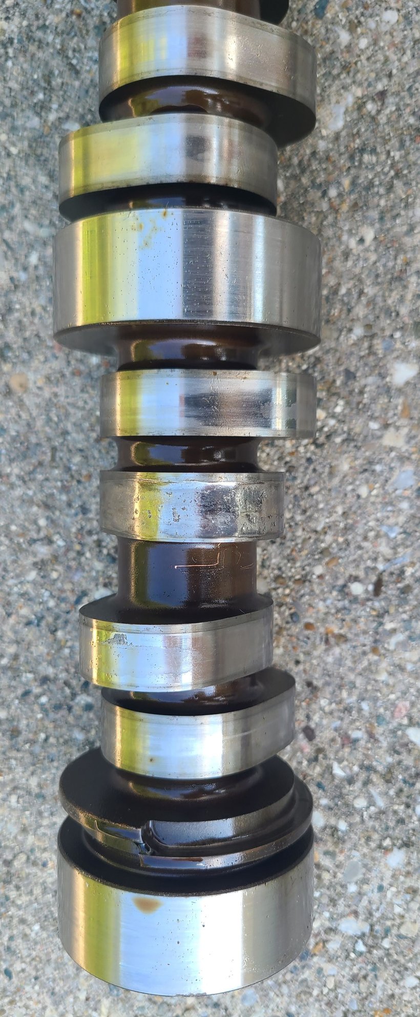

Guys, here's my pics from an hour ago. First 2 are of #8 Exhaust, the worst one by far.....
Interestingly, my first CM cammed engine had the one worn lobe at the rear of the cam. It wasn't the last lobe, but it was one of the last 3 or 4 lobes. Too long ago to remember which one. Also, BOTH engines used trays, which may, or may not, play a part. At 400lbs over the nose, they're seeing spring pressure around 100lbs over stock design. No lifters have ever turned, but have they oscillated due to spring pressure causing some small amount of flex in trays? IDK, don't have an answer. Here are the rest of the pics. 5 lobes (31.25%) show distress, with #8 the worst, by far.
Until I hardness test, I'm done posting. I just hope the hardness test isn't skewed by possible work hardening. May be a week or so before I have hardness results, as shop I worked at is a 65 mile round trip away, and I'll have to, uh, "sneak" the cam in for the testing.....

Yeah there's A BUNCH that are smoked, including "one of the last 3 or 4", as you described for the previous cam (which is kinda suspicious all on its own)... hardness #s should be interesting. Post em when you get em.

Possibly the same lobe going bad on 2 cams
