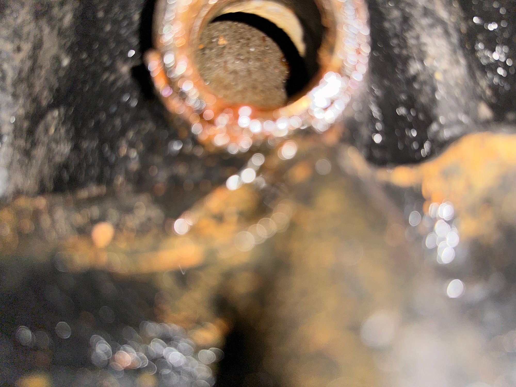

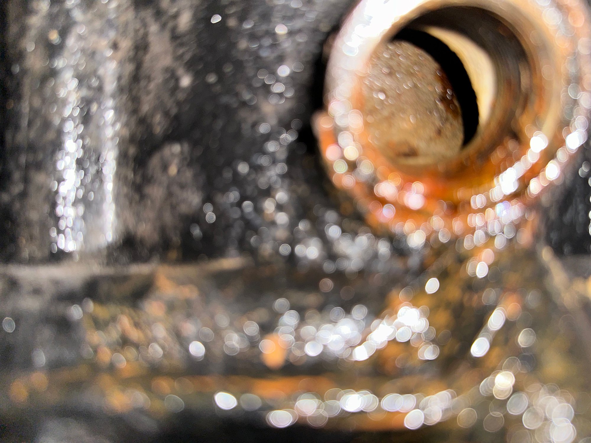

Anyone? I had to buy a 17mm Allen to get the driver side plug out but I did and water was still really dark brown. The motor is wedged up against a concrete wall so not a lot of room. I did get a pic of the coolant chamber. Judging but the color it looks fine. I guess I should fill it back up with a 50/50 mix and call it a
say?

Yes on the 50/50. Your pics looks like water only or really old anti freeze.

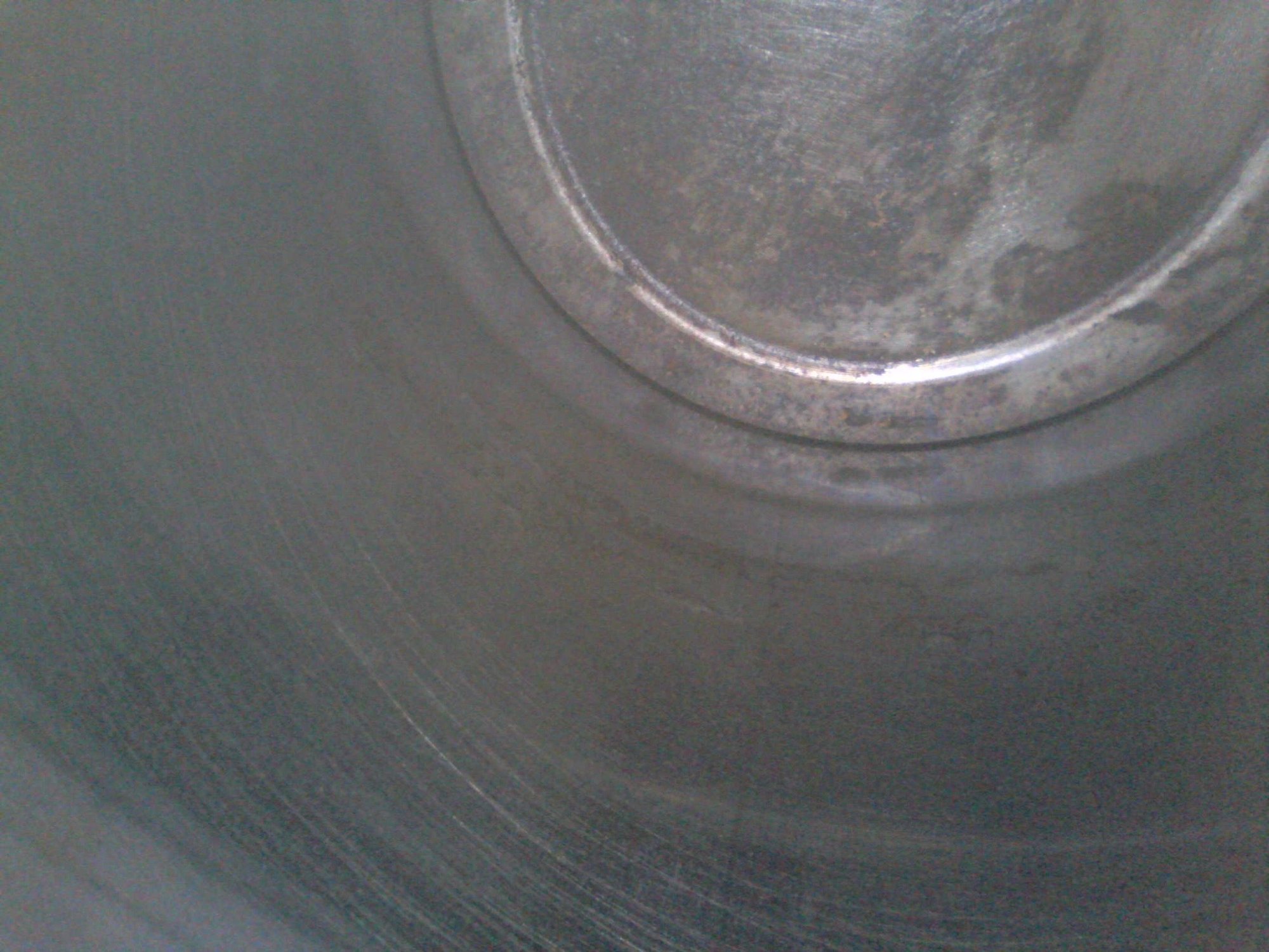

I decided to throw some coolant in it and then I used a small bore camera to take a look in the cylinders on the pass side (easy access). The cylinders look great and not showing any signs of rust. This engine has prob been sitting for 6 yrs minimum.
