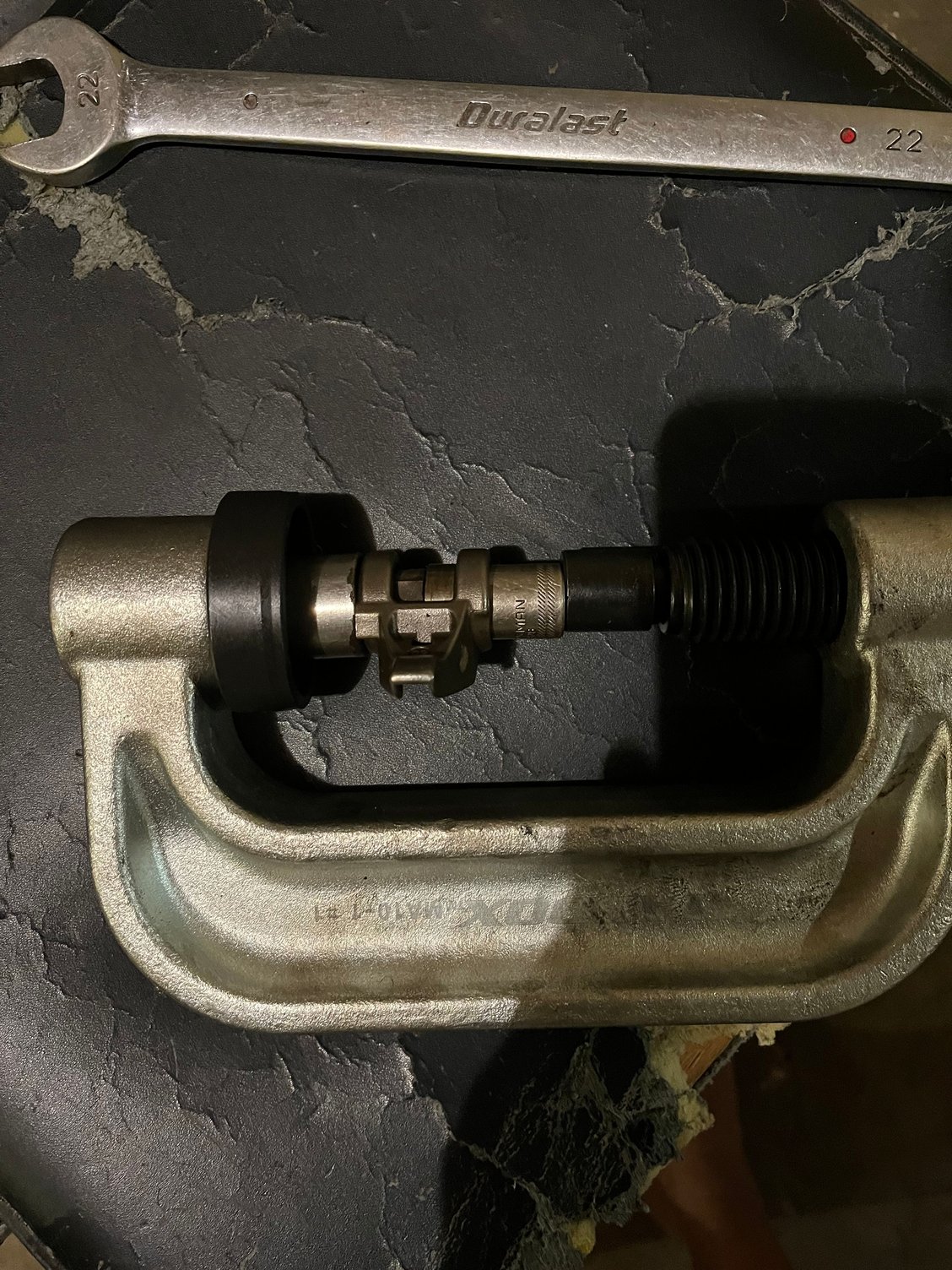

Brian Tooley LS1 Rocker Arm Trunion Kit 4.8 5.3 5.7 6.0 6.2 Trunnion - No bolts | eBay I found these for a reasonable price. Any special tools I'll need to press the old hardware out?
Is there a difference between these and the v2?
Better & easier with a Trunnion tool, but can be done with sockets and patience, just fiddly

Go to Harbor Freight and buy yourself a cheap arbor press. I got one specifically for doing trunnions and it makes quick work of it. I myself wouldn't use the V1 BTR kit. Not that it's bad, but there's a reason they have a V2 kit. Spend a little extra and have greater peace of mind. Also, watch out for fakes on eBay or Amazon. If it's significantly cheaper than you can get it from BTR directly for, it's probably too good to be true. This is a component I would NOT risk as a knockoff.

Im wondering if I can press using ball joint press kit and sockets?

I used my ball joint press and a couple of sockets it came out pretty easy.

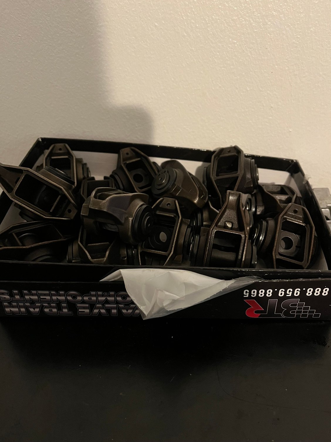

Update: Upgraded the rocker arms with the btr v2 truuion kit. Ordered the cheap amazon pr length checker should arrive by the weekend so I can get the PR length figured out.
Also can I re-use the rocker arm bar or does that have to be upgraded?
OEM bar is fine
