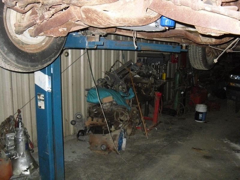

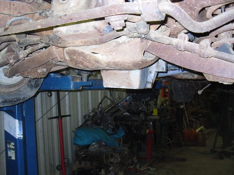

This is a truck pan on an A-body...
F-body pan...
He could raise it to get enough ground clearance...but I suspect you wouldn't be able to close the hood even with the lowest profile intake you could find.

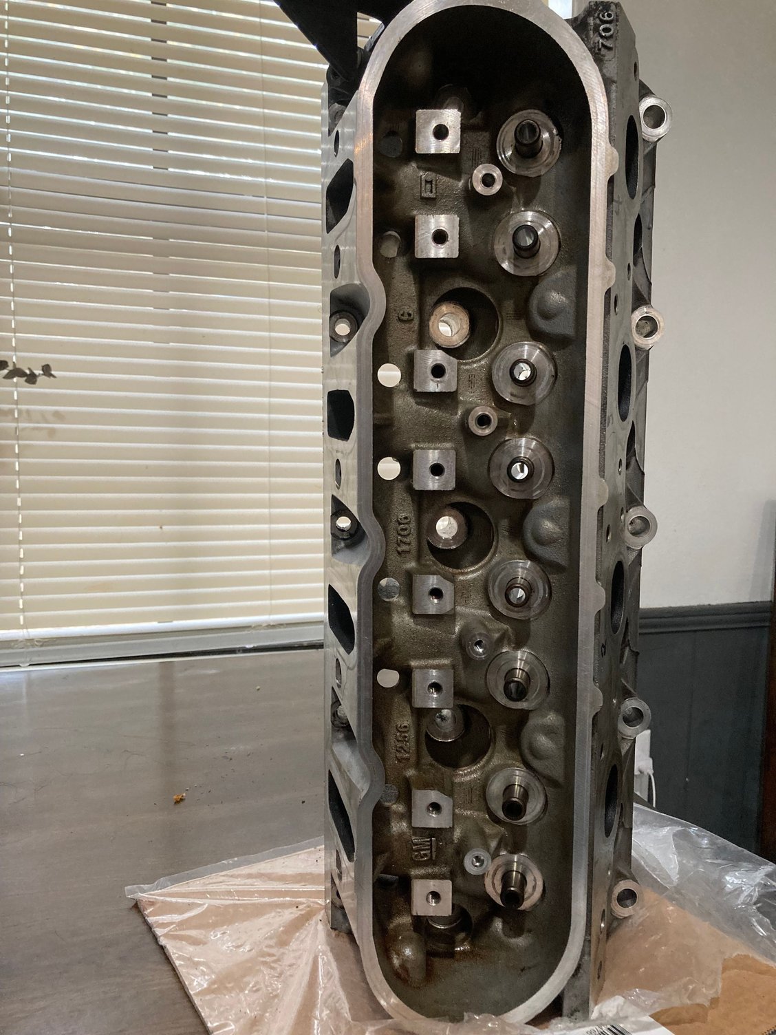

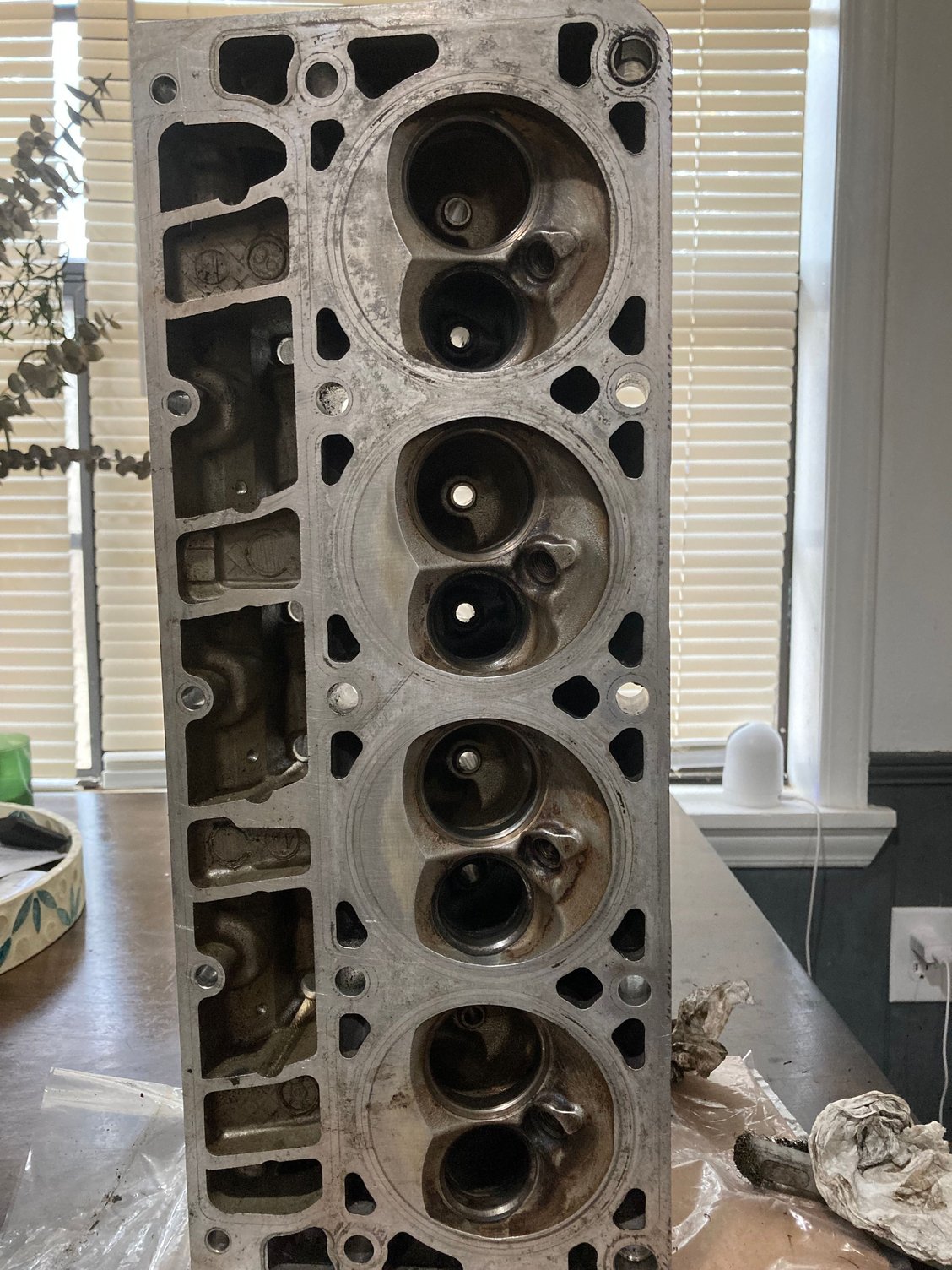

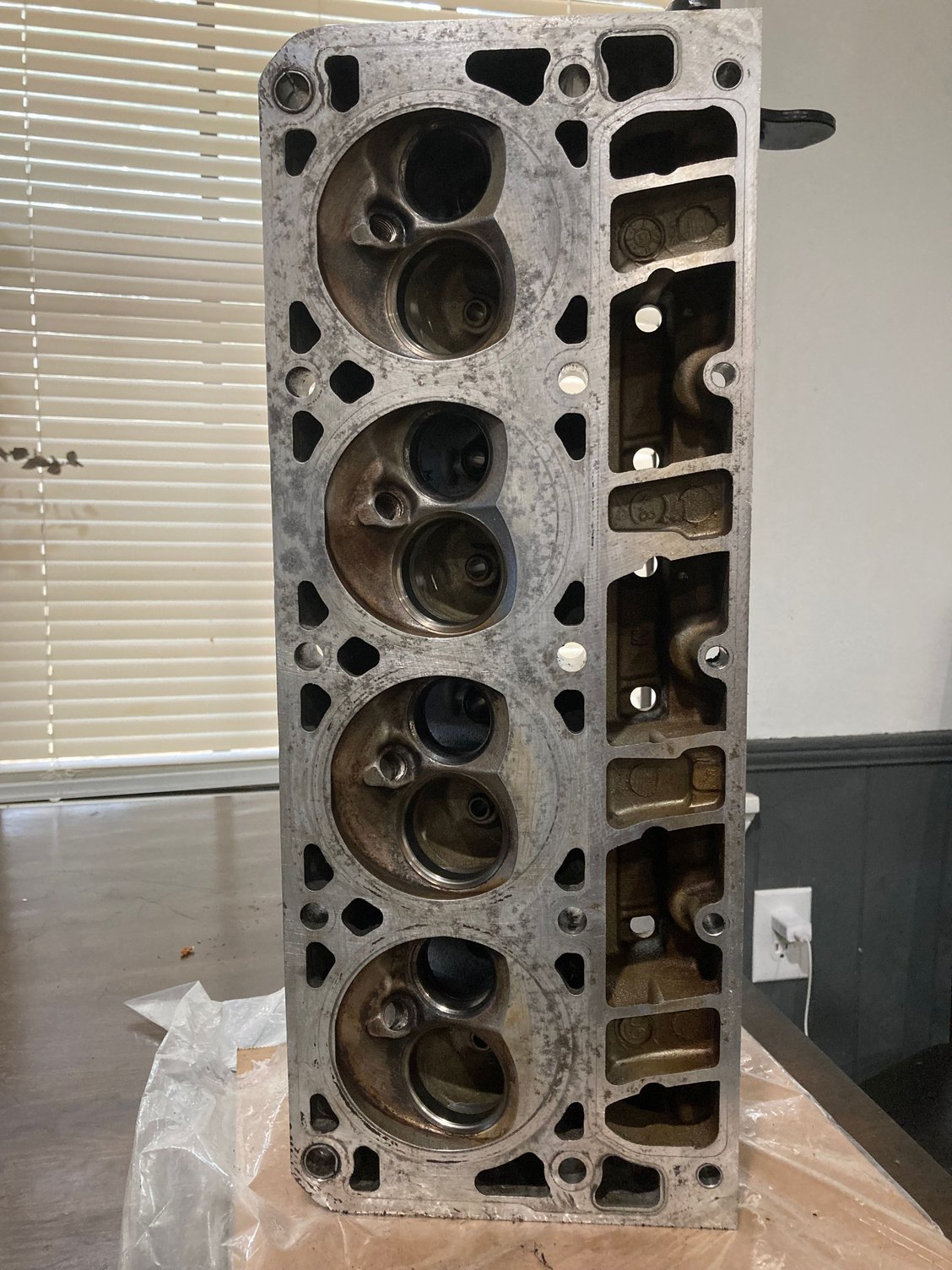

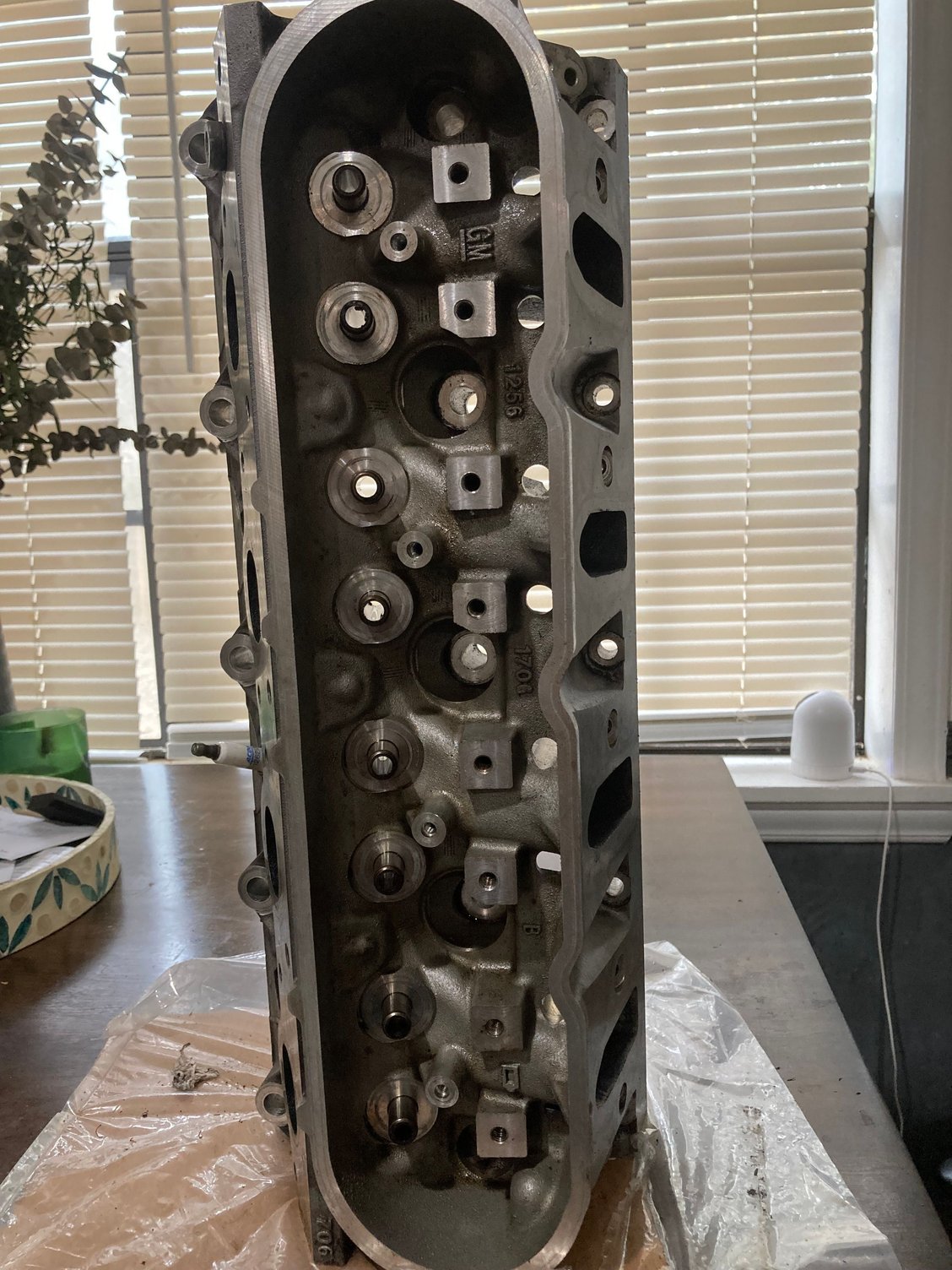

Started working on the cylinder heads last weekend. Got them all cleaned up and got all the valves and springs removed. The heads were pretty clean after using some brake cleaner on them but after letting them sit for a couple of weeks I see there is some type of oxation or something. Other than that I inspected the head and couldnt find any cracks in them so I think I may can get away with dropping them off at the machine shop. I am also on the hunt for some .600 lift valve springs that are not too pricey. Also can the valve spring retainers and keepers be re-used??
