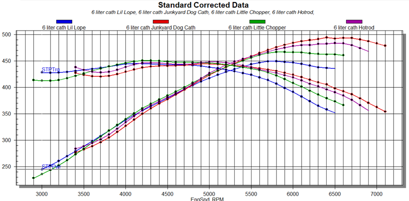

I see a lot of people running the choppy idle, torque oriented cams like the Chopa and Truck Norris type cams. Many of these people are using them in applications where they may not be the best choice. For example, they have a 3000+ stall and good gears, yet still run these smaller cams. Here is a comparison of 4 cams and here is their specs:
Lil Lope - 216/224 - 108+3 .553"
Little Chopper - 222/232 - 108+3 .595"
HotRod - 227/237 - 111+4 .595"
Junkyard Dog - 232/244 - 111+4 .621"
This little cams really shine below 4000 RPM at WOT. At part throttle and driving around, the response will probably feel peppy in the little cams. But, above 4000 at WOT, the bigger cams take over.

that's an awesome chart. Did you put that together, or where did you get it from?
I have a manual, which is a big part of the reason I was thinking of using a cam along the lines of the little lope. That cam along with truck norris, chopacabra, and big torkinator all perform very similarly.
If I had an auto, I could use a 3000 or 3500 stall and a bigger cam. I have my gtos stock 3.46 gears and don't plan on upgrading them unless I blew the rear. This is a street car and I love my stock cams low end torque and street manners so I think the smaller cams make sense. With the chopacabra 6.0 or little chopper, I would be exchanging 15lbft of torque down low for 15hp up top, but I would be adding 6 degrees of overlap to wind up at an overlap of 8 for the 6.0 chopa or 11 for the chopper. There is the 6.2 chopa with the same lift and lsa but 216/230. Might be good for ported heads but I don't think that duration is needed for standard 241 heads. That comes in at 7 overlap.

These are dyno graphs are from when I was doing some cam testing for Cam Motion several years back. Bobby, the winner of the camshaft contest, and Dr Tune Em' All helped with the testing.
