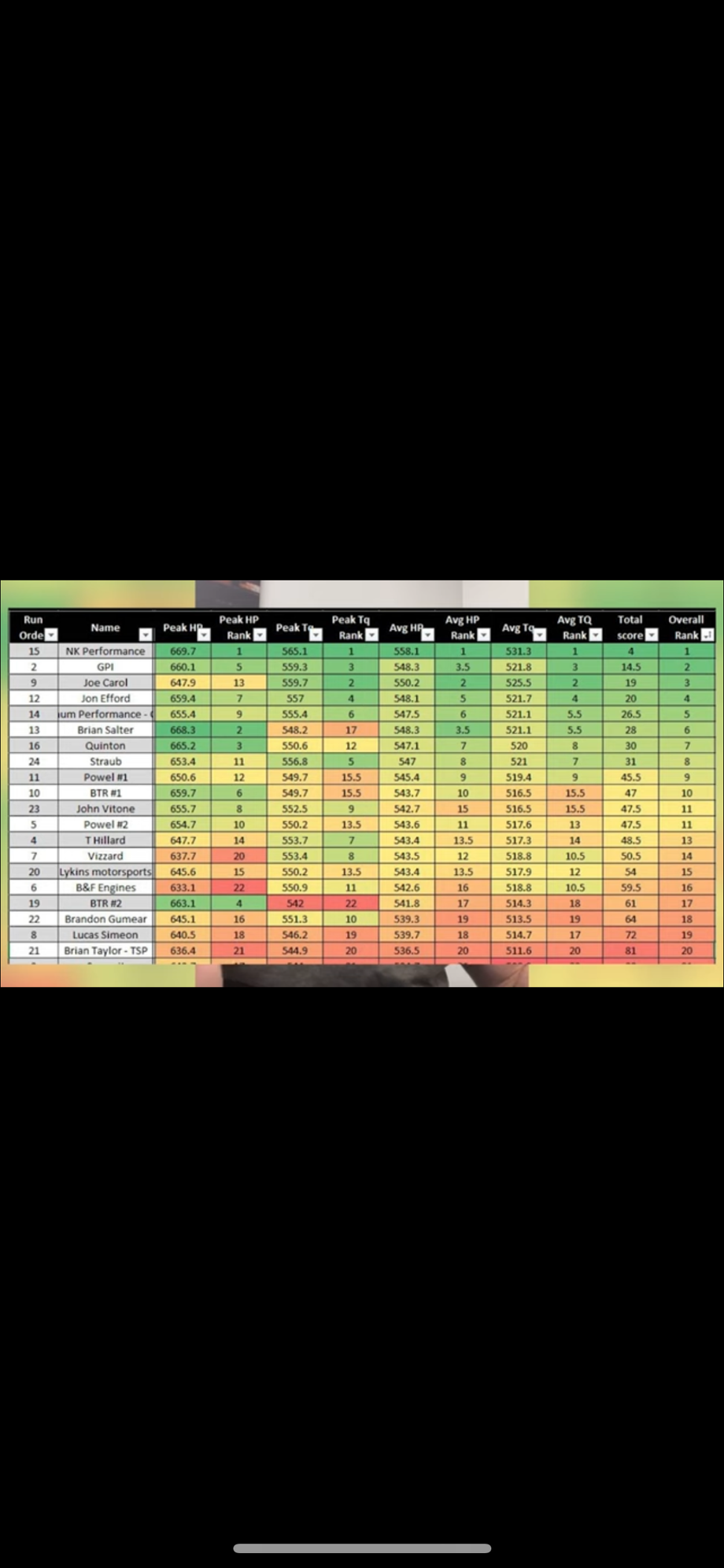

Some really cool guys put together a camshaft challenge. The whole thing is on YouTube weingartner racing. The shop NK performance won the challenge and they even have the winning camshaft for sale on their site. The competition was a few weeks ago some big names in it too Vizard, BTR, Summit even though I'm not surprised they haven't brought it up on here already j/k anyway, I just wanted to start a discussion about cam events since there's so much data to be gleamed from this test I feel like the more I learn the less I know I've been posting on here for years and I hate reading back what I've wrote because it's mostly all wrong. That being said, I'm not surprised that Davids camshaft had the same intake center line and lobe angle as the winning grind he just didn't have enough exhaust duration. Looking forward to hearing what others think about the data

I was really shocked to find this hadn’t been brought up here when I checked in during and after the challenge. Bobby from NK performance and who also works as a designer for Cammotion won the challenge. It was very interesting.
Thanks for bringing it up. There was a huge thread on Speedtalk about it that got locked but, it was still up last time I checked.

They used a restrictive 1 and 3/4-in header made for a car so less than ideal I'd say they were off to a pretty good start, The funny thing is it's like back to square one. If you look at some of the GM grinds the old ASA and then the stage 2 that's a 227 /239 108 LSA. I can't stop looking at that one then there's the stage 3. That's a 233/ 276 107 LSA I think that one's supposed to be for the LS7 The 454 LSX cam that's a 236/246 110 LSA and then of course there's that crazy 239 /251 106 LSA these are all GM spec, Jim thinks the LS l s wants a Tighter LSA

The overlap and the exhaust duration on those charts is all over the place though

Makes you wonder how aggressive the lobes are.
only cam in the top 5 I’d even be interested is the OP Mustang. Anybody know who that is?

That's really impressive for only 12° overlap

There's got to be a point of diminishing returns somewhere I would think given the differences in overlap between the cams, they were all very close power wise for the most part

Taking the winning cam out of the equation, the rest of them have a fairly narrow spread power wise from best to worst. The specs varied widely, did anyone else see the 2 Summit cams in the test, the smaller one 8710R1 made almost as much power as their stage 5 and much less overlap. I think the winning cam had a winner with that crazy exh duration. I think he hit a sweet spot in over scavenging the exh to get an even better intake charge. I think that motor should have made more power overall, but the peripherals on it were box stock, no massaging and I think the induction limited it Note the wide range of intake duration and power result was fairly narrow.
