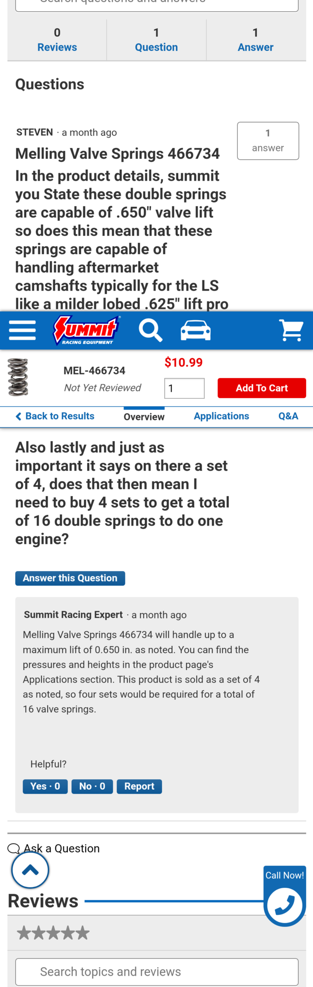

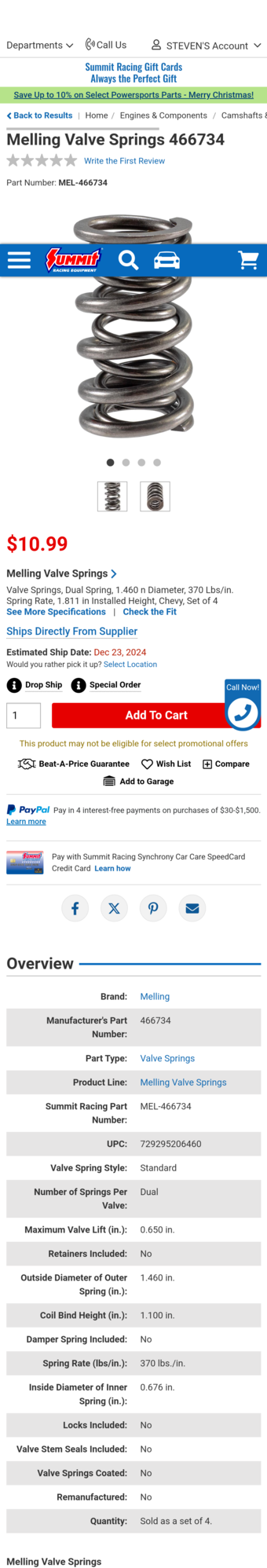

Maybe the new cams will work with these?
Have you guys changed your valve springs in a while?
Summit has these. They should probably fix some typos in the product description about the quantity However I think they look great and I'm going to run them once I have 16 of them and so I finally went with dual springs anyways I'm going to try these made in the UK Mellings lets get it I've also got EBC brakes. They work pretty well if you get them shimmed properly.
I asked that question you seein the products description about the quantity of the valve springs in the box You see in the picture above that question myself because the price looked too good to be true for a set of 4 at 10.99!
I later Summit about the new single plane Camshaft specs because we were already on the phone and I'm sorry to say he didn't have any specifics to disclose yet, So maybe we need to throw some more ideas up on the board here and they will have a better idea of what to do with the cam grinders because I'm certainly still trying to figure it out for myself

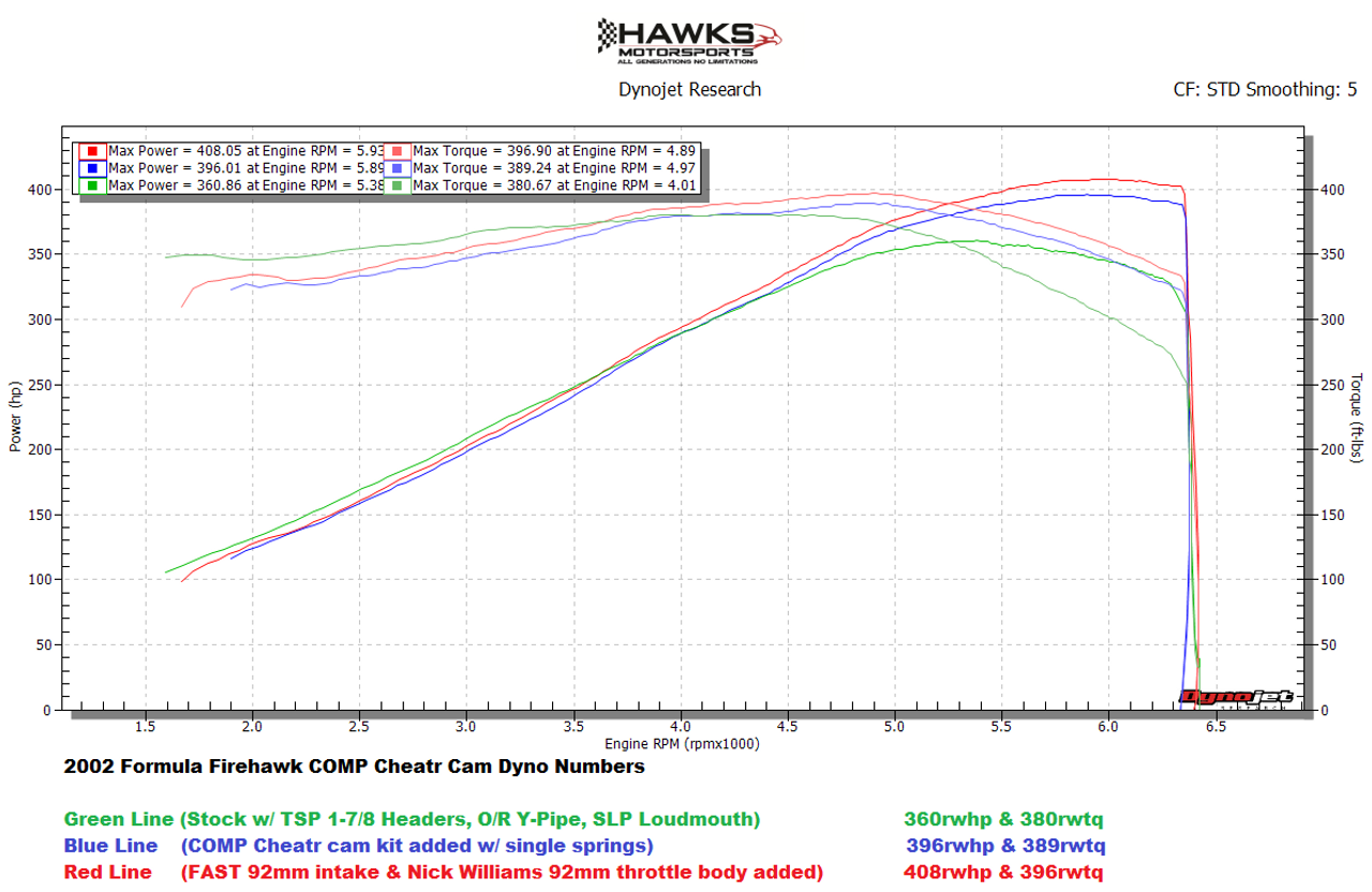

Remember the TR CheatR cam from back in the day?
215/230 .629/ .592 117 LSA
Good LS9 cam.....
