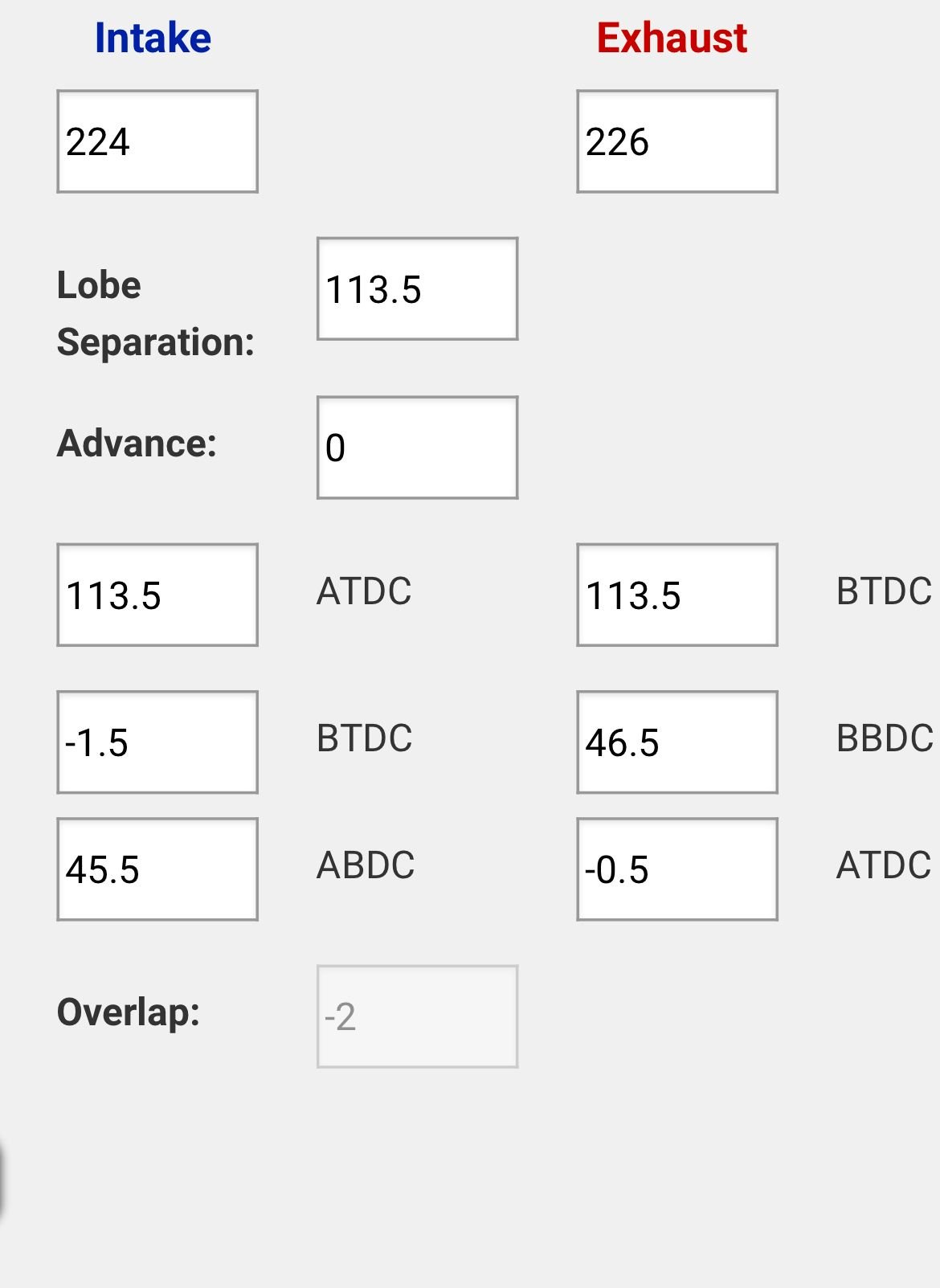

So my 220/224 115... If I re-degree it 115.5 intake centerline I get
-5.5
45.5
46.5
-2.5
Your killing me lol if I took it apart far enough to advance the cam 3.5 or 4° and it stayed strong through 7K. We'd be on to something right?

Forgot to say, I don’t think you need any later IVC. I think you need more duration. And a little lower IVC will help get it and everything m a good place while allowing more duration keeping the EVO in a good place and allowing some initial pulling in the initial charge but not enough to allow reversion pulse to contaminate it.
Totally agree on the lower ivc and more duration

Are you talking about the Callie’s list, because I didn’t see anything appropriate that would be better for your particular setup and goals then what you e already tried?
Honestly with the stock manifolds I’m landing on a 224/230 115+0 as my final answer. Call Cammotion and see what max lift they’d recommend based on the rest of your valvetrain setup and how your planning to race it. I’d want to shoot for at least .595/.595 (preferably more on both if it can handle it).
