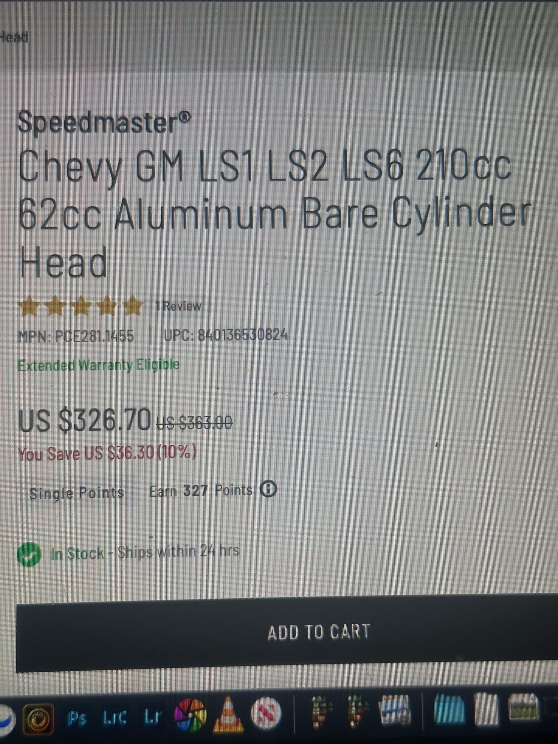

Speed master bare heads ? 215 cc with 60cc chambers 2.050 and 1.6 valves gotta be trash? They are 320 each bare.
i figure for 1600 total I can have some great flowing high compression heads witj my choice of parts.
the other comparable option is 706 heads to the PRC , katech , TEA, ect for larger valves or 799s miller and thin HG (but my cam is 238/242 and I’m not looking to fly cut.
