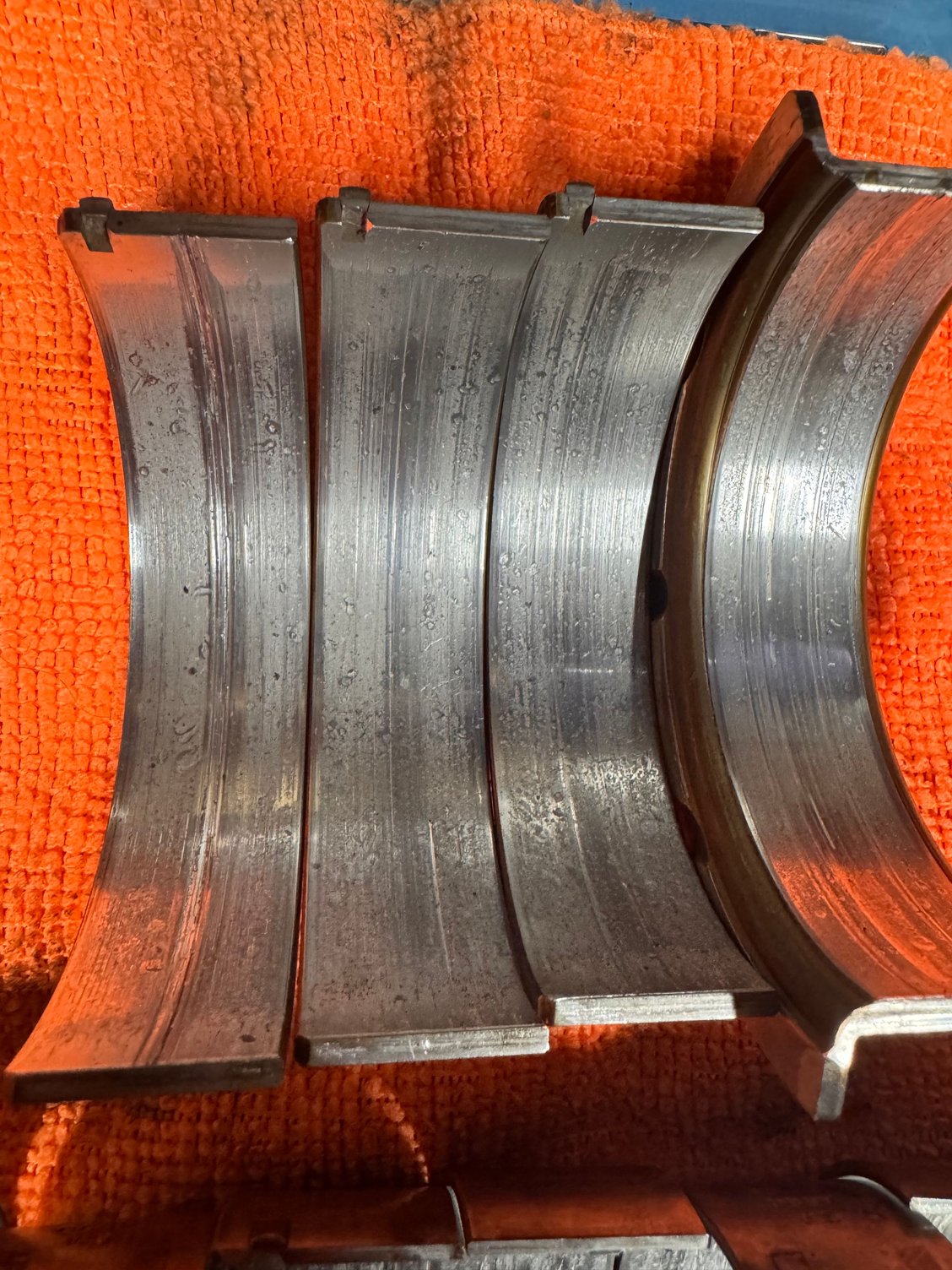

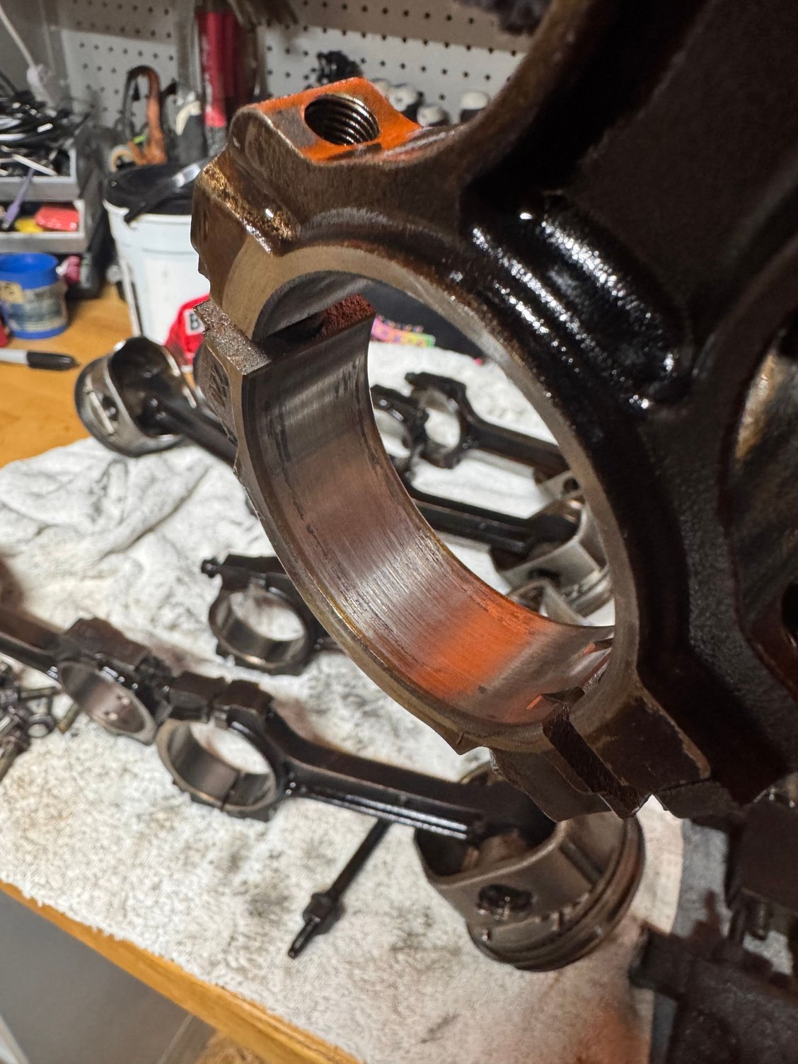

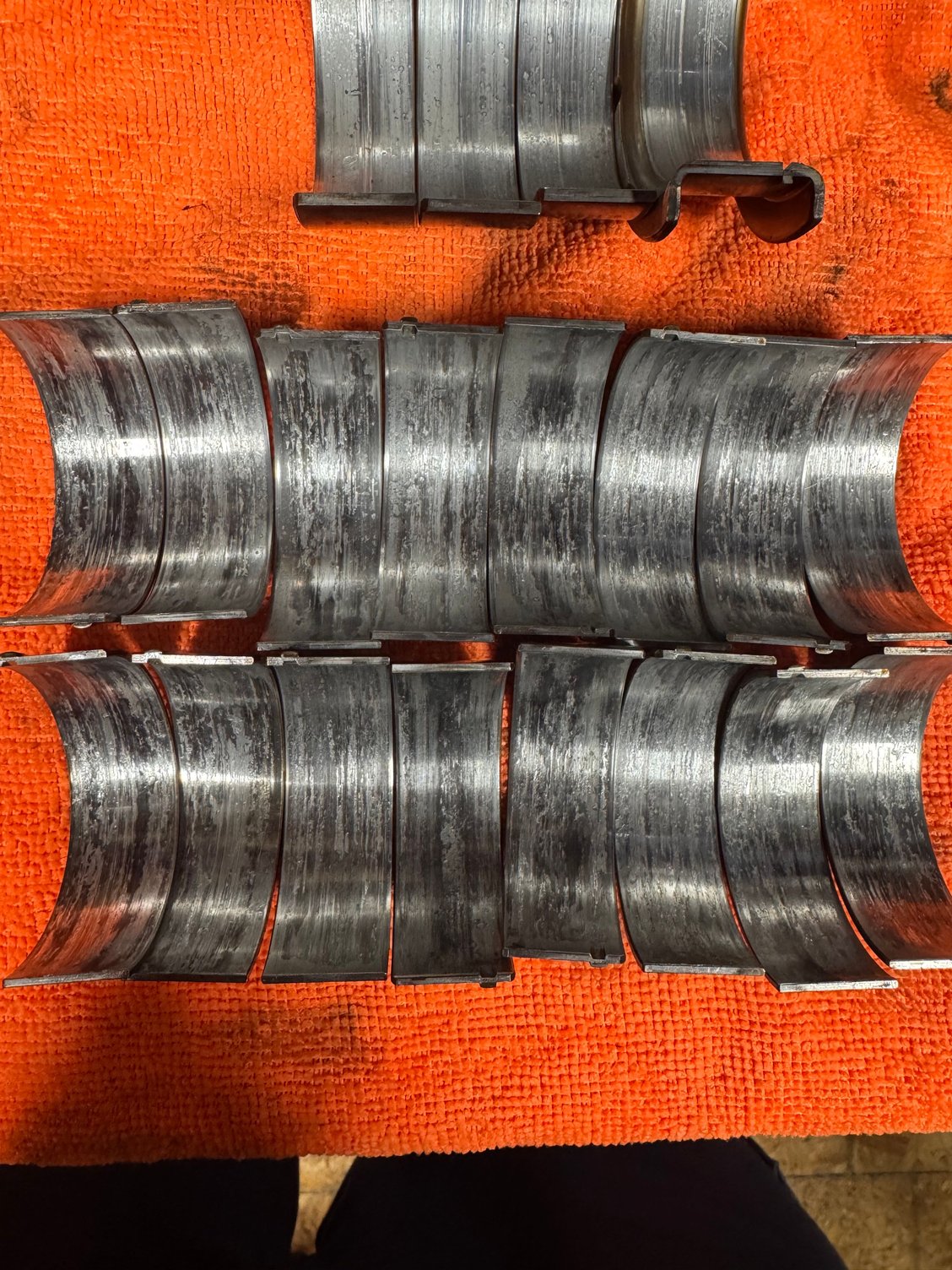

A guy supposedly just rebuilt this engine less than 1,000 miles ago. When I drained the oil, it was very thin and smelled strongly of fuel. At this point I’m going to assume an injector is hung open and it was ran too long and fried all the bearings. I’m guessing I’ll need to throw in a set of new injectors along with a new motor so I don’t end up in the same scenario
Dont guess or assume here. You’ve got my number.

agree with above, dont guess or assume. test, troubleshoot and verify. parts cannons are expensive to fire.
