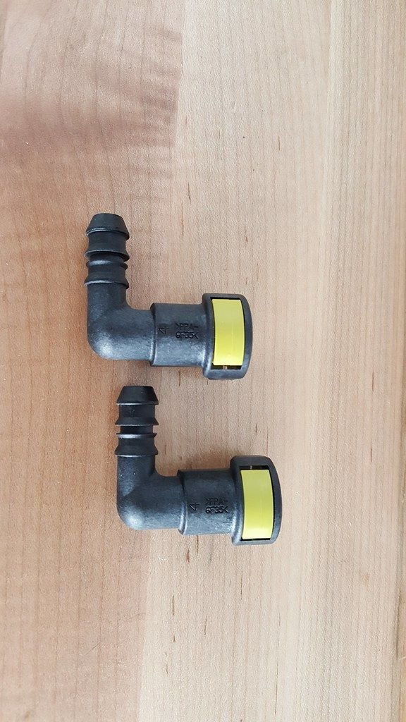

I also ordered these 90* fittings from Edelbrock to clean up the PCV hoses some more - they snap right onto the LS9 covers.

I'm looking for these Edelbrock PCV fittings for the LS9 valve covers. Does anybody have the part number? I can't find them in their online catalogs.
Old Oct 29, 2019 | 04:10 PM
Double06's Avatar
Joined: Apr 2012
Posts: 765
Likes: 284
From: Potomac, MD
I think Mighty Mouse catch can company cans sells the 90 degree fittings. They have all sizes up to I think 5/8 tube. The valve covers are typically 3/8 tube.
Old Oct 29, 2019 | 04:19 PM
KENS80V's Avatar
iTrader: (16)
Joined: Jul 2008
Posts: 144
From: Oakbank, Manitoba
Thanks for the tip. I'll contact them. I measured the tube and it's actually 10mm which is slightly larger than 3/8"
